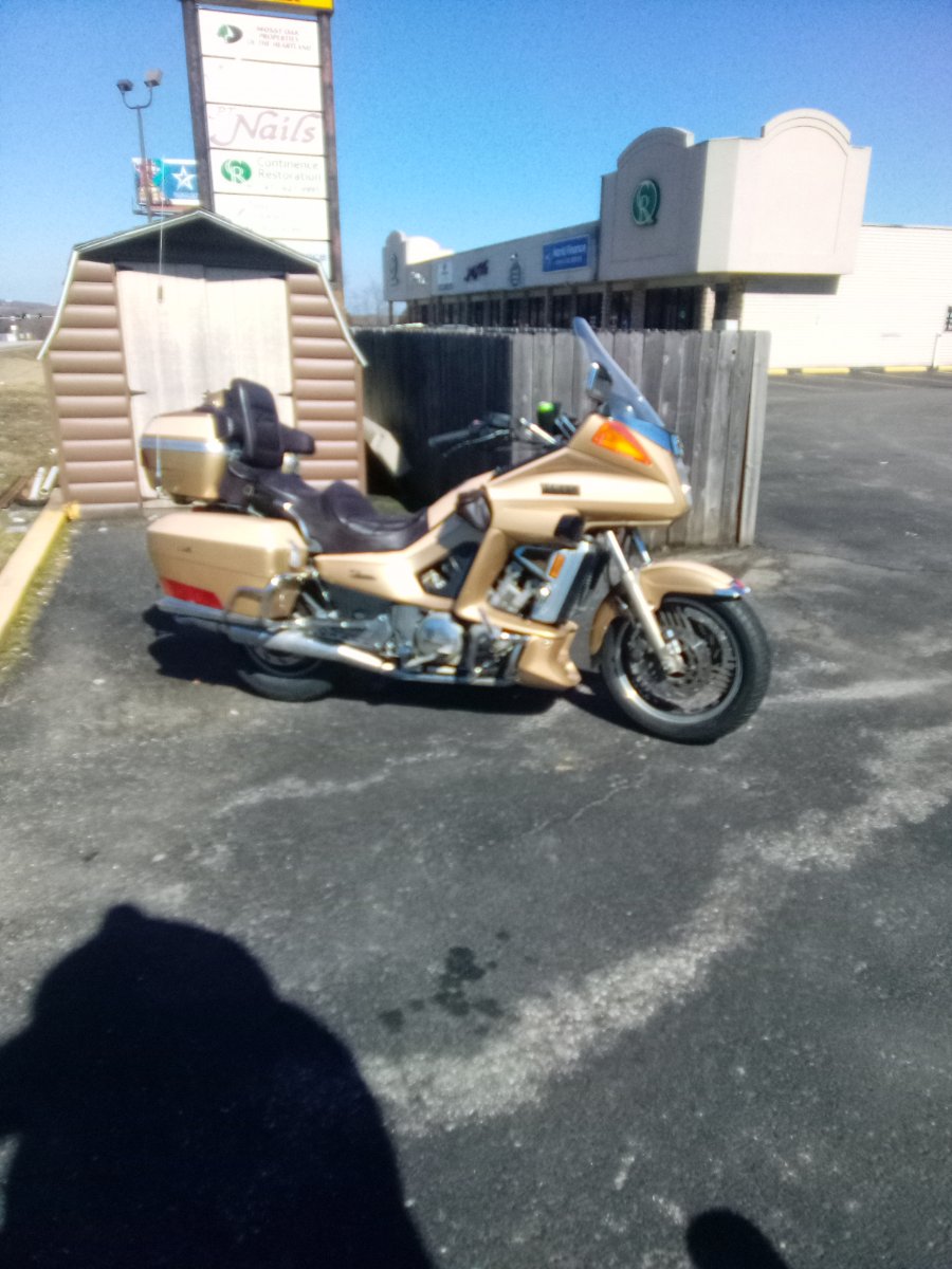

First look at my new xvz13dt/dtc
Bought it yesterday 3/6/21. Rode it home in the freezing rain 🌧️. PO didn't much about bikes. Just rode it around town.
What I know so far is.
It runs and rides good. In the freezing rain 🌧️. Lol
No tail lights . Changed bulbs. Put a flashlight in it. To get it home.
Got brake lights work.
No dash lights. Computer, everything else works .
Suspension adjustment not coming on . Or CB. No power to that side.
Getting a test light now.
39k miles garage keeper by both PO.
