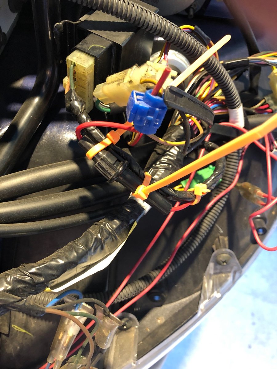

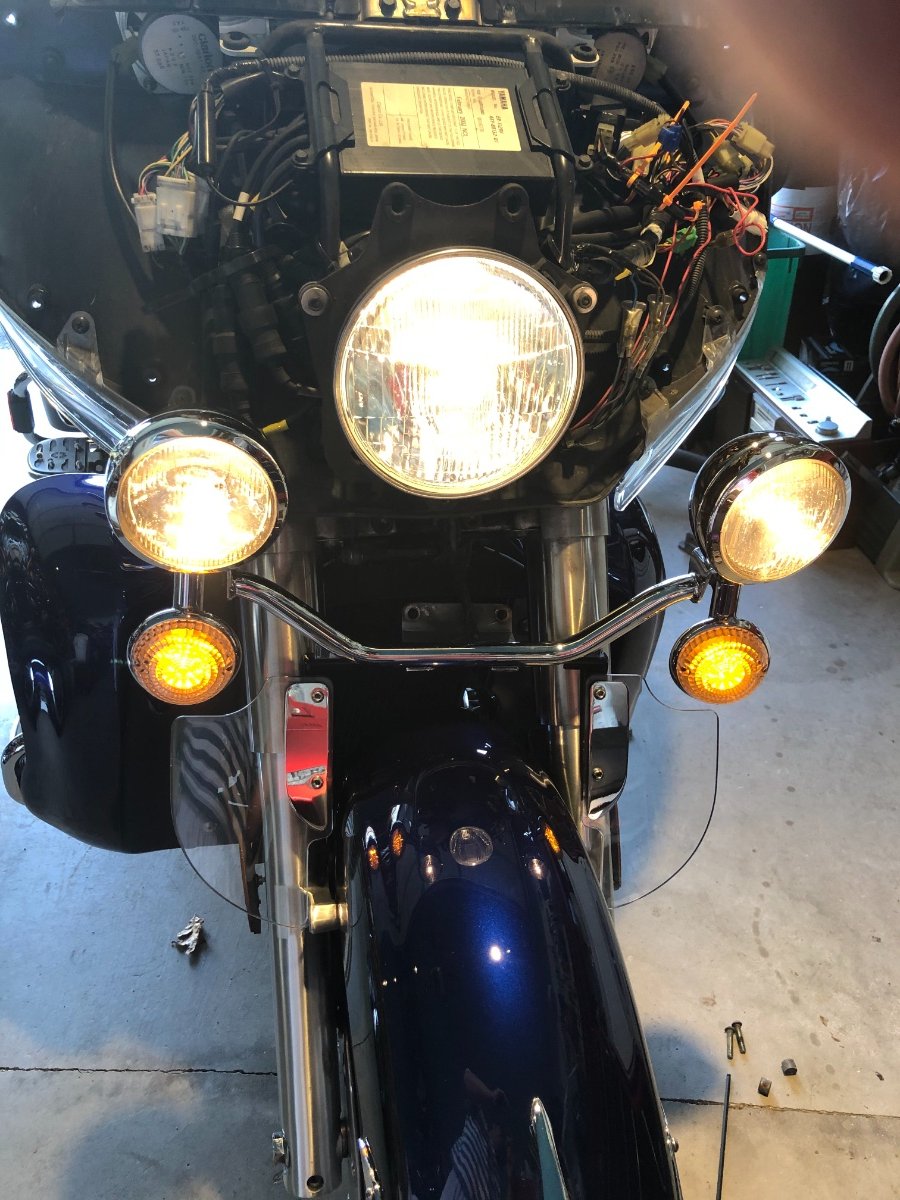

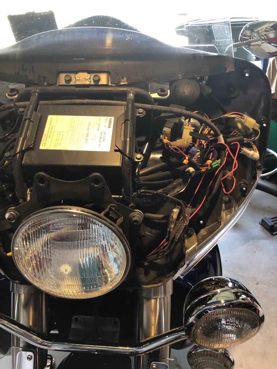

N3FOL 157 Posted Tuesday at 12:49 AM Share #16 Posted Tuesday at 12:49 AM So yesterday, I was so happy to finally ride my ‘07 to work. First time this year after just riding my SVTC due to cold cold temps in the morning. Anyway... I noticed my passing lamps were not working and I had to do something. I really thought it was the fuse, but it turned out to be just a loose contact somewhere between the switch and the fuse holder. I tried my best to secure it with a couple of zip ties and that did the trick. My ride today to work had my passing lamps lit all the way. Link to post Share on other sites
djh3 945 Posted Wednesday at 02:15 AM Share #17 Posted Wednesday at 02:15 AM I EEEEEE Get ride of those guillotine scotch lock POS. Either make a proper connection or use posi-taps. Also watch for pinched wires up under there. The travel lock for forks like to catch them and pinch wires and short. 1 Link to post Share on other sites
saddlebum 1,644 Posted Wednesday at 04:25 AM Share #18 Posted Wednesday at 04:25 AM 2 hours ago, djh3 said: I EEEEEE Get ride of those guillotine scotch lock POS. Either make a proper connection or use posi-taps. Also watch for pinched wires up under there. The travel lock for forks like to catch them and pinch wires and short. I am pretty sure the fine print say's to be used by U-HAUL operators only ...... Link to post Share on other sites
N3FOL 157 Posted Wednesday at 10:40 PM Share #19 Posted Wednesday at 10:40 PM 20 hours ago, djh3 said: Also watch for pinched wires up under there. The travel lock for forks like to catch them and pinch wires and short. All good so far on pinched wires in the long run. Link to post Share on other sites
