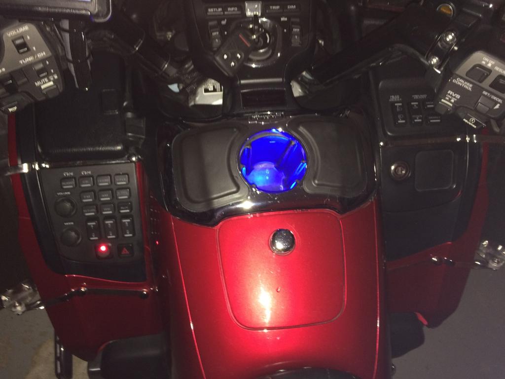

  11. Me too, I bought the longest flat blade screwdriver that Craftsman sells, just wish it had a light at the end of it, cause it is dark in there sometimes. If I still had my Venture, I would fit a flat LED to the drivers shaft, something like this, https://www.oznium.com/12v-motorcycle-led-light-bulbs. I put one of those in my cup holder and they give out a lot of light, see.
