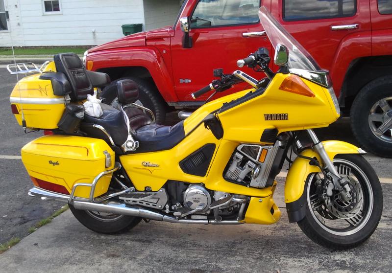

The air dam was sold by Yamaha with the intent to install onto 1983-1985 Ventures, but some folk have adapted it to the MKII. I believe it requires a change of engine guards to the MKI or removal of the mounting tab on the MKII guards where the lower cowling would mount. Here is a pic of a 1989 with the chrome air dam installed. [ATTACH=CONFIG]95306[/ATTACH]
