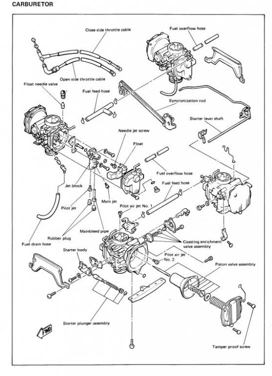

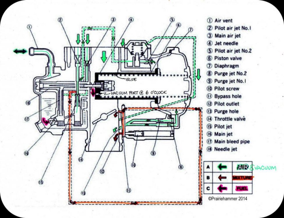

The "little diaphragms" on the Venture carbs have nothing to do with the choke/enrichener. The little diaphragms are part of the deceleration enriching circuit. Two different animals.

Concerning the "choke" on the 1984: the choke lever on the 1984 is unique to that year Venture. It is "coaxial" with the handlebar, as opposed to the "under slung" choke of the 1983, 1985-1993. I guess it was an attempt to "improve" the enrichener operation, but apparently it was deemed a failure, because Yamaha went back to the under mounted (under the switch housing) enrichener after just one year (1984). Some folks who have complained of the "loose" enrichener lever on the 1984 have wrapped some friction tape (as a string) around the hand grip, between the hand grip and the choke lever, to tighten up the choke action. Concerning the difficulty in starting; it sounds as if ALL the enricheners are not being opened during the "choking" start. And the poor fuel mileage COULD be a result of one or more of the enricheners remaining open. Check the enrichener linkage to insure fully open on all four when choke is desired AND check that all four enrichener plungers are FULLY retracted closed when the "choke" is off.

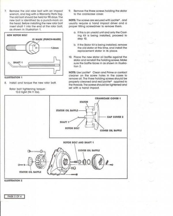

You are correct on most counts, but incorrect on the biggest one, the second gear repair. The punch mark on the crankcase is NOT an indication of a corrected second gear. It is an indication of the stator cooling kit installation. See the relevant Tech Bulletin in its entirety below. -
