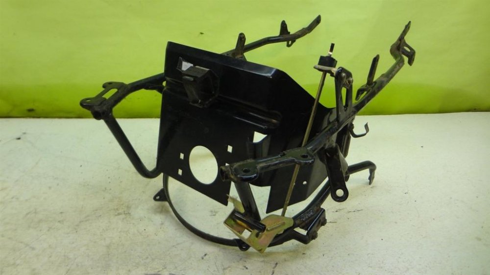

Gary, You will need to replace the left fairing stay to accommodate the MKII headlight adjuster. The headlight adjuster mechanism on the MKI will not work on the MKII headlight assembly. There is an additional mount (a tube) on the fairing stay for the MKII adjuster. See pics below. You may not have to replace the right fairing stay to mount the MKII headlight, but I wonder if the MKI headlight mounting tab will interfere with the MKII headlight assembly. Perhaps just cut off the mounting tab if it interferes with the new headlight. According to Randy, the tab is not a problem? The fairing connector (under the headlight; joins the halves of the fairing) must be changed to accommodate the MKII headlight. The upper or middle fairing stay must be changed to use the MKII headlight. Your 1984 fairing halves will bolt back onto the MKII fairing stays. But of course, the fairings must be removed first to replace the stays. -

The fairing stays (right, left and center) are unique to the 1983 and 1984. The 1983-1985 headlight assembly is bolted to the right and left fairing stays. On the 1986 and newer the headlight assembly does not bolt to the fairing stays, but instead sits in grommets on the fairing connector and under the windshield mounting tabs. I believe you will need to replace the fairing stays to mount a 1986+ headlight assembly. You might consider installing dual projector headlight into your 1984. Couple of guys have done it ( @Snaggletooth and Twigg). Here is Twigg's write-up about the project: http://www.venturerider.org/forum/showthread.php?67750-Headlight-Conversion-to-HID-Projector-%28-86-93%29 -

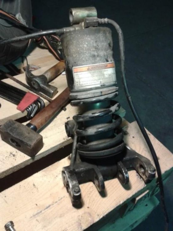

The Venture rear shock linkage was changed on the 1988 model. What you have on the 1989 is factory for years 1988-1993. The "one small bolt" screws into internal threads on the pin that goes through the lower shock eye. The pin is then driven out to the left. Be warned though, that the steel pin is often frozen in the aluminum linkage arm. Also be aware that striking the right side end of the pin may cause damage to the end of the pin, due to the internal threads. Use a well fitted punch to avoid mushrooming the pin. Consider using the small bolt, mostly screwed in, to strike upon. Heat (from a torch) applied to the aluminum linkage arm may be required. It may also be necessary to remove the entire assembly from the bike and work with a bench vise. -
