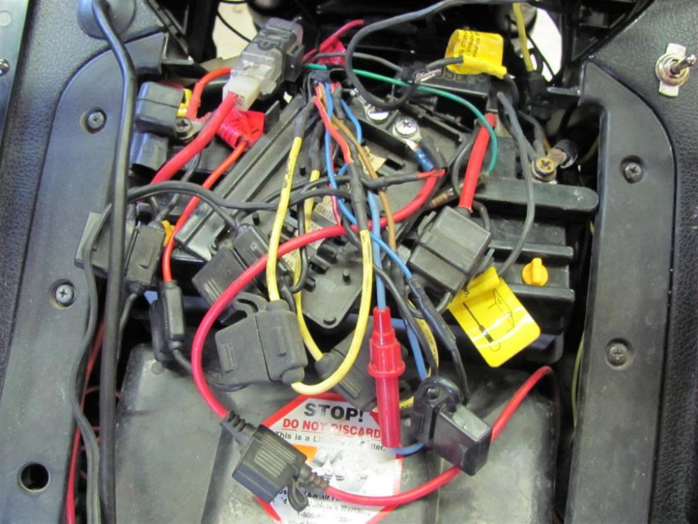

Go here for my write up about changing my fuseblock on my 1990: http://www.venturerider.org/forum/showthread.php?66650-Upgraded-and-updated-Fuse-block%28s%29&highlight=fuse+block And here is the before picture of my 1991 fuse situation: And here is the after: The CLASS fuse is in the rubber inline fuse holder. -

The "SIGNAL" fuse (Brown wire in, Brown wire out). In your picture, I don't see any wire coming out of one end of the upper (in pic) yellow fuse holder? -

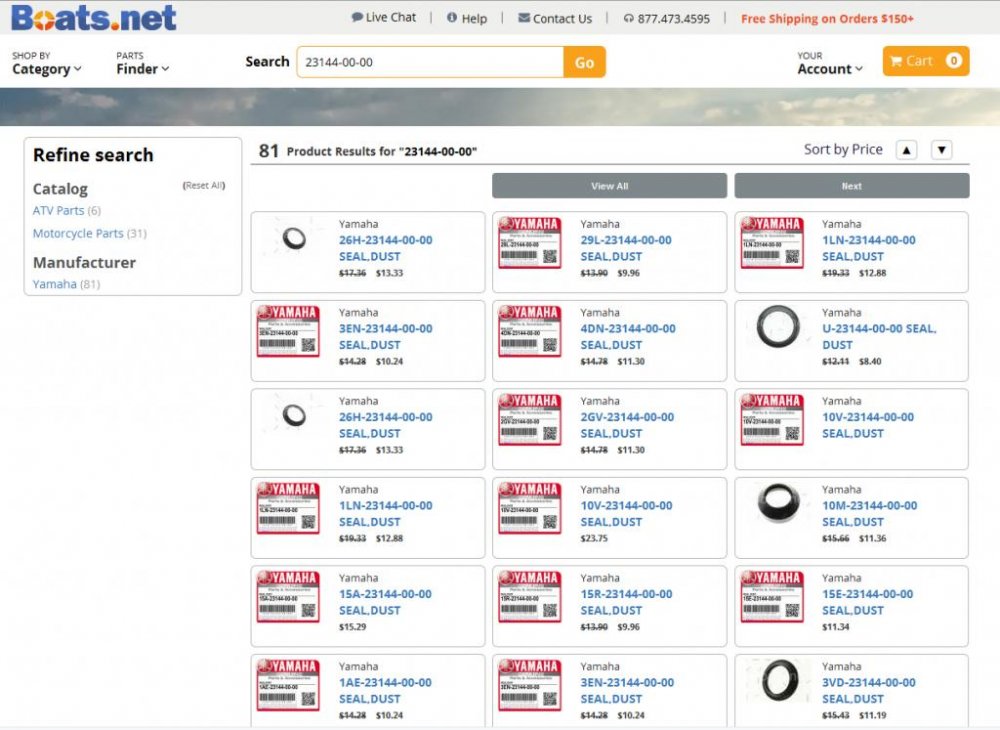

Here is an example of what ***-23144-00-00 fits: As you can see it is the 3 character prefix that matters.
Actually you have the part numbers and description reversed; 26H-23144 is for the DUST seals and 26H-23145 is for the OIL seals. http://www.boats.net/parts/detail/yamaha/outboard/Y-26H-23144-00-00.html http://www.boats.net/parts/detail/yamaha/outboard/Y-26H-23145-00-00.html No, it won't fit just because the 23144 is the same. In fact, the 3 character prefix is the key to what bike it will fit. "23144" is a constant Yamaha number for fork seals for many models, it is the 26H or the 1NL or the 41V or the 59J that differentiates models. And by the way most VMax parts start with 1FK, though there are many 26H parts on a VMax and some 1FK parts on a Venture.

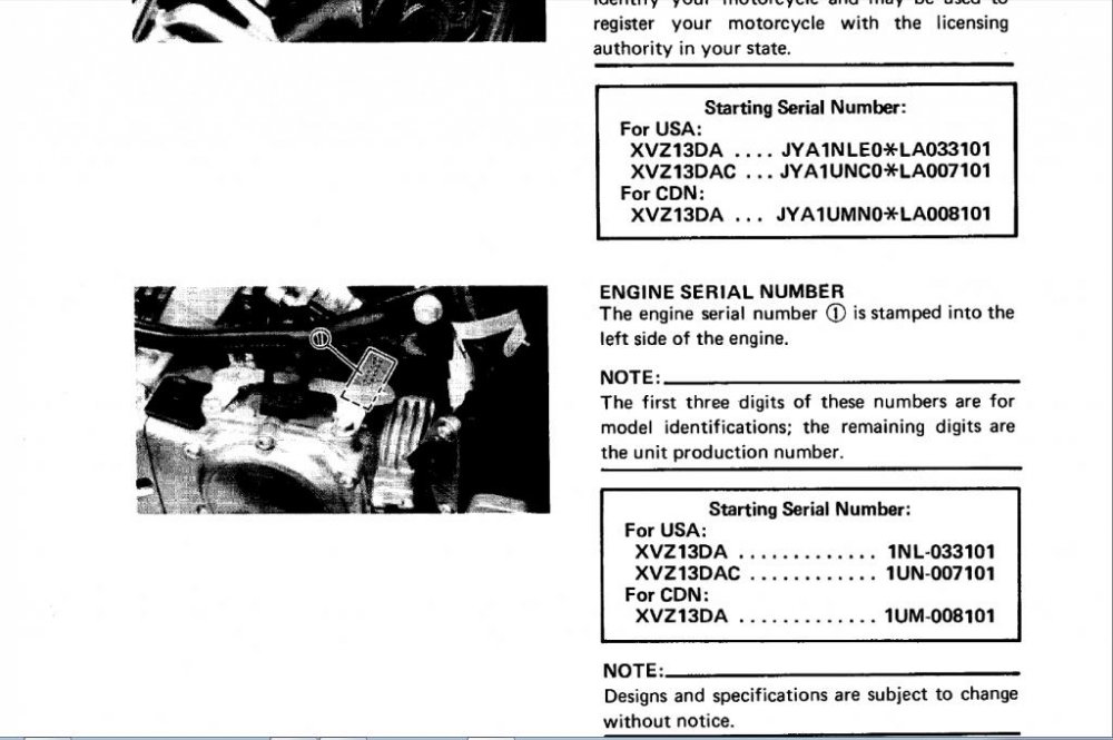

The easiest and surest way to determine a 1200 from a 1300 engine is by looking at the engine number. BTW, care to submit your VIN? And build date? -
