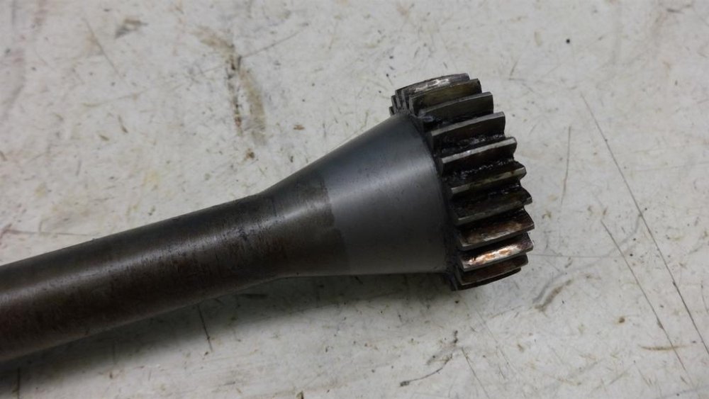

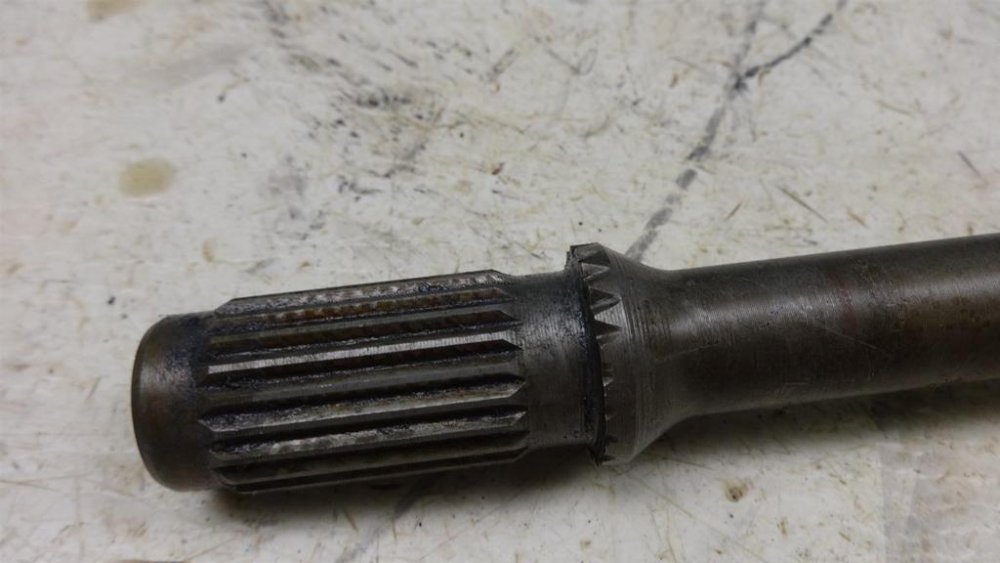

Actually, I think that driveshaft is worn substantially. Granted the teeth are not galled, but note how sharp the teeth are. Unworn teeth will be very blunt, with a prominent flat at the tip of the teeth. Here's a good one for $9 plus shipping. http://www.ebay.com/itm/83-Yamaha-XVZ-1200-XVZ1200-Venture-drive-shaft-driveshaft-/311596597077?hash=item488c9abf55:g:0J4AAOSwYmZXF~84&vxp=mtr -

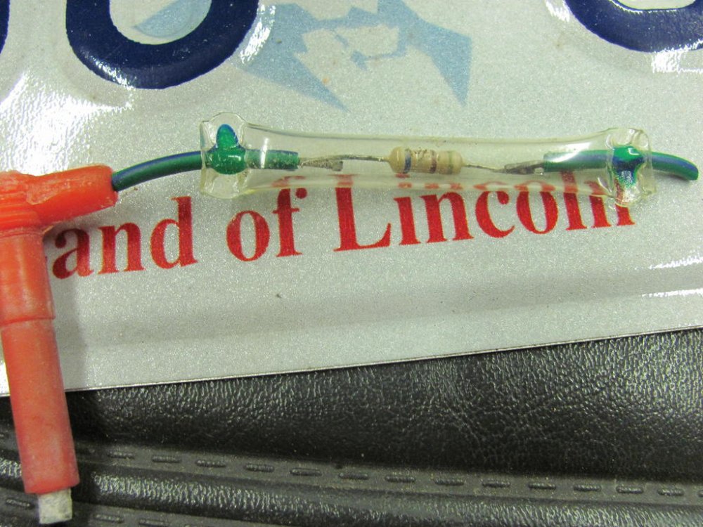

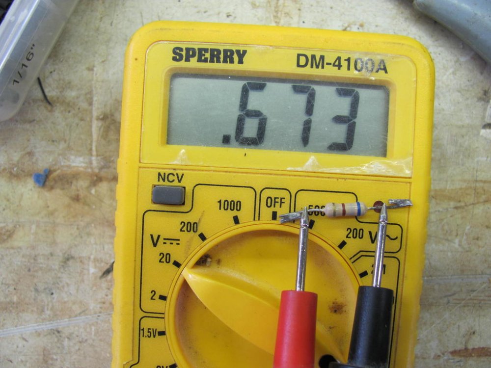

The stock wiring for the battery electrolyte sensor circuit included a resistor. The resistor value was quite low, too low to allow a direct connection to 12 volts. There is no danger in adding the 2-4K resistor in series with the existing stock resistor. -

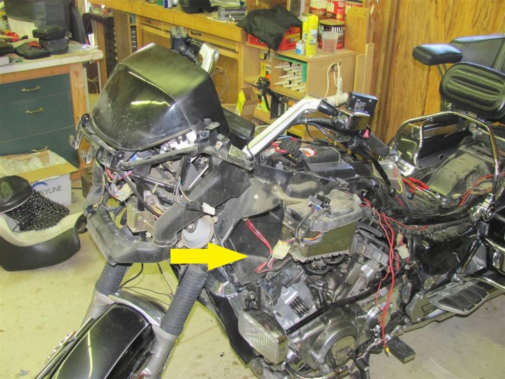

Unfortunately, no matter which of the throttle cables have broken, you will have to remove the left main fairing and the left inner fairing to access the "five into one" junction box. To change ANY of the five cables that junction will have to be accessed and disassembled. My finger is on the junction. The junction is located at the yellow arrow in this pic, behind the inner fairing panel. -
