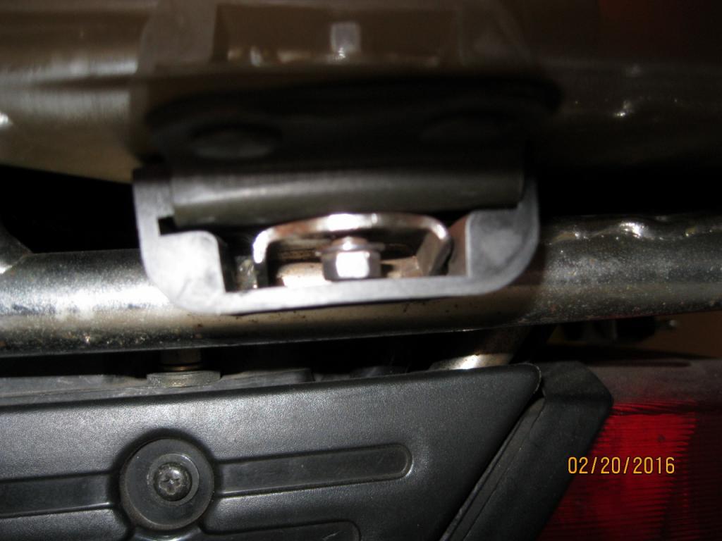

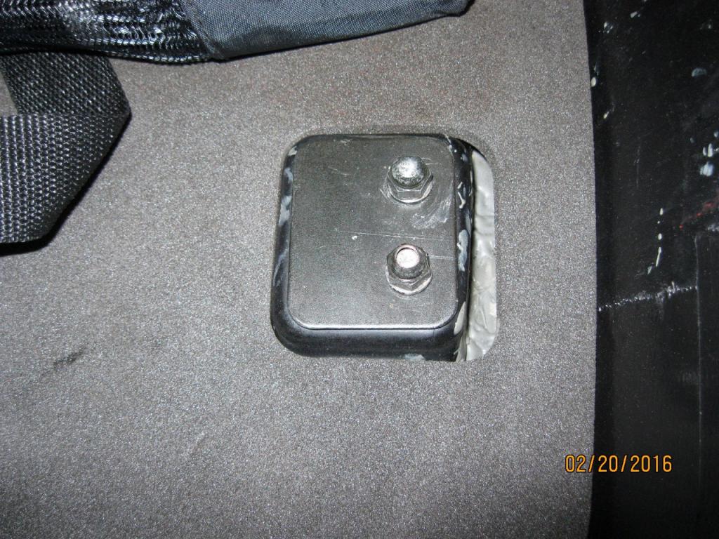

From what I recall, there are 6 nuts inside the trunk, three on each side. The picture shows three inside. Then, underneath there is one nut on each side with a rubber cover over it that just pulls off. I would remove the seat because there are some wires under it that are attached to the trunk for the passenger remote and the interior light. There is also a cable to the backrest to which you would have to remove also. That is all I can recall. -

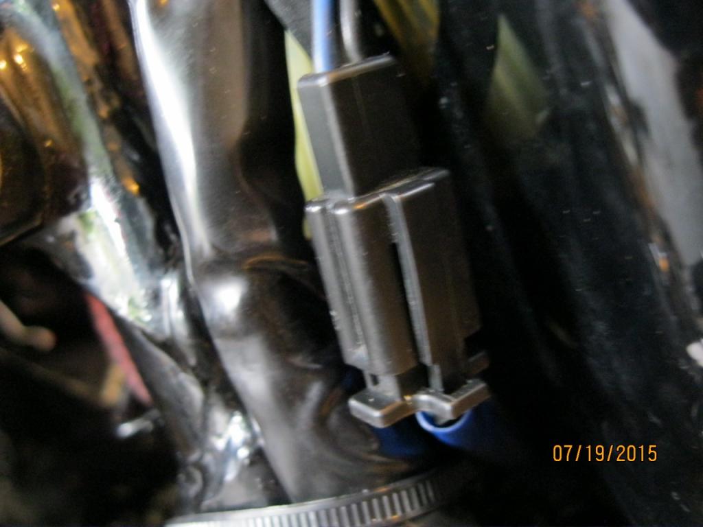

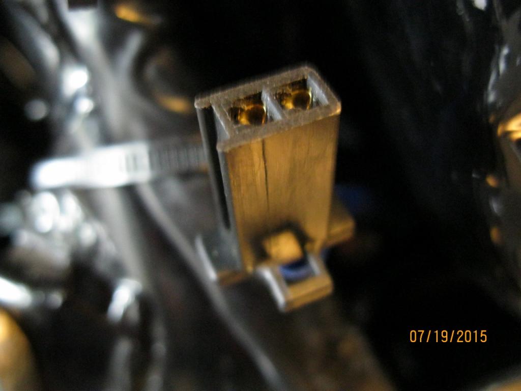

It has two wires with bullet connectors. -
I bought another fuel pump because mine was starting to fail but since I cleaned the points it's been working perfectly. Even so, I would like to carry a spare with me that I can plug in if needed. I would like to know if the original wire connector is available to purchase so I can plug in the new pump. I'd prefer not to replace all the connectors if I don't have to. I need the piece in the 2nd picture. Any help is appreciated.

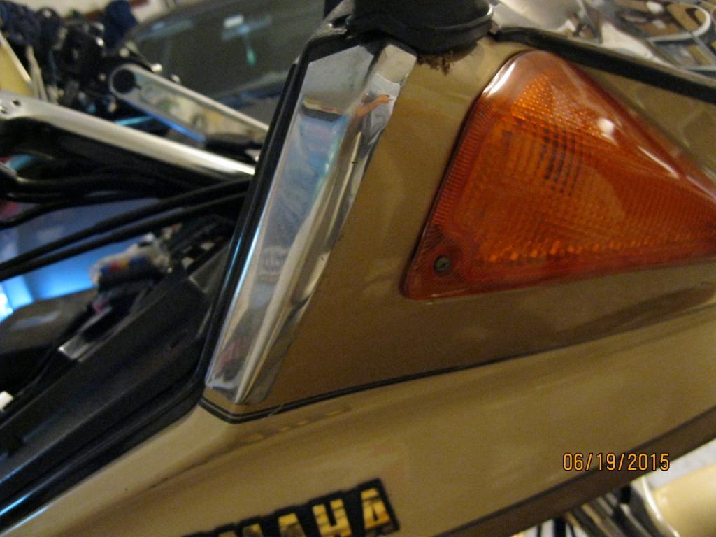

About a year ago, the fairing edge trim on the right side fell off but I was able to find it and replace it. It's only held on with double sided tape. Unfortunately, I didn't replace the tape on the left side so, when that one fell off, I wasn't lucky and it's gone. So, if you have these on your bike, consider replacing the tape. And, if anyone has a left side trim, or a set, you are willing to sell, I'm interested. Here's a picture of what I'm talking about.
