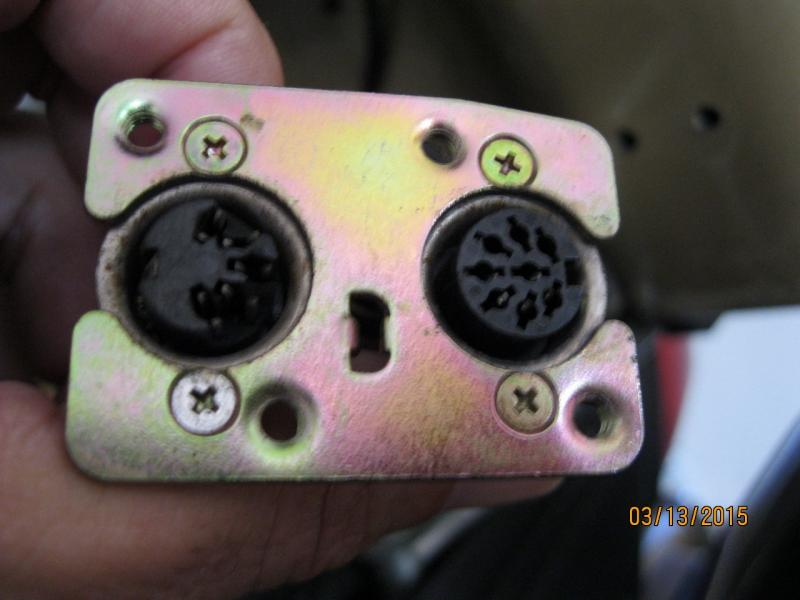

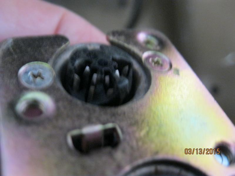

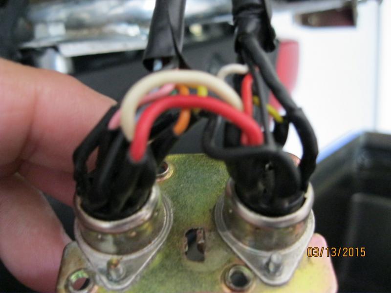

Dion, thank you for the offer. I ordered a used replacement so hopefully it will solve my problem. If not, I'll contact you about your offer. The controller is good. -
Passenger Headset/RC Wires
Donvito replied to Donvito's topic in Venture and Venture Royale Tech Talk ('83 - '93)
Thanks for the suggestion. I was able to buy one from Pinwall for less than $30. Hopefully, it works. -
The jack for the passenger headset is busted up. I thought I could just use the connection under the seat but there are some wires connecting the headset and RC jacks so I would like to replace both jacks and the wires. I am attaching pictures of what I need so if anyone has one to sell I am interested. There is one for sale on ebay but it seems to have an extra connection that I don't have. Thanks.
