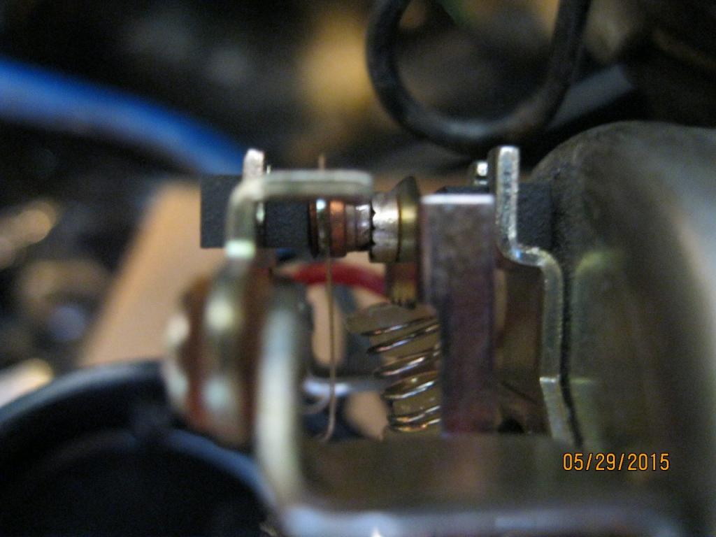

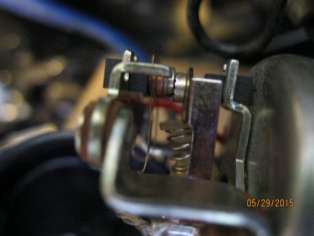

To try to resolve an intermittent pump problem, I took some advice and cleaned the points. The points looked to be in good condition so I lightly sanded the surfaces and sprayed with contact cleaner. Then, with the cover off, I used the pump to pump gas into a container while I observed. I worked correctly for most of the tests but, when it didn't, it seemed like the points remained in contact with each other and the pump would cease operation. I am attaching pictures and a video. The video was taken while the pump was pumping into a gas container and turning the key on until it timed out and doing it again. I did this many more times but didn't film it all but couldn't catch it not operating. The way I believe they are supposed to work is one point is attached to a fixture that moves and engages the other point when the chamber has been pumped out which energizes a coil and pulls a plunger filling the chamber with fuel. On the return stroke, a spring pushes fuel from the chamber to the carbs. Once the chamber is empty, the points engage and the process repeats. On my pump, when the points do not disengage, the voltage drops and nothing happens. Until, after some period of time or other event, it will resume operating and work fine for some period of time until the next event. Should I do anything else to try to adjust the points or is it another part of the pump causing this to happen? I am attaching some pictures. Here's a video of when it was operating properly I think:

Thanks for all the great advice. I will open the pump and clean the points to see if that solves the problem. If not, I'll be looking for a new pump. Thanks again. -
I have been dealing with an intermittent fuel pump problem for the past year. I thought I had it fixed several times but it continues to appear. The problem happened four times on a 1,500 mile trip last week, twice at start up and twice while riding at about 75 mph on an interstate resulting in a stall. Since I thought the problem was located in the ignition circuit, I had a jumper wire ready to attach to my terminal block which worked initially but even that wound up failing. When it wouldn't start one morning when the gas tank was low, I had to pour a couple of gallons of gas in and the pump began working again. It seems like the level in the tank has an effect on the fuel pump and it is more likely to fail when the level is low. When I got home, I tested the pump by pumping into a gas can. The tank had about two gallons in it. I ran the pump it through the relay, through the ignition system but bypassing the relay and directly from the battery and the pump failed in all scenarios. So, I thought the problem may be a restricted fuel supply to the pump so I drained the tank, cleaned the petcock and replaced the fuel filter. After doing this, I ran it through a bunch of tests and the pump didn't fail. While working on the tank, I tried to operate the pump with the petcock closed and this resulted in the same condition as when the pump fails. This condition is a drop in voltage to about 10 volts and the relay buzzes and vibrates. This is the same problem for the last year but I think I have it narrowed down to a bad pump or a restricted fuel supply. So, has anyone experienced pump failure from restricted fuel supply resulting from a dirty fuel filter or dirty petcock screens? What should the pump do if it is operated with the petcock closed? Should the voltage drop? I have read about similar failures in 2nd Gen. bike's fuel pumps but not very common in 1st Gen. Is there a way to test the fuel pump or should I rebuild it or replace it? Pumps for 1st Gen. are pretty scarce so will a pump for a 2nd Gen work? I have searched many times for answers but I apologize if I missed one. Thanks for your help.

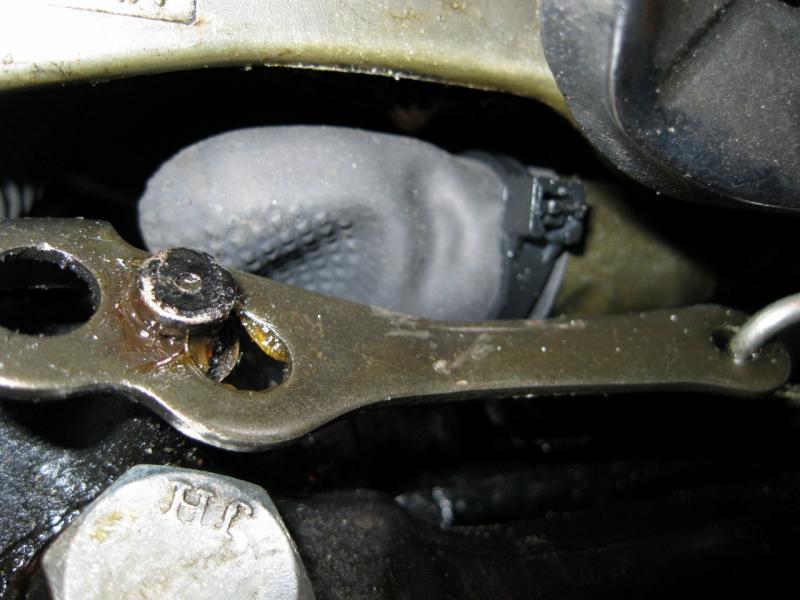

The rubber cover on my sidestand switch was in bad shape so I decided to replace it cheaply. Bought some Neoprene gloves at Home Depot for about $5 and cut off a finger to fit over the plunger and a portion of the switch. Secured it with a cable tie. Now I have 9 more covers when this one rips. I bought size large gloves but size medium would probably work better. Here's some pictures:

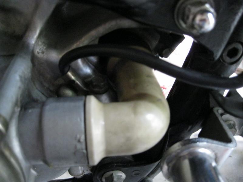

Bought new cables from Dingy and in the process of installing them. Would like to relocate the main ground due to the difficulty of getting the wire into that space and my fear of breaking that bolt and the problem of removing it. Has anyone moved it and to where? I am attaching a picture of the original ground wire.
