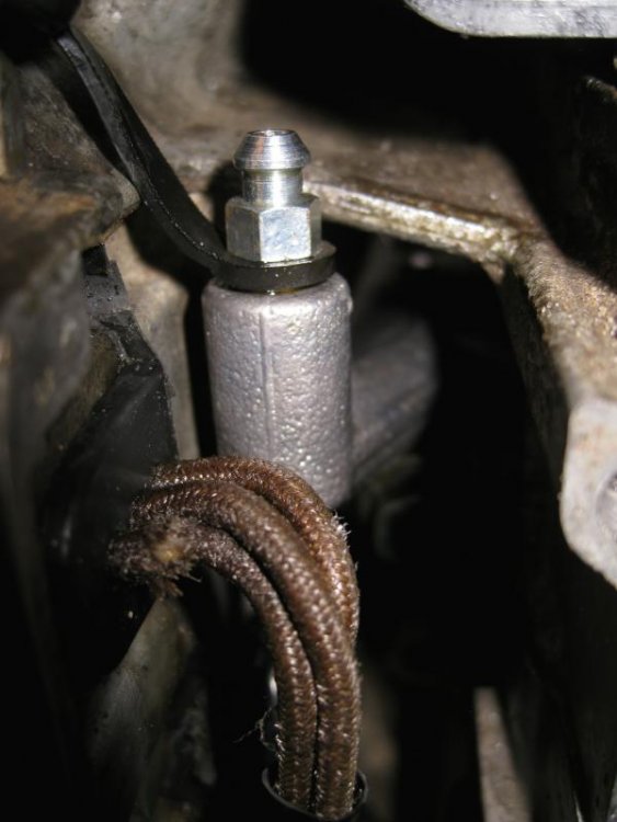

Here's some views of the clutch slave cylinder. It's located behind the left rear engine cover. You'll need a 5mm hex wrench or socket to get the two bolts out, they're not easy to see. Break the banjo bolt loose first, 12mm socket. Then scrunch up your toes and hold your mouth just right and it will finally come out. Trust me. I replaced the seals initially but it continued to seep brake fluid so just got a new one. Good now. As for brakes, they were the reason mine was sitting for five or more years. They'd locked up on the PO so he parked it under a leaky shed. I had to ebay all three wheel cylinders, both handlebar master cylinders and the rear master cylinder. The rear broke in half from aluminum rust when I tried to take the servicing bolt out, how's that for too far gone? Got it all off ebay for not too much money. Yours may not be that bad off but mine sure were. Probably shouldn't have put this much money into something in such bad shape. Keeps me out of the bars and hostels, though.
