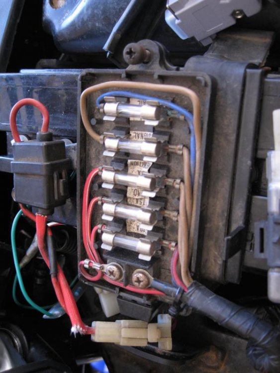

1st gen main fuse information
flyday58 replied to dingy's topic in Venture and Venture Royale Tech Talk ('83 - '93)
When I upgraded my battery cables Gary included the same fuse as in his photos. I like it, made for a clean installation, looks good. I had two of the old-style fuses, but only one had the spares. I found them the same way Jeff did. -
