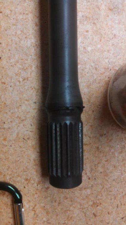

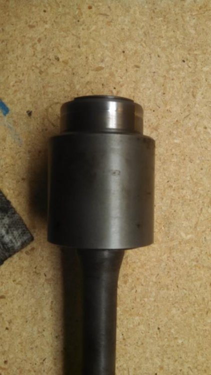

Well...couldn't stand the suspense: Took the rear end off. No sign of damage on the pinion side or the ujoint side (at least as far as I can see. The drive shaft turns the rear end quietly and smoothly. Pictures attached. Couldn't find a way to get in there to get the rubber boot pulled back enough to see if the intermediate gear/shaft/nut is broken or not. But from the picture I took down the drive shaft tunnel, sure can't see any evidence of a nut with a shaft end attached sitting in the middle of the ujoint! Seal looks good, splines look good. I'm going to stop now and get ready for working weekend in Payson(putting new deck boards in, etc.) In order: Seals and pinion nut, rear end drive, rear end side of drive shaft, ujoint side of drive shaft, peaking down the tunnel at ujoint. -
