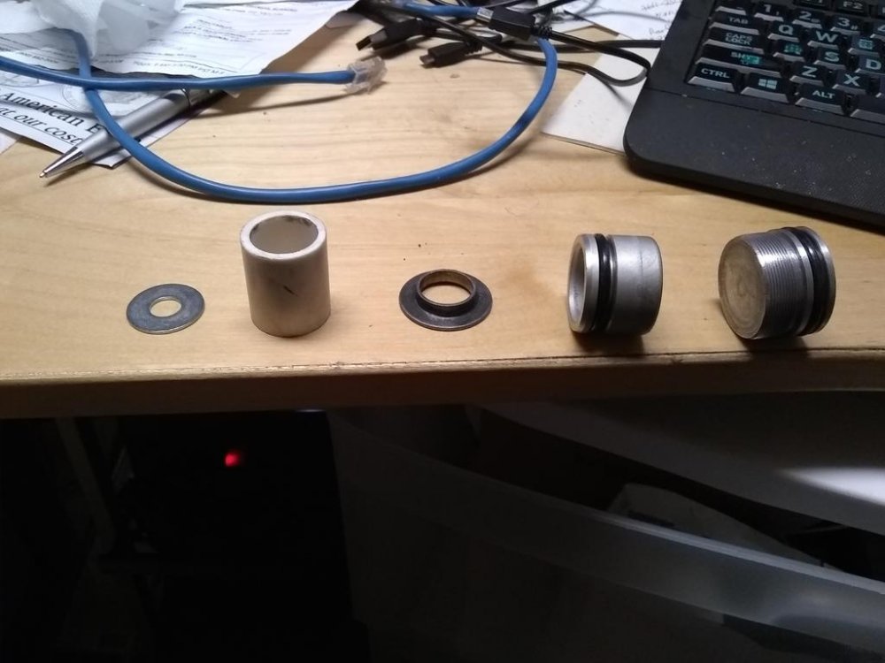

Use and order of Installation
dna9656 replied to dna9656's topic in Venture and Venture Royale Tech Talk ('83 - '93)
So I put all but a little of a 16 OZ. bottle of oil in one tube (the book calls for 13.8) so there is more than the prescribed 13.8 OZ. I cycled (no pun intended) the fork tube up and down several times while I poured the oil in (no gurgling) and the level is as precisely at 5.5" from the top as I can get it (I used a vernier caliper to measure the depth of the oil from the edge of the tube) so I KNOW that's correct..... -
It seems to fit just fine! Thanks a lot for your help Carl! -
Well, I like the idea of using Yamaha's shouldered washer and spacer becasue it has an "O" ring on it providing extra sealage (well, you got leakage; why can't you have "sealage"?) and there is no plastic in the tube. So, spring, OEM washer and spacer, then the plug! I'm glad I don't have to use the plastic plug; that causes way more force to over come on the threaded cap! Magilla Gorilla doesn't stop and play with me any more so I would be pushin' that baby down alone! THANKS!!! -
Maybe I missed a post, maybe I'm being redundant but I need some assist with this: I'm installing Progressive Suspension's (PS) Progressive Springs. What's done: I have the forks together, I tightened the 10mm hex screw with the 3/8" impact gun because I could not get a hold of the special tool and "T" handle Yamaha specs to do this job. I got the fork oil at 5.5" even though the book says 13.8 OZ. (so I'll need to know if I have to add/subtract oil too...) I cycled the fork (I have completed only one tube of the fork in the hopes of correcting only one if I screwed it up. Now the next question: Do I use ALL these parts or only some and in what order are they installed? I know the threaded cap goes last (duh) but the plug(?) with the "O" ring(?) I donno; the factory washer or the PS spring? the PS spacer? the PS washer? I posted another question yesterday that got missed too: PS says if you have 2 springs (I think they mean in the tube separated by a washer) they want you to remove one. This spring is in the lower tube so I think it's excluded (left in) Does anyone know fro sure please?
Progressive Suspensions says (follow and defer to the OEM instructions to service your fork. You also have to keep in mind that you are modifying the fork so you sort of have to blend the instructions (PS and OEM) along with the guidance and advice you can get here from others who have done exactly what you're doing with the same exact bike. So, add 5.5" oil (measured from the top of the tube) of fully closed fork, cycle the fork up and down fully several times to ensure the air is all out; this further ensures the oil levels are the same. (making SURE you have re-installed the drain screw and the anti-dive units; THEN install the springs, washer, and spacer, if used. THEN torque the hex drive bolt to 14 LBS. Progressive Suspensions says while it's very important that the oil levels are the same I can't imagine the difference in the oil level being that much different when measured with the forks at a 90 degree angle VS. the angle they are in when installed on the bike. As stressed in the PS instructions it's really important that they are the same. The springs are longer and heavier (the gauge of spring wire) than the OEM springs so they will displace more oil than the OEM springs. When you see the springs side by side you can better appreciate the difference and the amount of oil displacement. -
The Progressive Suspension variable rate springs for my '88. Oil level is 5.5" from the top (Prolly measured from the back of the tube) with forks collapsed and nothing in the fork (no spring or spacer installed), IE do this first! The Instructions say to remove the small spring and the washer between it and the big spring. Well, I don't have that set up; my small spring isn't in the same tube as the big spring so the small spring stays? The plastic spacers supplied with the spring kit, do I use them, do I shorten them, if so how much. figure passenger wt. as 400lbs. Do they go on top of the spring? What is the order of assembly after the spring is in? I think the spring goes in, then the washer and then the spacer. What goes in next? How is the inner tube held while torquing the screw with the copper washer/seal? I temp installed a progressive spring hoping it would provide enough downward force to allow me to torque the screw to the spec'ed 14 ft.lbs but no joy!
