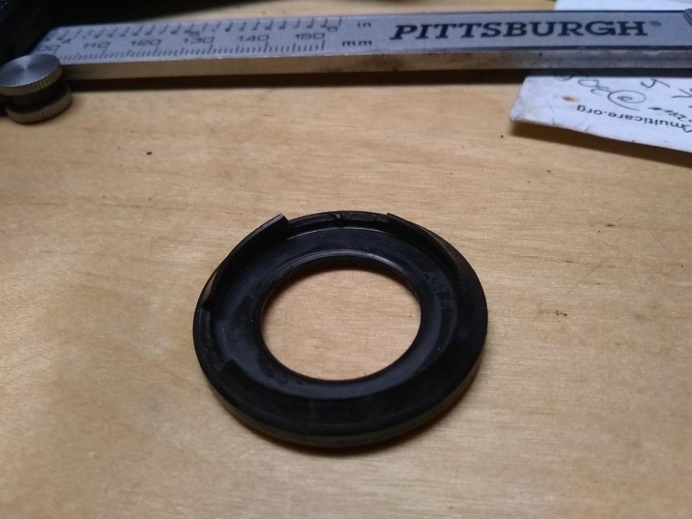

So the new seal arrived Friday (last) but we signed for a house, had a daughter get married, attened 2 wedding connected dinners, traveled to the ends of the world and we're beat. I got the old seal off with a knife, the new seal has a band of metal on it, so it presses in place, I saw no such band of metal on the old one so maybe it was bonded. In any event here it is... comments welcome. I thought it fit right next to the gear but it doesn't. I looked at the pics posted here and the positioning looks good, I test fit the saft to the final drive gear and it is where it belongs. So all that remails is installation. Waiting on other parts now. -

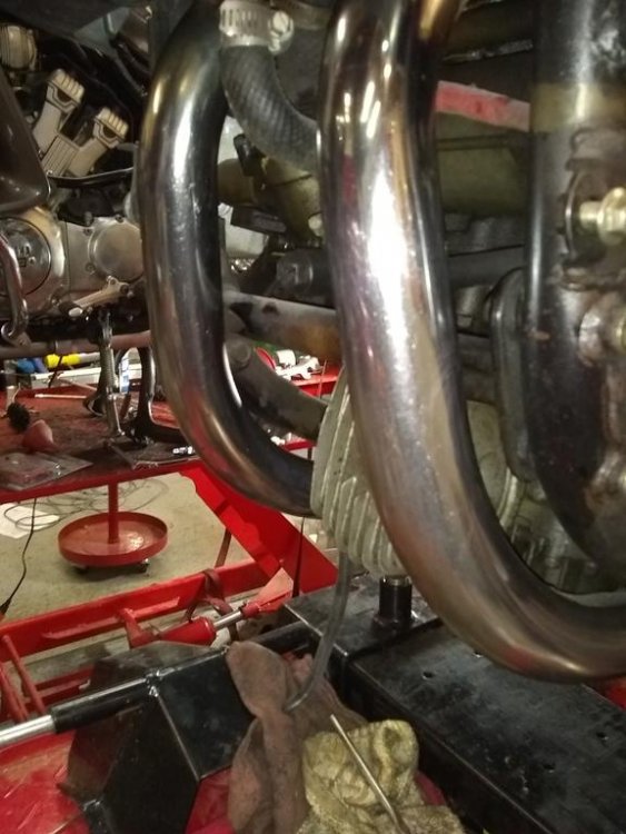

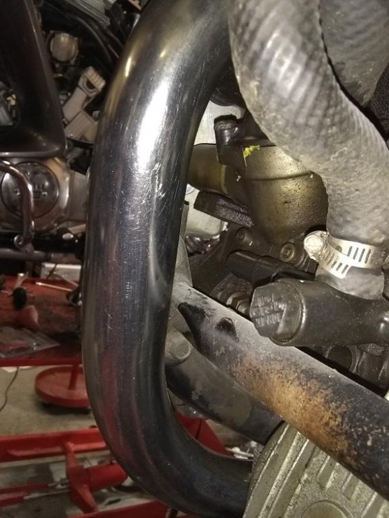

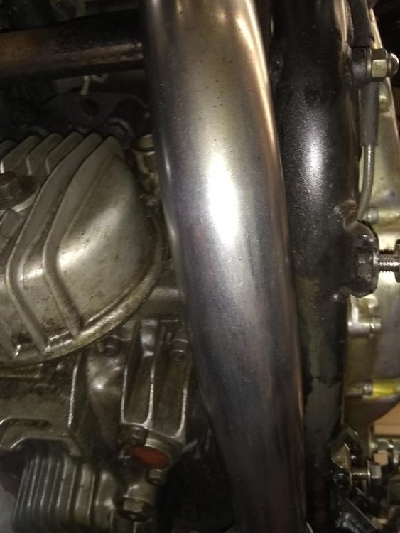

These pics are from the same bike, it's on the H/F lift and (right now) the only bike I can gets parts off of as the other 2 in the garage one is a parts bike and it's jammed in the corner with a bunch of crap in front of it. I didin't see any rash, like it bottomed out, I did notice a little pin prick rust. -

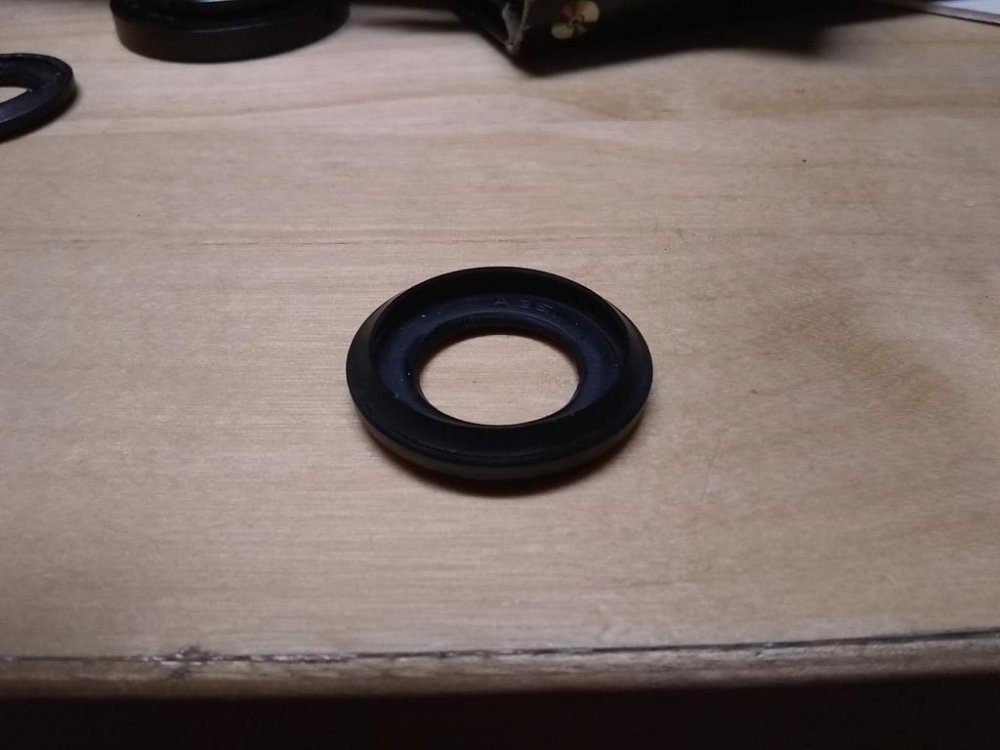

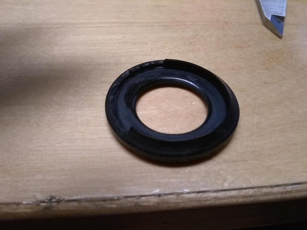

Thanks! I have these pics, they are SIMILAR to the other 2 part numbers. I am looking to give the bearing company EXACT pictures of what I seek. The dimensions I gave them (when running an internet search result are oil seals similar to those used on the front wheel of our motorcycle. This type of seal won't work. See below for my pics of what I removed from my 88. Below are pictures the 3 different part numbers; of cover, dust, cover, thrust1, cover, dust 2. I have thoroughly researched this issue. Item 18 on the parts list for the 1988 year model bikes is PART NUMBER 26H-22128-00-00; "COVER, THRUST" the assembly requires 2 each, that's about $34.00 +shipping. Item 34 on the parts list for the 1988 year model bikes is PART NUMBER 26H-2217H-00-00 "COVER, DUST" PART NUMBER No price at all on the parts list the assembly requires 4 each, Item 36 on the parts list for the 1988 year model bikes is PART NUMBER 26H-22129-00-00 "COVER, thrust 2" @ $14.39 + shipping and 4 each are required . Thanks for any assistance you have or may have provided.
