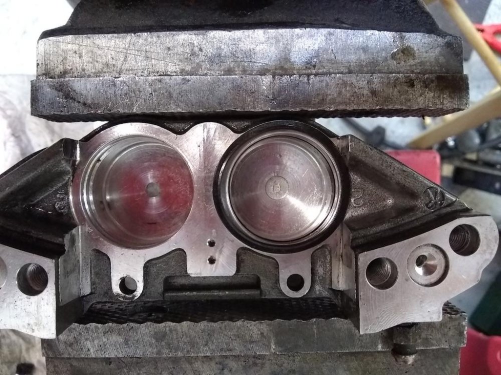

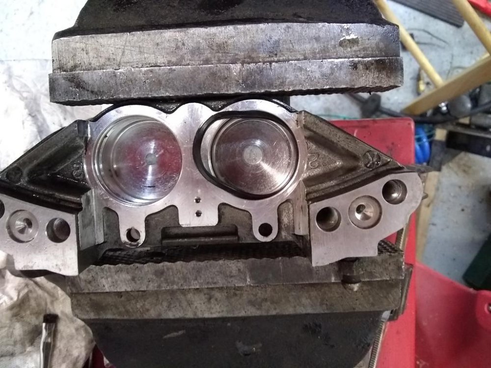

	My anti-dives are still installed.
	I ordered my brake seals 3 each of 1KT-25803-00-00 Caliper Seal Kit Made by Yamaha. The dust seal is too big, the other (thicker) seal fits fine; what's up? So, I figured out that there are two cup sizes, M7 and M8. You can't get a M8 in a M7 hole and the M7 cup is too sloppy in the M8 hole; cool how that works huh? So one side of the caliper is M8 and the other is M7. So how does the one size M7 fit the M8 hole and vice versa; and BTW the last seal kit I opened is apparently for M8 hols because the dust seals won't fit. Now after exposure to brake fluid do the dust seals shrink? I doubt it....All my kits have the same part number and they are all labeled Yamaha. Thn to Thanks to cimmer for the education! Thanks for the screw-over Yamaha.
