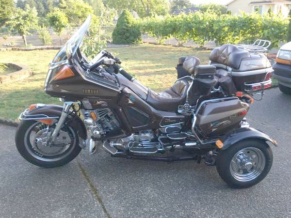

Update. Something _hit the bed. Battery is grave yard dead. Something made a "click" sound, like a fuse blowing, but fuses check good. I had a stall at a light, it wouldn't start, the starter wouldn't turn over like it should. I'm thinking 2 brush starter syndrom. Pulling starters this weekend, the 4 brush starter from old #1 , and starter from the 3 wheeler, install 4 brush starter and 6 gauge wire on 3 wheeler. Hopefully end of problem. -
Well I rode the 3 wheeler tonight! Yee Haaw! With the 2nd gear toast it just isn't the same! The drive shaft from E-Bay showed up today, it looked better than the pics in the ad so I put it in right away. The brakes still have some air in them but the brakes work well enough, I have to change the windshield out with the one I bought through JC Whitney, the one on it has so many micro scratches the glare from on-coming head lights blinds me. There are some warning light issues, the regular light telling you head light is ok and on low beam doesn't work and the head light seems to be intermittent, the temp gauge is inop; I'm betting the drain valve is in the wrong position; isn't there an article on the forum on that? The outboard wheels' bearings have just a tad of play in them, I'm betting they weren't properly packed with grease either so I'm looking into all these things tomorrow. I will post new pics then too; showing my re-upholstered and heated seats. You'll also see I dumped the rider's floor boards too; they made shifting to awkward. This winter I hope to have the other project bike up and running so I can tear this one down and fix the 2nd gear issue. I hope to post some pics of it tomorrow as well.

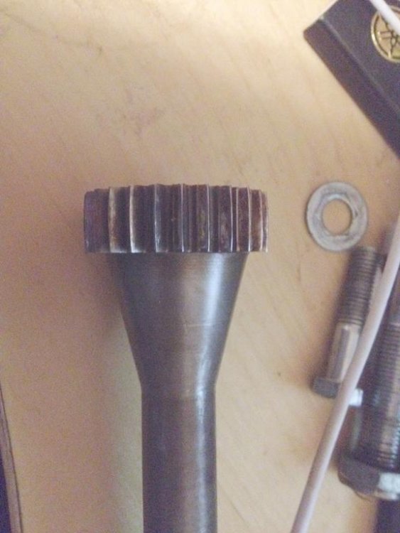

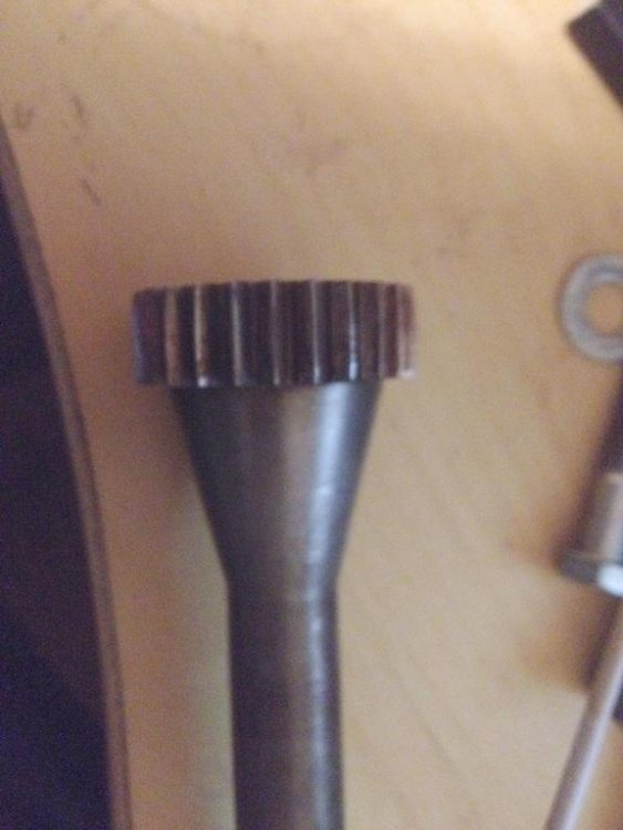

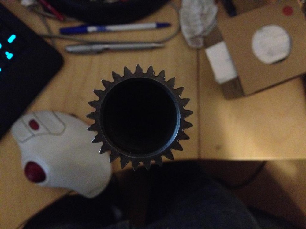

Here's the "other kind"; I pulled this out of the old #1 bike; looking good! So this is going in tomorrow! -

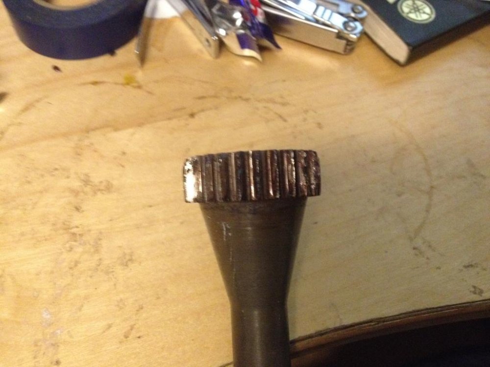

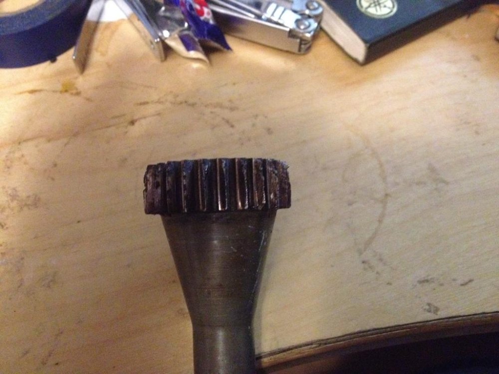

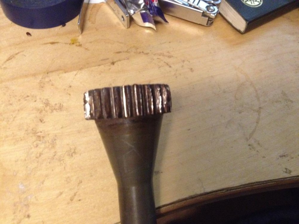

Yeah that was my judgment too; TOAST, sourdough! I just checked the parts catalogs and found the 1300CC bikes use a different shaft as well. So I was wondering if a 86 y/m rear wheel/differential assembly be used on the 83 to 85s (the 1200CC bikes)? Just curiosity, THAT would be pretty cool.... I know some pretty S/H machinists that have the capability (at home) to do the machining, but then I suppose if it were really necessary you COULD file it to shape... -

To paraphrase "The Blues Bothers I" I got both kinds; good and bad" right here! I have 6 VRs here; ONE that runs another ONE I have hopes for and FOUR parts bikes! When I was on active duty I saw a large truck axle repaired on which the end of the axle (about 2" of splines) were broken off with "Belzona" a kind of epoxy. I wonder if this can be used to repair the drive shafts and gear coupling... as they are obsolete. -

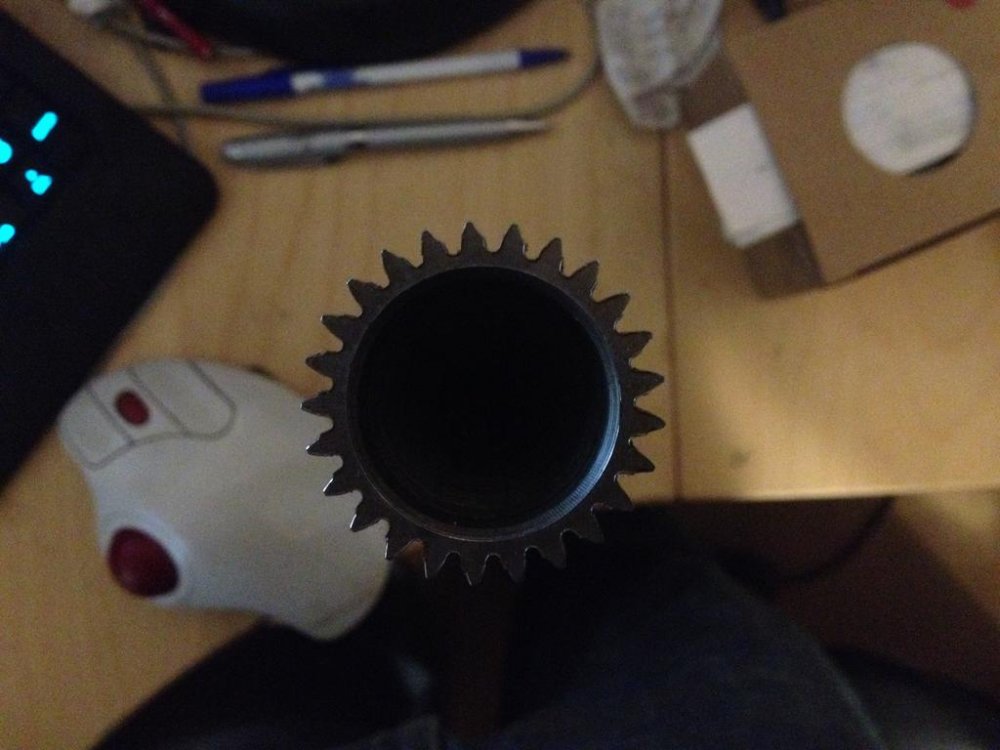

Pulled the rear wheel today to check for grease and general condition of the drive shaft and differential. See the pictures below. I am changing out the rear tire and wheel, along with the front too. These tires are both made in 1012 so that's on but the tires on the other bike are newer and the drive shaft and pinion are in way better shape. You'll have to enlarge the picture to really see just how chewed up the teeth are; I think they are burned a bit too. So even though Yamaha doesn't list a servie interval for greasing the drive shaft, conventional wisdon dictates that EVERY time you remove the rear wheel, Inspect and GREASE THAT SET OF GEARS!!!
