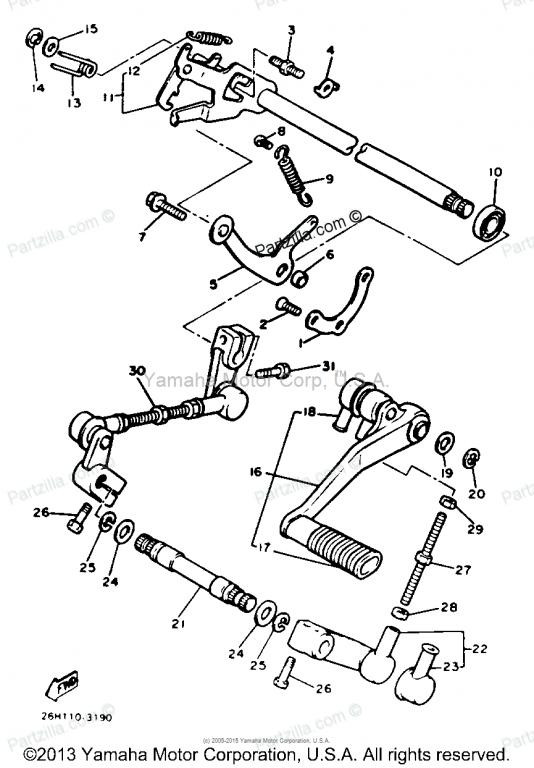

Did you not see the diagram from the parts catalog?

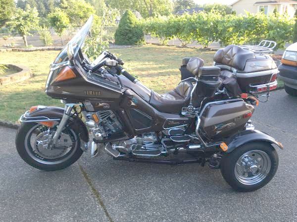

Ok my new '85 has some issues. The Starter clutch needs replaced (I have the one intended for the 83/84) No 2nd gear, hard starting, and the shift rod (item 21 in the picture) seems to wobble yet there is no oil leak. The adjustable link has a piece of rubber hose and tape connecting the BROKEN? adjuster? has tape on it and the other end. The bike has a toe/heel shifter lever on it that has a lot of play inboard to out board. There are floor boards on this bike, In my exp. they just get in the way of shifting, my 83/84 had them. I prefer the pegs with foot rests mounted to the engine bars. I found the wrong spark plugs had been installed; I found NGK#DPR7EA-9S in the holes instead of the DPR8EA-9S called for in the book. The fuel filter looks pretty dark but I haven't removed it yet; I have one on hand. I have not heard the pump run either...yet I drove it home a good 50 miles on Sunday. The left rear carb boot wasn't exactly installed right, and all the boots were loose. The oil in the sight gauge is on the TOP line (when cold) instead of centered in the window where it belongs. When moving the choke lever there is no sense of anything moving, I thought the cable was broken but it's there and moving the choke levers. The PLAN is to install coil over shock ignition coils and the Ignitec ignition but I have to re-program the ignition for a '85 first. Change the starter clutch, as I have a set of new clutch disks on hand so I will install those. Question: Would I get better performance by glass bead blasting the clutch steels or should I leave well enough alone? Of course I will fill the carb bowls with Sea Foam and let it soak for a few days while I pursue the PLAN AND run the obligatory 3 cans of Sea Foam through it once it runs. I have a new oil filter on hand and will change the oil once it's running. The tires look good, I got the error code 4 on the air suspension controller; I have a friend (ex missile tech on Ohio Class Subs) who can fix that for me. This bike is esp. clean! Under the seat, the wires are all bright and nice. I installed the seat my wife bought for me in celebration of our wedding anniversary and my birthday; Both are on the same day! It's covered in real 2 tone leather, heated and extended in the back for her comfort, along with the back rest (mounted on the trunk) and the pad that supports the "small" of the back mounted below the back rest. The fuse box is 100% original! looking under the false tank cover gives me the feeling of what it must have been like being an Original owner; I mean there is a COVER over the fuses! All the in-line (fuses/breakers) stuff is there! It's a dream (or nightmare) come true! So I would LOVE some input from you folks!

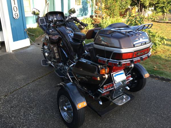

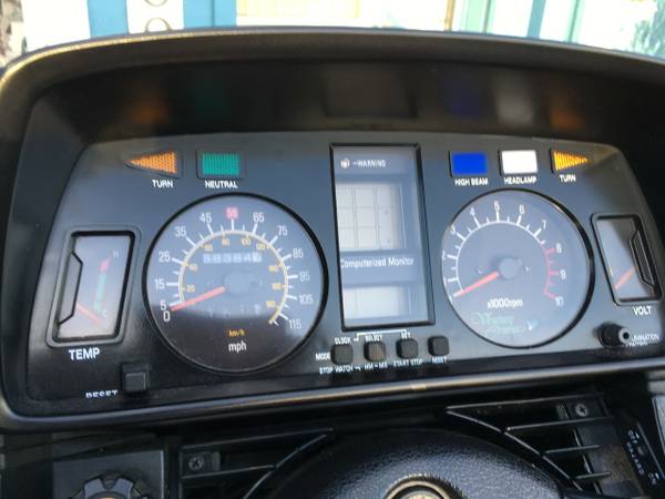

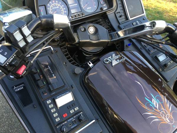

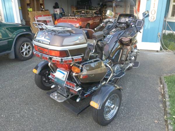

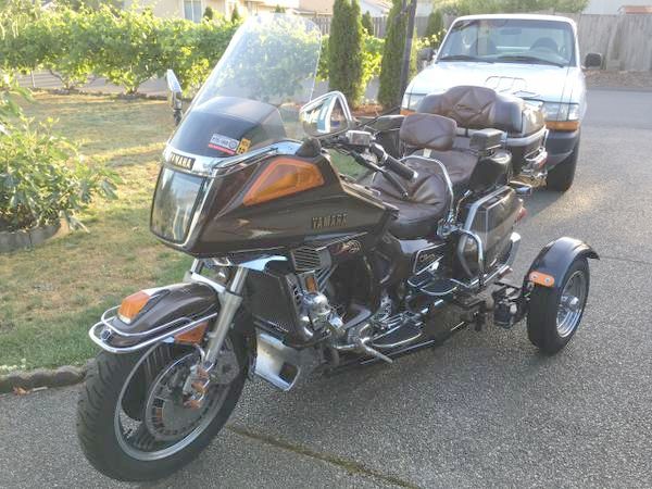

UPDATE! Paid $2,200.00 for her. A VERY WEIRD trip home. rides all different from a 2 wheeler. The things I noticed: Temp gauge does not work yet the fan goes on and off. Gas gauge was reading one bar below full when I left the PO's house. Was on one bar below 1/2 in 25 miles. the vents on the dash and left side shin d/n stay open. Did not get the intercom wire, wrote the PO to mail them to me. The owner's manual was in the trunk, didn't see a tool pouch though. The radio works on one station, the speakers ain't worth a damn. Tried the CB, didn't hear anything. The air system reads code 4; big surprise there. It has a miss/back fire. I'm sure the plugs are tired and the ign. wires are prob tired too.

The PO said he found (on the internet) a company in Georgia that would build a set up based on measurements sent in by the owner. It has an air bag on each side to act as a spring. Pics later.
