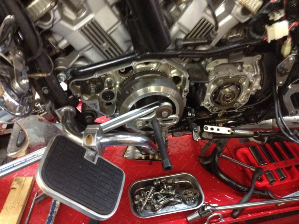

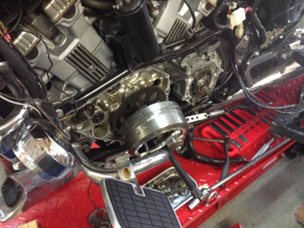

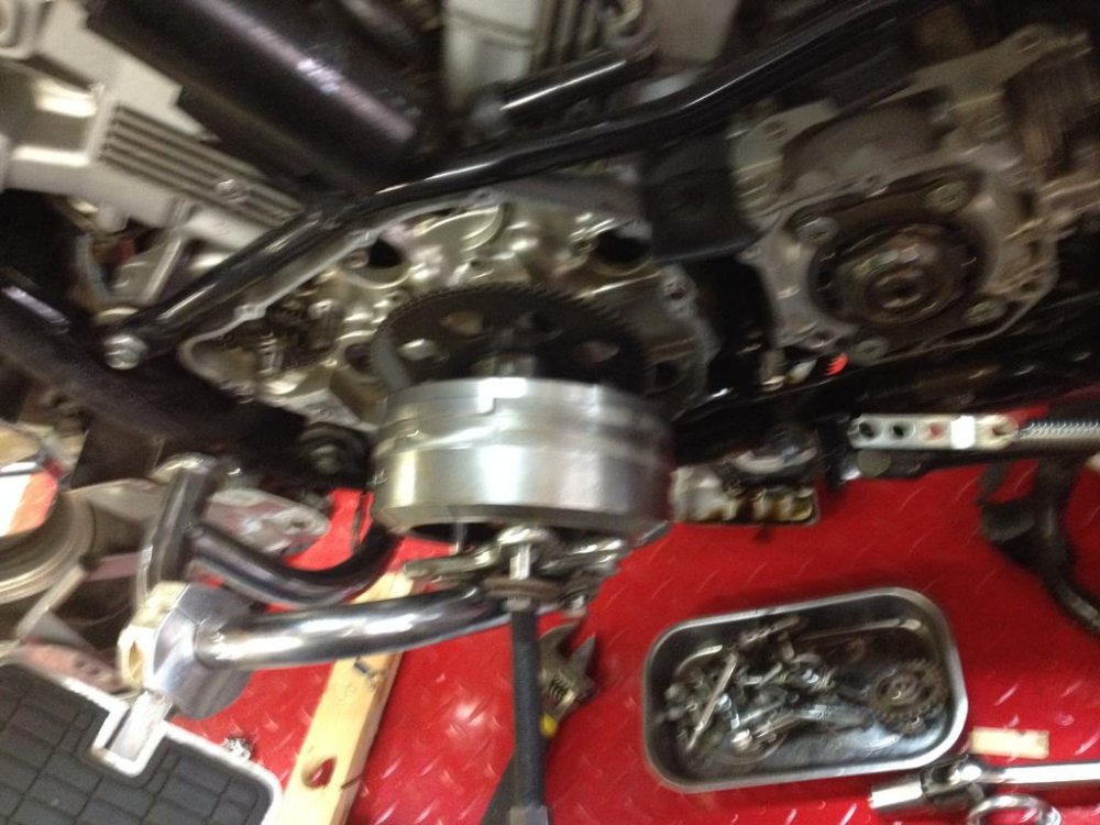

So the first pic is of the bike taken by the PO. the 2nd is the starter clutch under tension from the puller. It was left all night with tension on it but it was still VERY WELL IN PLACE in the AM when I ck'ed it. 3rd and 4th are of the starter clutch loose off the crank shaft. BAM it came loose after a couple dozen taps with a BFH.

Got the engine side covers off today, noted that the local parts houses had no H/D clutch springs to go with my new friction disks so I ordered some Barnetts on E-Bay. The Started clutch is tired on this bike so I'm installing the hopped one one I bought from one of the guys here. I have the puller on the original one (still on the bike) it under tension; I'm waiting for it to pop off over night then I will swap them out and re-install the cover(s) and install original foot pegs and shifter arms. The bike had floor boards but they make shifting too awkward for me and besides there are some foot rests on the case guard bars that look pretty comfortable to me. I like riding with my feet on the stock pegs, having an alternative place to put them (my feet) is all I need. This week I will clean the gasket surfaces on the side cases and engine proper while I wait for my parts, replace what I can of the original foot pegs and I have a new seal for the shifter rod to install too. I will be installing those ign. coil over plug assemblies tomorrow. I'm looking around for the disk and cord Dingy send with the Ignitec ignition so I can re-program it from the 83.5 to the 85. I will probably take off the wheels and check the bearings for wear and grease them if they are ok. The rear ones I will take to a shop in town that will remove and install the new "Balls Are Best" bearing for a reasonable price; maybe I'll take the front wheel there too.
