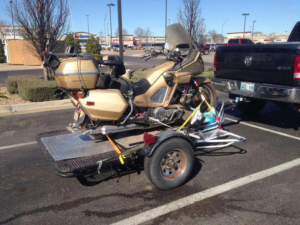

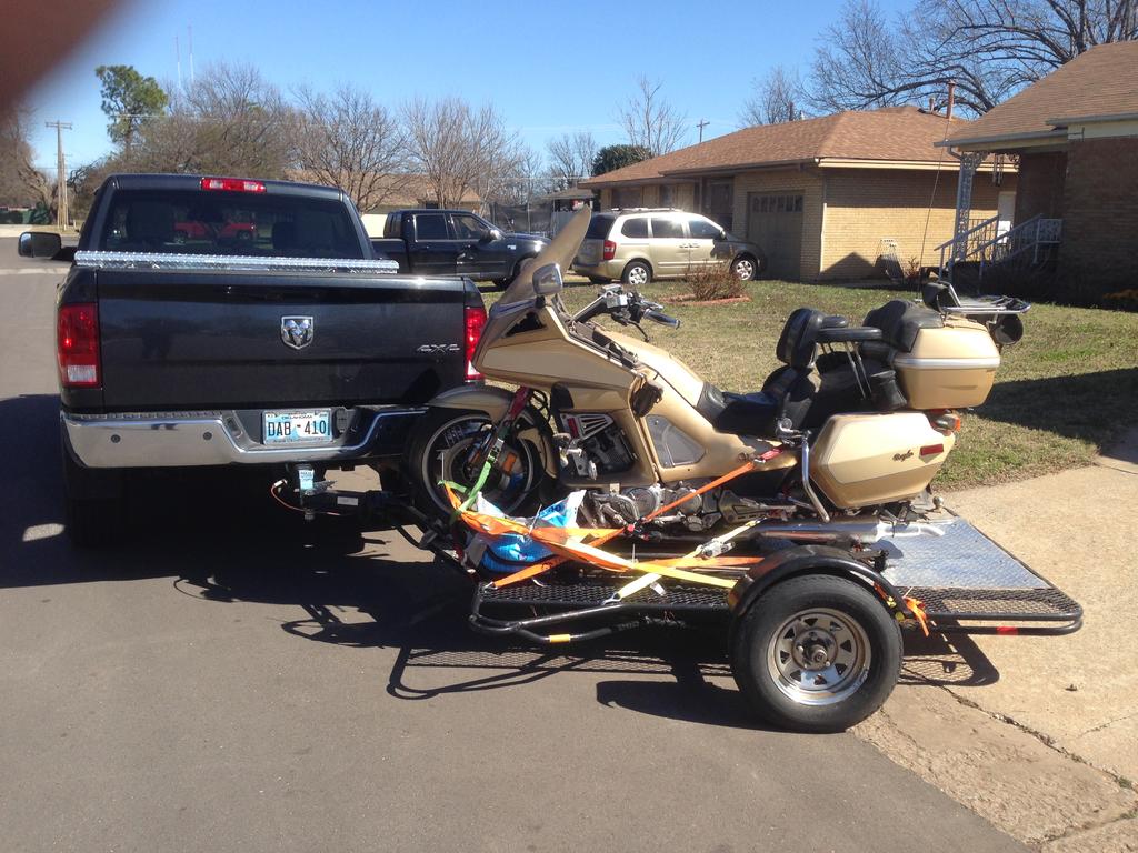

made2care Posted March 15, 2019 Author Share #130 Posted March 15, 2019 Well, I got her and headed home!! Link to comment Share on other sites More sharing options...
RDawson Posted March 15, 2019 Share #131 Posted March 15, 2019 I see extra goodies and bling. Ya did well. Keep us in the loop on the restore. Hope it's the only trip on a trailer, Ventures don't like trailers:stickpoke: Link to comment Share on other sites More sharing options...
Chaharly Posted March 15, 2019 Share #132 Posted March 15, 2019 Ohhh she is sweet looking! Link to comment Share on other sites More sharing options...

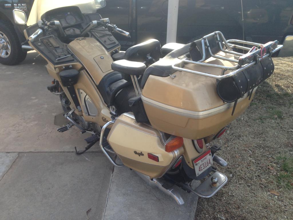

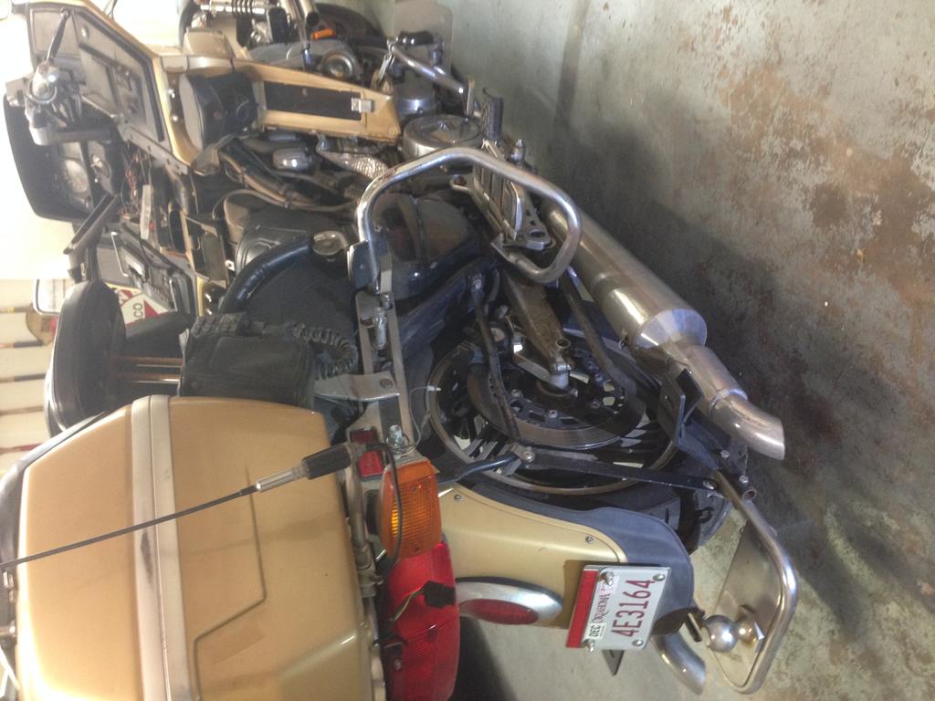

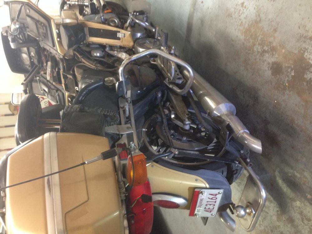

made2care Posted March 16, 2019 Author Share #133 Posted March 16, 2019 This bike is in rough shape but expected for its age. Closer inspection it might have been left outside. Radiator is bone dry. I'm going to have my hands full on this one. Link to comment Share on other sites More sharing options...
luvmy40 Posted March 16, 2019 Share #134 Posted March 16, 2019 Take it slow. 1 step at a time and don't skip anything. You've been here before. Just keep in mind, if you do this right it will blow away the Wings or Harleys in it's class. AND SOME THAT ARE WAY ABOVE IT'S CLASS. Link to comment Share on other sites More sharing options...

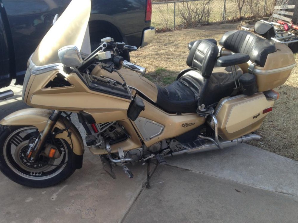

made2care Posted March 16, 2019 Author Share #135 Posted March 16, 2019 Upon arrival to pick up bike, the owner had a car jack underneath the engine, he had mentioned the frame was cracked where these are notorious for such. So between the shocks been blown and the cracked frame, she sat very low. I'm going to be pretty cautious unloading, then begin the strip down. Link to comment Share on other sites More sharing options...
made2care Posted March 16, 2019 Author Share #136 Posted March 16, 2019 Got her unloaded !! Heavy !! Time for a bath! Link to comment Share on other sites More sharing options...
cptriker1 Posted March 16, 2019 Share #137 Posted March 16, 2019 Is that nice or what!!! Sent from my SM-G950U using Tapatalk Link to comment Share on other sites More sharing options...
bongobobny Posted March 16, 2019 Share #138 Posted March 16, 2019 OK, the seat is not stock, looks like MK2 with some custom work also done. Stock seat is brown with a diamond pattern. Also missing is the CLASS (Computer Leveling Air Suspension System) module on the right dash. This may be either for some strange reason it never came with it or somebody removed it. Getting the frame fixed needs to be priority 1!!! Link to comment Share on other sites More sharing options...

made2care Posted March 16, 2019 Author Share #143 Posted March 16, 2019 I can agree with Bob on his last statement, I hope your Venture brings you as much joy as mine has me. I think this is about the last pic I took of my bike. Randy Beautiful bike ! okay, now the questions begin. Is there a way I can manually inflate the rear shock? As stated early by a member, the system control buttons are missing. How am I supposed to get air in rear shock. Bike is sitting too low. Link to comment Share on other sites More sharing options...
Freebird Posted March 16, 2019 Share #144 Posted March 16, 2019 Most of the issue with it sitting low is likely because of the broken frame. That is the first thing you need to address. I would look around and see if a Schrader valve has b been added. Itr appears that the original controls are missing so there is a fair chance that somebody has already modified it with manual fill valves. NOTE: The shocks are LOW volume. Do you use a air compressor to air them up. Most of us use a "Progression" brand or knock-off hand pump. Front forks are even lower volume of course. Easy to blow seals if you try to use a air hose. Link to comment Share on other sites More sharing options...
made2care Posted March 16, 2019 Author Share #145 Posted March 16, 2019 Most of the issue with it sitting low is likely because of the broken frame. That is the first thing you need to address. I would look around and see if a Schrader valve has b been added. Itr appears that the original controls are missing so there is a fair chance that somebody has already modified it with manual fill valves. NOTE: The shocks are LOW volume. Do you use a air compressor to air them up. Most of us use a "Progression" brand or knock-off hand pump. Front forks are even lower volume of course. Easy to blow seals if you try to use a air hose. Okay, i am still checking the frame and so far, all looks good but still looking. Front forks are shot, will rebuild those later. Yes, I'm very careful with putting air in shocks. The previous owner said that battery acid leaked onto the frame and I don't see any sign of that. Also, I'm going to use a sealed battery. Link to comment Share on other sites More sharing options...

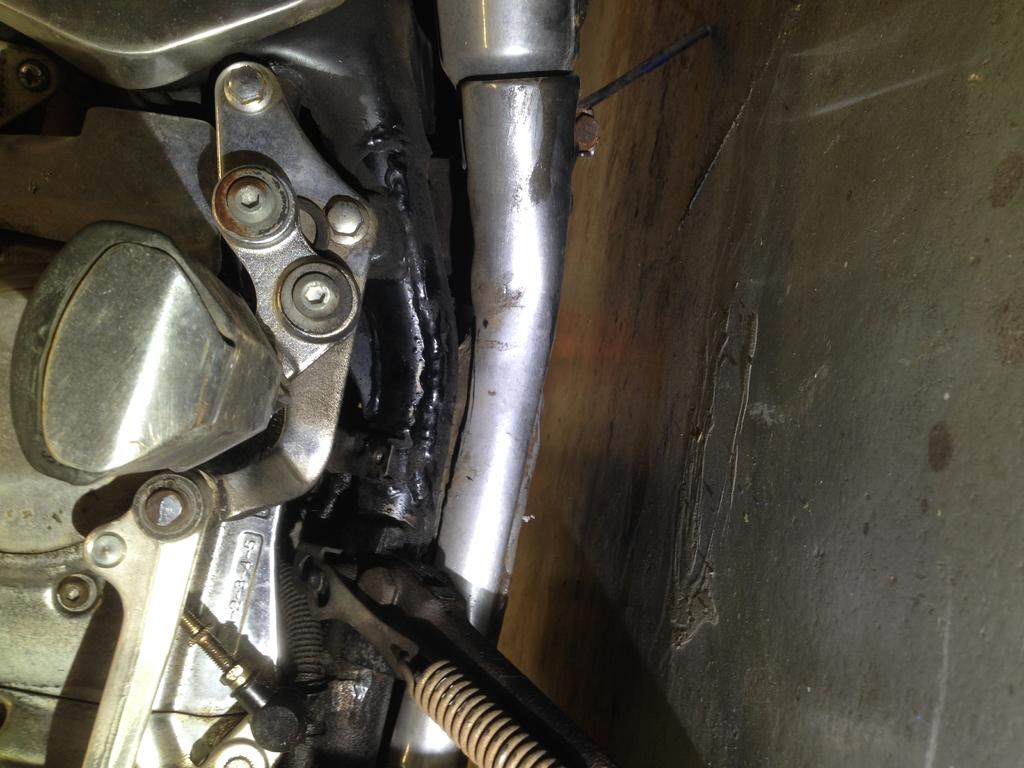

made2care Posted March 17, 2019 Author Share #146 Posted March 17, 2019 Left side of bike, lower frame I found a long weld. Looked good and painted too. So far so good. I think with the front shocks sitting so low , that's contributing to bike sitting low. Link to comment Share on other sites More sharing options...

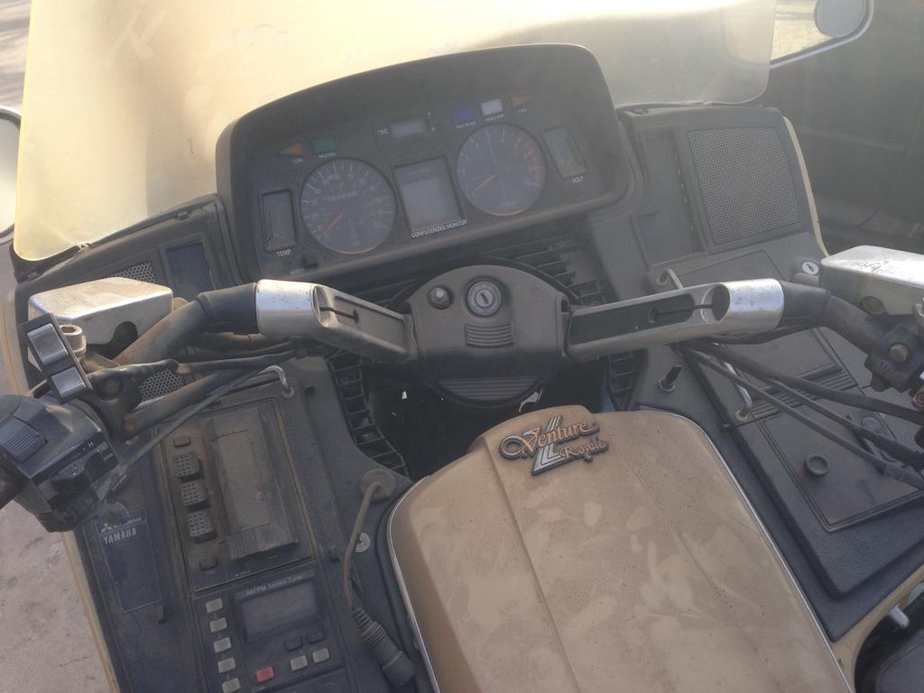

cowpuc Posted March 17, 2019 Share #147 Posted March 17, 2019 Got her unloaded !! Heavy !! Time for a bath! now THAT is what I am talking about,,,, SHE IS GORGEOUS MADDY:thumbsup:!! Ya do indeed got yourself a lot of project there my friend but you also have a LOT to work with:thumbsup:!!!!! Looking at the fairing "glove box" on the right hand side (opposite of the radio/cassette), those compartments "lids" are different to me and my memory of my 84 Royale. I can see what others would think no Class System as it does not appear to have normal controls for such BUT, I notice the upper section of that box cover has a chrome pull bar on it? None of my Standards have that but my Royale had it on both sides like your does, IMHO, that little pull bar is indicitive of a removeable carrier tray for components hidden inside the compartment. Then I notice what appears to be a little knob on the left of the bottom door and what looks like a rocker switch located to the outside of that compartment door - this is something I have never seen before and I gotta ask, is there any chance here that those are indeed the Class Controls for the 83? My 84 had a factory CB located in that bottom section and the CLass panel was above in the upper compartment right beside where your bike has the Chrome pull handle. Link to comment Share on other sites More sharing options...
made2care Posted March 17, 2019 Author Share #148 Posted March 17, 2019 now THAT is what I am talking about,,,, SHE IS GORGEOUS MADDY:thumbsup:!! Ya do indeed got yourself a lot of project there my friend but you also have a LOT to work with:thumbsup:!!!!! Looking at the fairing "glove box" on the right hand side (opposite of the radio/cassette), those compartments "lids" are different to me and my memory of my 84 Royale. I can see what others would think no Class System as it does not appear to have normal controls for such BUT, I notice the upper section of that box cover has a chrome pull bar on it? None of my Standards have that but my Royale had it on both sides like your does, IMHO, that little pull bar is indicitive of a removeable carrier tray for components hidden inside the compartment. Then I notice what appears to be a little knob on the left of the bottom door and what looks like a rocker switch located to the outside of that compartment door - this is something I have never seen before and I gotta ask, is there any chance here that those are indeed the Class Controls for the 83? My 84 had a factory CB located in that bottom section and the CLass panel was above in the upper compartment right beside where your bike has the Chrome pull handle. There is nothing inside those compartments. It's been gutted! I still have to buy a new battery so not sure what the toggle switch is for. What do you think about the long weld I discovered on the left side? So far frame looks good . Also, there is a battery in it and I'm sure it's toast, why is there a wire/ sensor going directly into the battery cell? I only use sealed batteries. Link to comment Share on other sites More sharing options...
made2care Posted March 17, 2019 Author Share #149 Posted March 17, 2019 Some more pics. Notice the weld. Link to comment Share on other sites More sharing options...

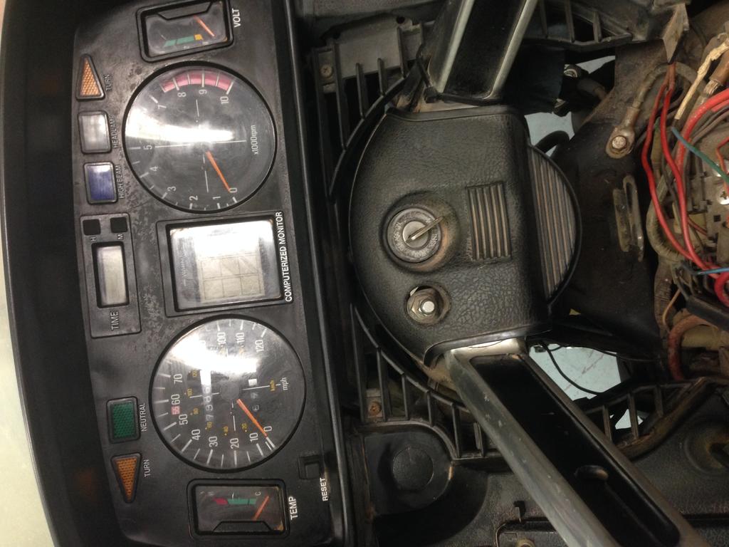

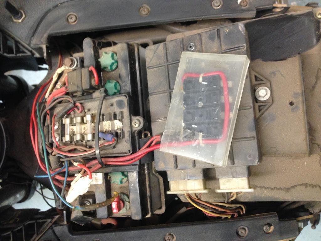

cowpuc Posted March 17, 2019 Share #150 Posted March 17, 2019 (edited) That wire leading to the battery is a sensor wire for the CMU readout. The OEM spec batteries came with an xtra hole in the above the normal 6 holes for filling with acid that that sensor wire would plug into. When you turn the key on and the dash readout goes thru its tests, one of those readouts will be a battery test. If that test fails you will get the little battery symbol lit and little red nusiance of a flashing light on the dash telling you there is a issue with the battery. Many of us (I cant remember when the last battery sensor I had intact on a 1st Gen was) just bypass that sensor by stickin a resistor in line with it and taking the lead to 12vdc = tricks the CMU into thinking all is well.. Without going downstairs and checking to verify, that long weld looks normal to me.. I think it might be where Mom Yam relieved the frame tube for bending but cutting it and then Jig welded it back together - just a thought,, will double check my frame when I get a sec. Does your scoot have the dampner and air shrader assembly on the left side below the side cover? WOWZY WOW WOW WOW ya varmint!! YA GOT A BUNCH OF GOODIES ON THAT PUPPY!! ABSOLUTELY LOVIN ON THAT TAIL LIGHT Edited March 17, 2019 by cowpuc Link to comment Share on other sites More sharing options...
