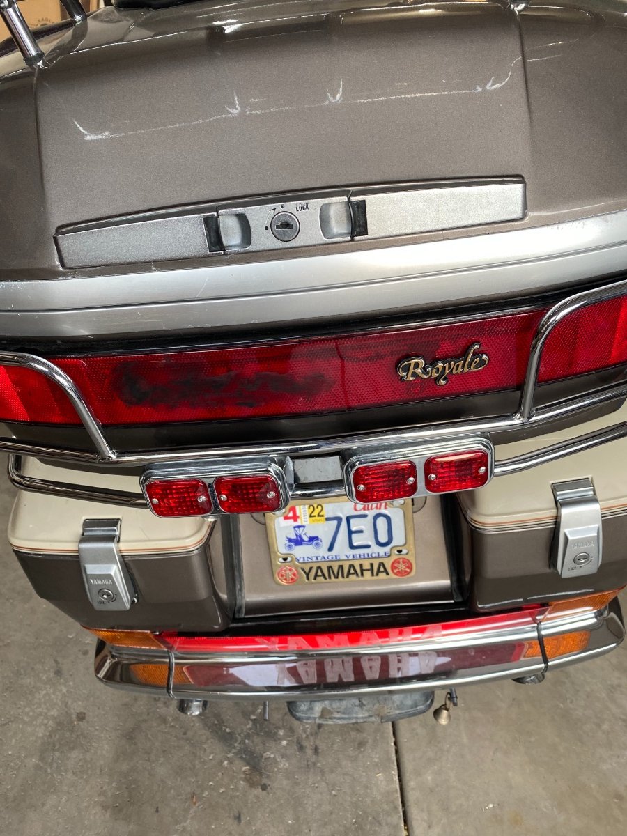

Pasta Burner Posted October 2, 2021 Posted October 2, 2021 Old thread I know, but good info I was looking for. I think I’m going to use the 3M emblem adhesive to put the badge back on. But my initial question is what would y’all recommend to remove the existing tar like adhesive? I don’t know what it is, or if it’s OEM but in the desert sun it started melting and the emblem began to slide downward. I pulled it off before I lost it. I tried some IPA with little success, I’m afraid Of clouding or damaging the lens.
Marcarl Posted October 2, 2021 Posted October 2, 2021 Try some non-chlorinated brake cleaner on a rag. 1
Squidley Posted October 2, 2021 Posted October 2, 2021 6 hours ago, SpencerPJ said: Try WD-40 X2 on WD40 1
Pasta Burner Posted October 2, 2021 Posted October 2, 2021 Did the WD40 cause it was close at hand. Took it all off in about three swipes. Thanx! 2
SpencerPJ Posted October 2, 2021 Posted October 2, 2021 7 minutes ago, Pasta Burner said: Did the WD40 cause it was close at hand. Took it all off in about three swipes. Thanx! Great for bug and tar remover too 👍 1 1
