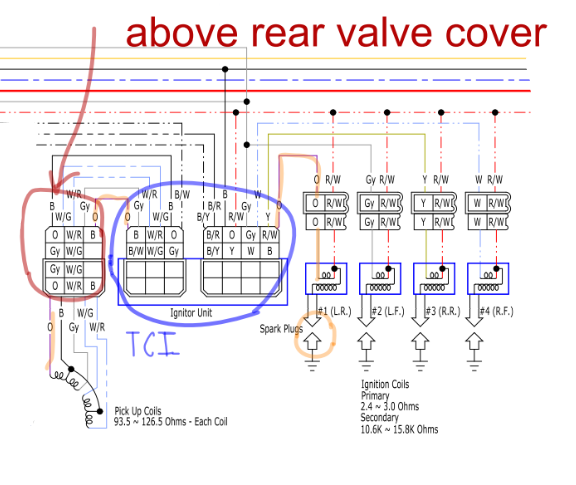

I wouldn't think the pickup coils themselves would be the problem either, but perhaps the wire connections or quite likely the tci -

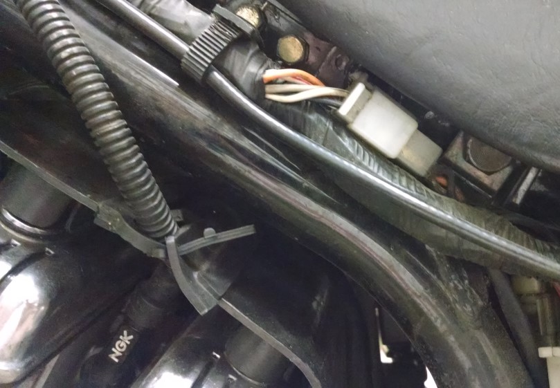

Most people here would agree that the ignition system is pretty simple to troubleshoot. There is only about 4 basic steps and I'll outline them for you below. I have also highlighted the #1 cylinder ignition circuit in orange. You can see from the diagram that it is actually quite simple. Since you are getting spark on #1 that means we know that you are getting current to the ignition system. 1. Check all obvious things such as both ends of coil wires, new or known good spark plugs, broken wires, etc. Check the air in the tires (joke) Tune the radio to Classic Rock (This one is Very Important) 2. Check the connector with 5 wires that is attached to the frame on the left side, below the seat (see pic below. It is also circled in red in the diagram below). Make sure that it is clean and has continuity (a good connection through both sides of each wire). You can do this with a multimeter. Side note: At the south end of those wires is the Pickup coils that are located in the left side engine cover and the north ends go the TCI (Ignitor Unit on the diagram). 3. Ensure that the 2 connectors on the TCI are clean and firmly connected (circled in blue). The TCI is located below the battery and above and kind of forward of the engine 4. Make sure that the small 2 wire connector on each coil is securely plugged in. (4 in all) and that there is 12V on the Red/white tracer line on each one of these 4 connectors. You have now pretty much traced out the entire ignition system. If all of your connections are good then the next thing is to try another TCI that is known to be good. -
