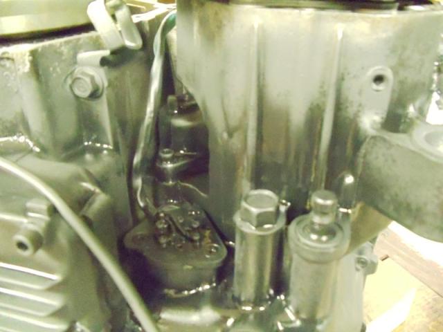

Picture attached is of the bottom of motor, front of motor to the left. Not much back there to leak. 3 good possibilities. 1st is oil pan has come loose, there are 12 cap screws holding pan in place. 2nd is that oil level switch seen in upper left corner of pan is leaking and running back along pan. 3rd chance that pan has been struck and cracked. Also it could be a leaking shift shaft or gear position switch in 2nd picture. right in center of picture also shown is a drain bolt that will drain about a pint of oil, not much but looks like a lot on the floor. Each time rode, the pocket that this bolt drains would be refilled, a few times and all oil would be depleted. Pocket will only be refilled when motor is running. Or also the lower cap screw on middle drive cover will drain similar 2nd pocket, it could be loose or missing crush washer. Gary -
