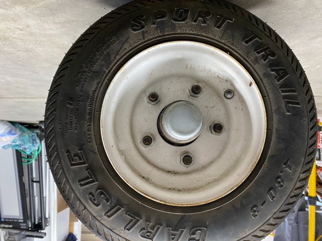

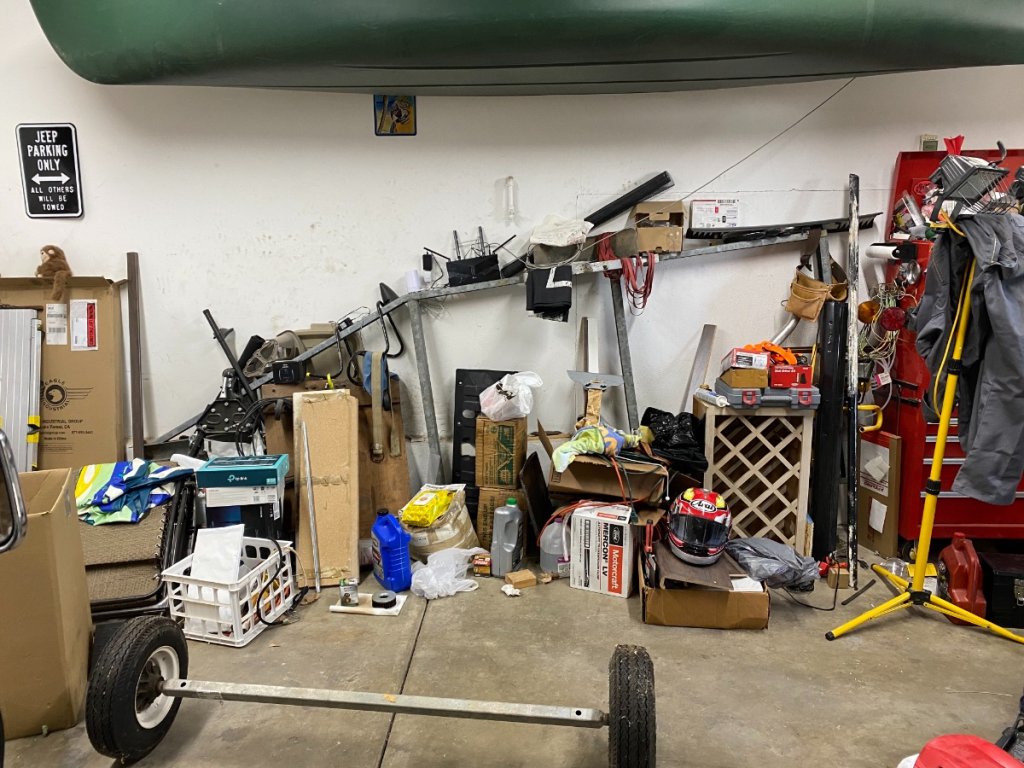

  3. These are all good points and the reason I asked before moving forward. I’m still having a hard time believing 1000lbs hanging as mentioned 3’ off the back of a receiver lasting too long, also pushing 800lbs up that ramp ain’t gonna happen, would need to find a good hill or high curb to help. I found the same issue with u-haul being round trip and also in my area a 5 day max. so after pondering a little today I realized I’m an idiot. I already have a trailer!!!! I have an old Highlander (Shoreliner) bunk trailer from my Hobie 16 that I got rid of when I moved (sold the boat, kept the trailer). It’s been propped up against my garage wall for the past six years. I initially counted it out because of the 4.80-8 tires and low speed rating. And I haven’t put it together here because one lack of need and two lack of storage, I need to remove a fence panel or install a gate. Then I realized all I need is new highway tires and maybe adjusting the fenders. Measures 5’w X 10’l plus tongue. Single leaf spring with 1800lb capacity.

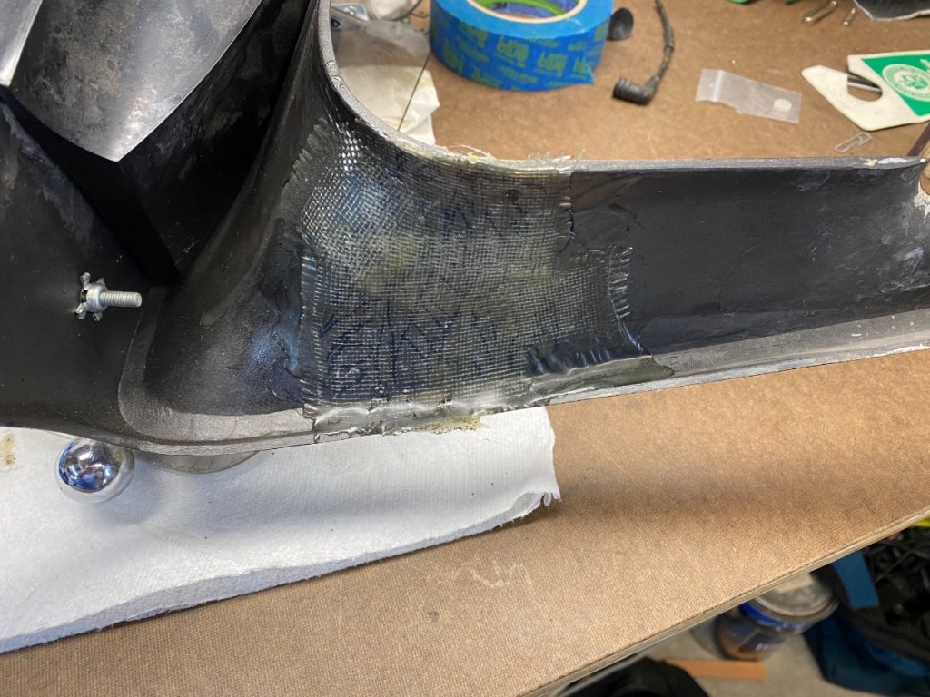

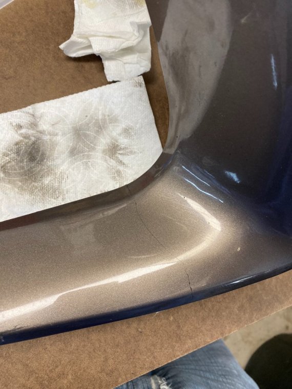

  21. In the interest of time and not committing to a paint job I decided to fiberglass the backside for now. I will be investing some time into plastifix though because there are a lot of tabs broken off on this thing.
