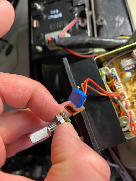

Here’s a little more clarification of my testing. Technically not “bench” test as I needed the bike connections. But I used comparable components. Now I’m getting the random “7” again which I fear will drain my battery so in the Interim I’ll leave it disconnected. Some pics of the test Pot and Erratic 7. Note: the unit is upside down. IMG_0116.MOV IMG_0115.MOV -

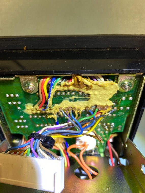

So I still have no idea why it was displaying a “7” but that seems to be gone. Up until today I have been overly impressed with the engineering and quality of this machine. Maybe the CB units were outsourced but I came across the most inappropriate design for attaching fly wires to a circuit card. Most of the wires have broken strands. They thought it a good idea to solder 26 AWG stranded copper to a surface pad. Not even plated strands. Anyway I put the OEM design back in place and bench tested the squelch Pot which failed. Radio Shack didn’t have a 50k of the right dimension in stock but for a couple bucks I bought one electrically correct to perform another bench test. Everything seems to work correct now. I tested with my truck cb and it receives well and will transmit static to my truck when PTT is exercised. I tried using a 5pin cobra mic that I had laying around but it didn’t transmit, I’m guessing some incompatibility with multiple buttons. Now to find a Pot of the right size and electrical spec. -

Not much of an update, large chunk of my day got sidetracked waiting for a missile delivery that of course was hours late and ended with minor complication, but successful delivery. Just another day with the USAF 😜. I found the broken wire home and discovered a handful more that are hanging on by a strand or two. The conformal coating on those shows obvious signs of heat. I think I’m going to rework all those connections. Day off tomorrow but going in for some needed catchup so hopefully I’ll find some bench time to work it more. -
