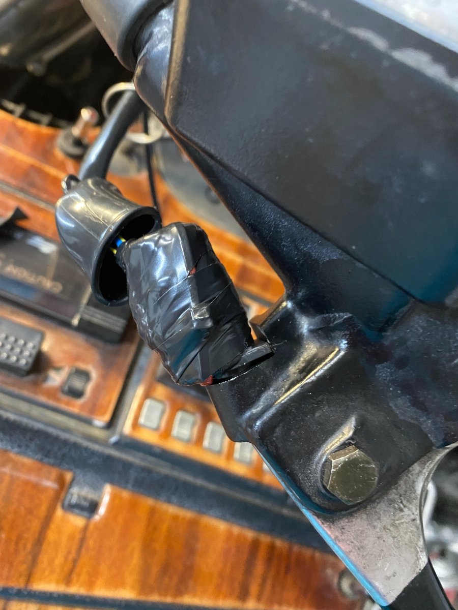

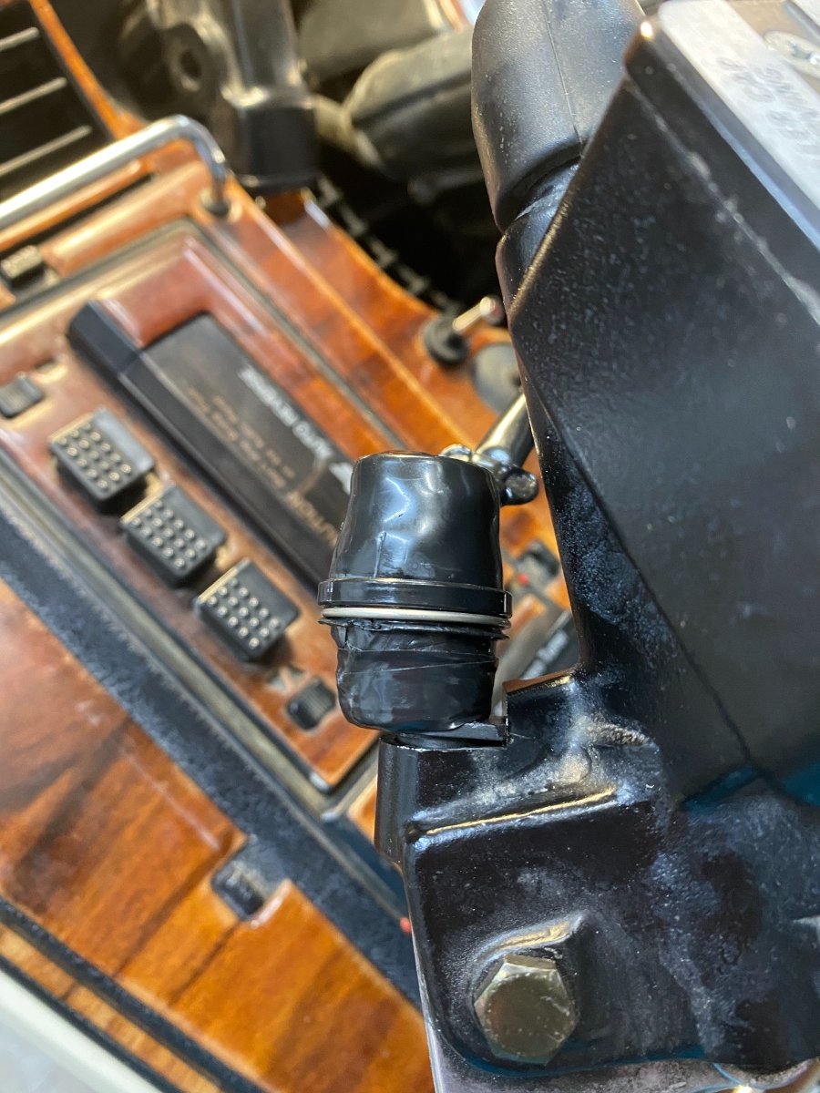

  8. As for your clutch switch…mine (87) was only starting in N as well but just a few days ago I broke and fixed that problem. The switch has a spring actuated plunger activated my the clutch handle that was gummed up and not working. I took mine apart to clean. THIS IS IMPORTANT, inside the switch was pristine clean. I added some contact grease because I had it open but it was like factory inside. THE HOUSING BROKE DURING REASSEMBLY. So that sux. My point is start with some lubricant external and working the switch plunger before taking it apart. Here is an unrelated titled thread that gets you to where I ended up a few days ago. Oh also now the the clutch lever switch is “fixed” it’s really not, there is a gnats hair movement that will either let it start in gear or not, but these are the things that come with 30+ yo machines

  13. As far as anything you can do to prevent scratches all I can say is be careful. But to fix scratches I second touch up paint. And if I can find it I’ll be trying my first application of fluid film soon. I know I’m a newbie here but I interpret the Watering Hole as a place for all topics 😜

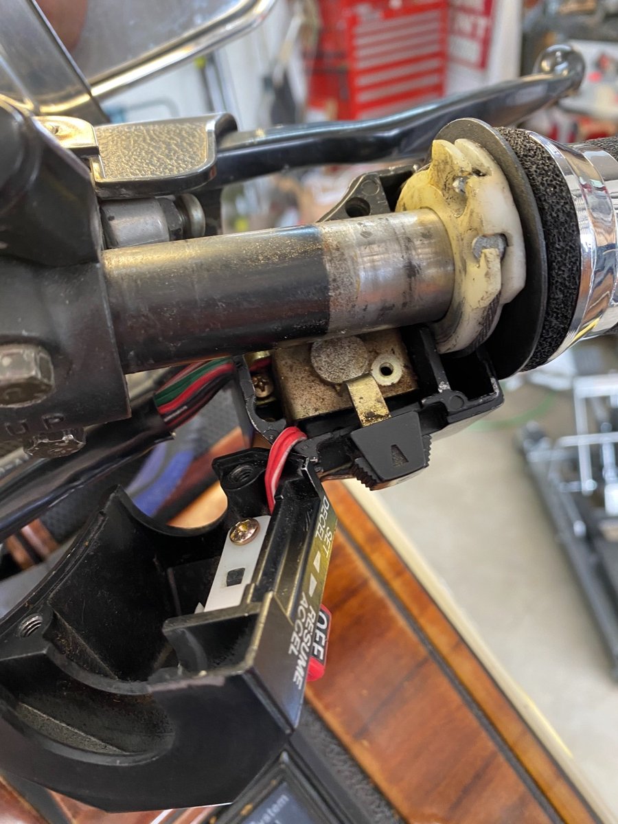

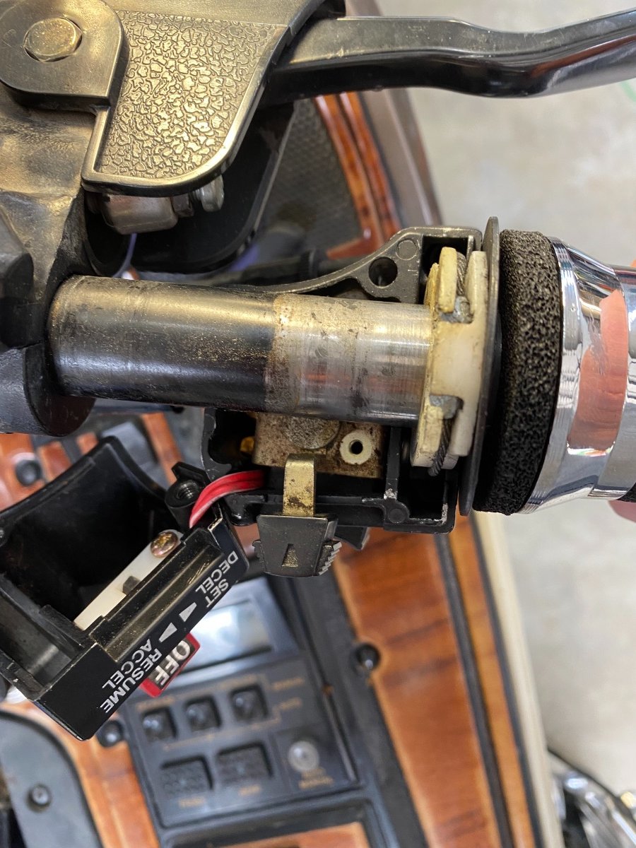

  18. Link to the bike? Price? Can’t give advice without details. That being said I bought my 87 with 36k in what I would call great condition. Minimal plastic damage, ran good, stopped, needed tires. For $1800. A year ago.
