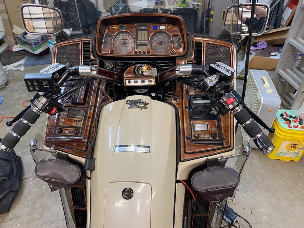

Finally finished🤞 After receiving the replacement module and installing per the directions the same thing happened. I did a little more testing on my end figuring I’ll just make my own module if needed I discovered mating black to red from the module to the grips provided the correct wiring. (The new module also puts out almost double the voltage which is something the engineer mentioned when I spoke with him last week. Something about an updated one which I suppose addresses the lack of heat issue I mentioned in my initial post.). Test ride yet to come, but in the garage they feel nice.

So update on this install. I tweaked grinding out the throttle side housing a little more and had to cut a notch in the clutch side housing for the wiring. After hours of bench testing before I buttoned it up I thought I had it figured out because the grips Just weren’t heating. Turns out I was wrong in thinking the mfg had bad directions. After even more troubleshooting I confirmed there must be a fault in the resistor module as it was the only thing getting hot and only getting .2VDC to the grip side elements. Contacted Avon and so far they’ve been a pleasure to work with. I get the feeling they are a smaller family business. Paid $35 for a replacement module which will be refunded when I turn in the defective one. I think after talking to the engineer he wants to confirm it’s faulty and why and to trend analysis on faults. Should be here Thursday in time for this weekends ride.

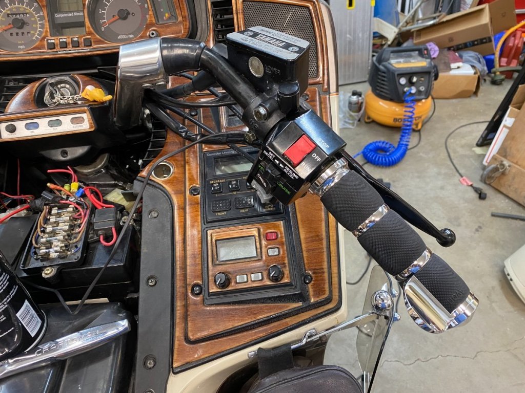

Throttle grip installed just so y’all can see what it looks like. Haven’t decided which side I’m going to mount the control yet.

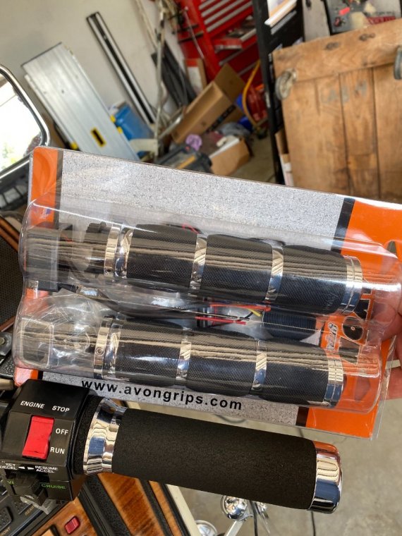

These just showed up. I think they’ll look nice and the heat is just a bonus if they work. For $65 it’s worth a shot.
