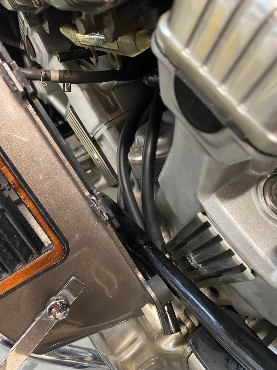

  10. So today while working on a throttle cable issue I discovered oil coming out of these hoses, it’s hard to tell if it’s all or one as they got dirty laying next to each other but I suspect there is one leaking oil that is attached to the breather vent port at the center of the carb bank where the air box connects to from above. Is this a Normal place to have oil come from? Is there a PCV valve or something there?

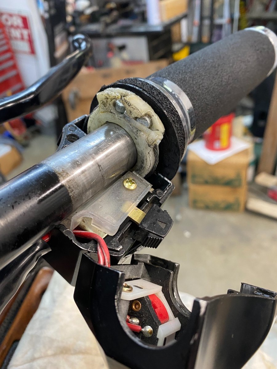

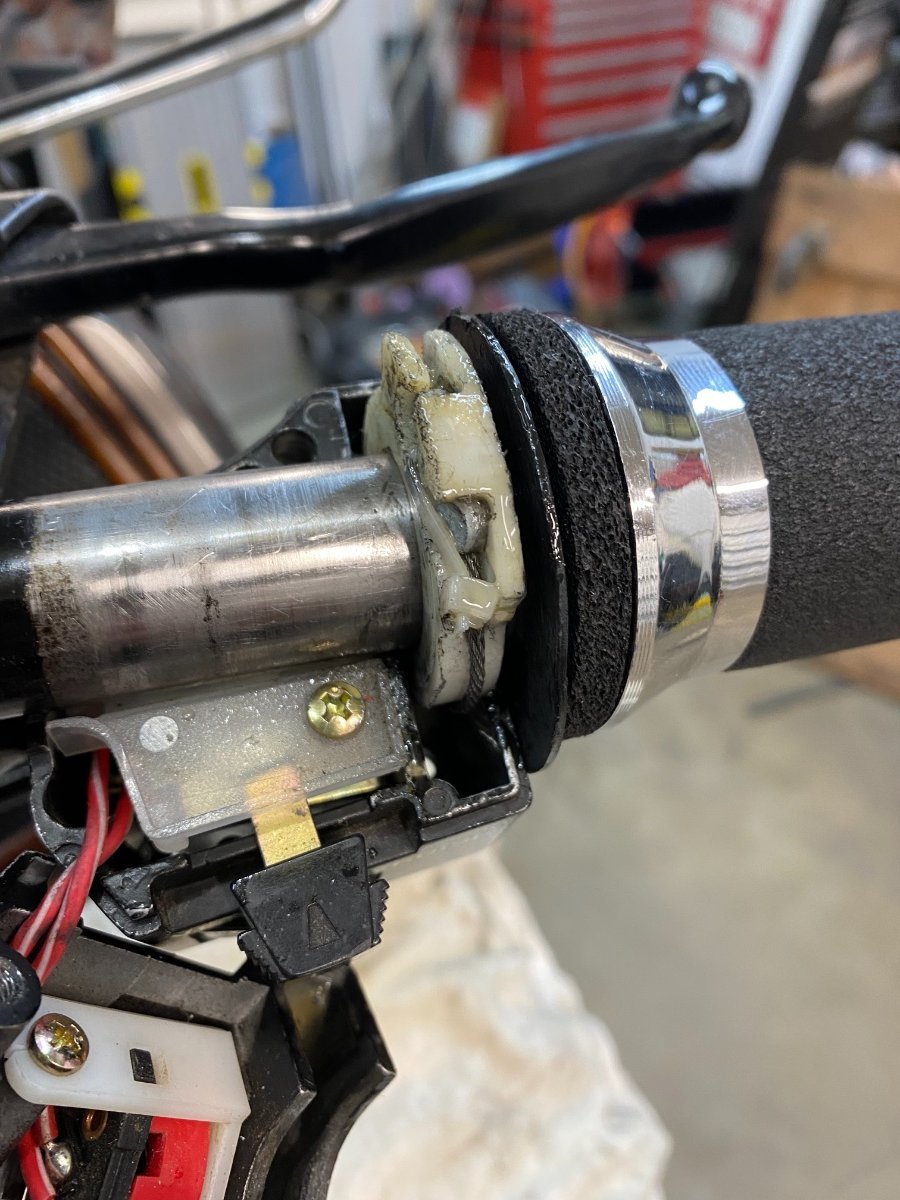

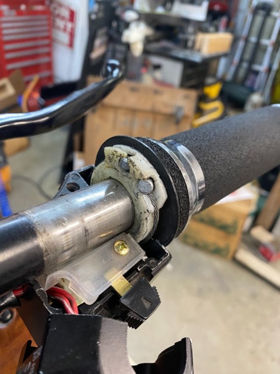

  12. Ok found the problem the white plastic piece finally had enough apparently and the cable was just sitting inside the housing. (Put back in place for the pic.) According to this IPB looks like it’s part of the grip assembly item 19. Or is there an insert I can buy? https://www.youngpowersportslayton.com/oempartfinder#/Yamaha/XVZ13DT_-_1987/HANDLEBAR_CABLE/7f27add3-8aa1-4fc3-ac41-cc44b1eded4d/f86175b4-7082-4ed0-8c30-c8fb2fee8a8b/y

  14. I took a video rather than trying to explain. I’m not sure when this started but I Definitely didn’t notice it this bad before this morning on my way to work. Something to note, a few weeks ago the cables on the right side (not sure which one as wasn’t watching it) caught the head of the cigarette lighter and ripped it apart during a parking lot maneuver. Question is, what part / parts should I be fixing or replacing? IMG_0336.MOV
