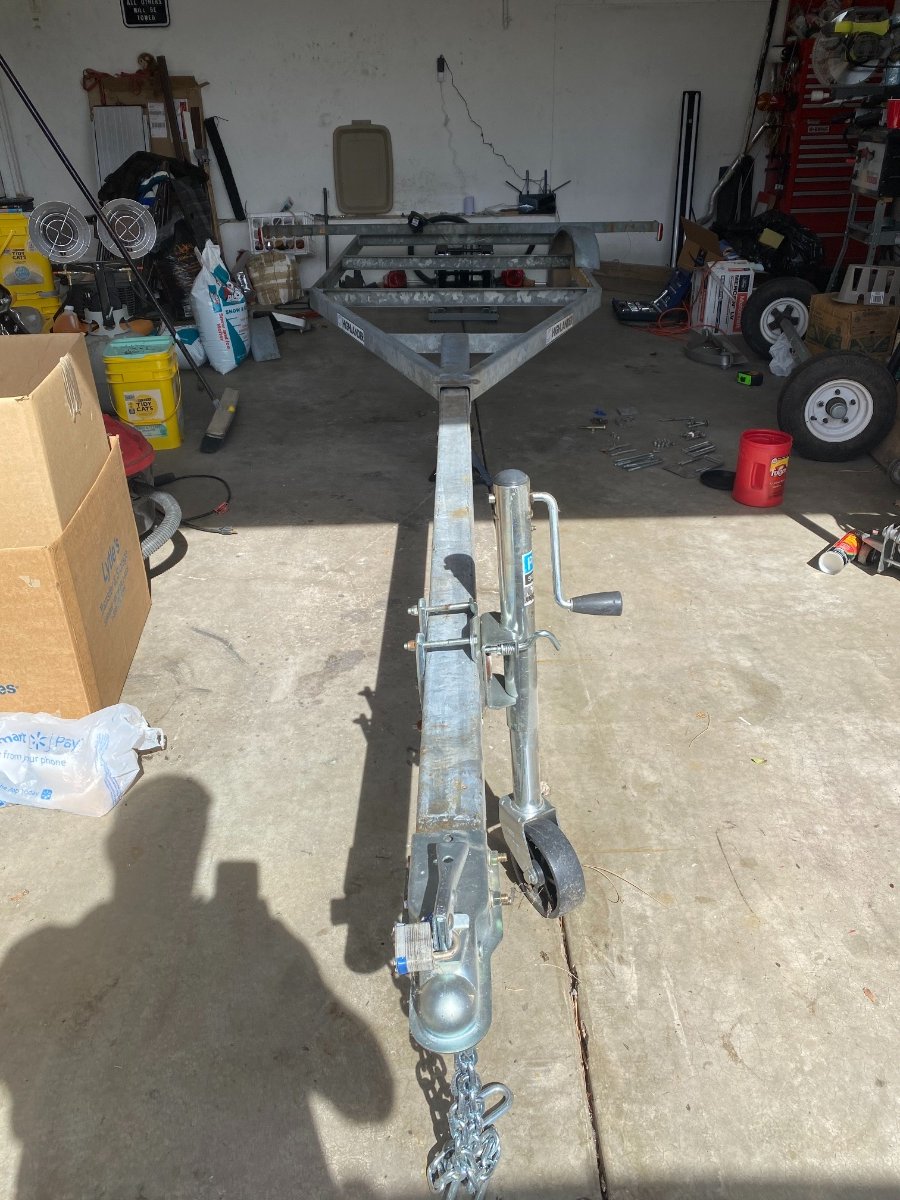

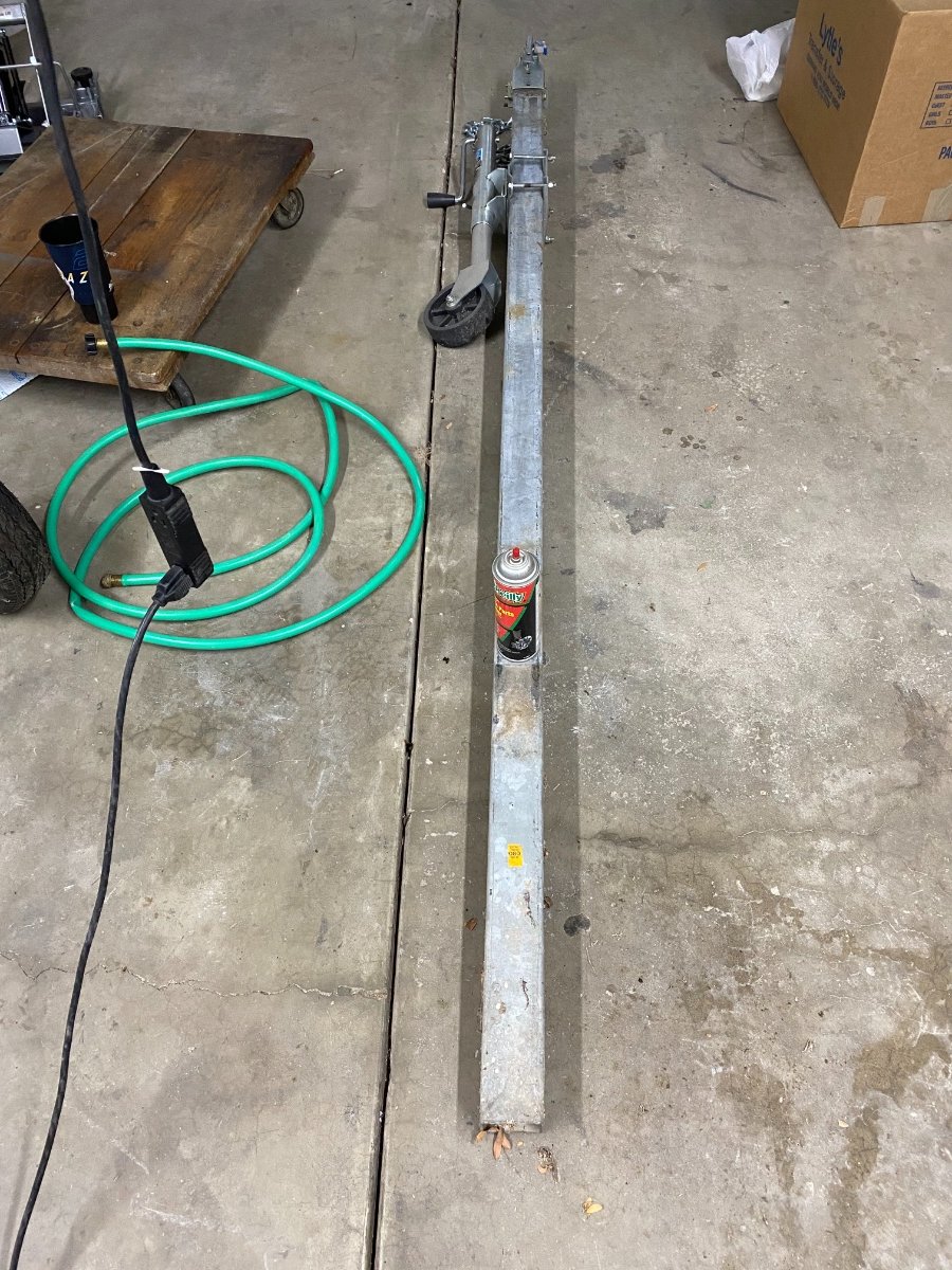

This is what she looks like with the tongue attached. That’s 6’ 4” from the A-frame to the ball. Here’s a link https://trailerparts.com/1-1-2-square-galvanized-axle-1-800-lb-capacity-with-1-spindles.html to the axle with dimensions 57.5” hub to hub. As @Flyinfool mentioned a rule of thumb is 1.5 - 2x axle width from axle to ball. I plan to cut the tongue down in length, curious if there are any suggestions on how far? I’m thinking it might be smarter to get the decking down and wheel chock mounted first to determine axle placement with the intended load. Also thinking about adding a tongue box. https://www.harborfreight.com/2-34-cu-ft-steel-trailer-tongue-box-62253.html I also think I decided on 2x6 Douglas Fir decking. Next I’m gonna have to figure out where to store this thing 😬. She won’t be a big trailer but I already have four vehicles stuffed into our three bay driveway and another on the street with two steeds in the garage. Note: I don’t plan on using that crossmember on the back, the original design had two crossmembers fore and aft where the rollers were mounted for the Hobie hulls. So the axle width sat between the hulls.

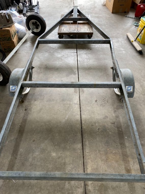

Sorry life happened and everything took a back seat. Remember this was assembled as a Hobie 16 trailer so the tongue is exceptionally long. It measures 8’ total, 2’ of which are inserted into the A frame up to the first cross member. The axle and fender placement are fully adjustable the springs are mounted to a bracket and you just choose which holes you want. hope to get back to it tomorrow. Thanks for the tips, will keep you posted. Initial front to back rail measurements after bending are dead even.
