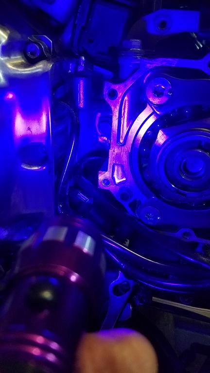

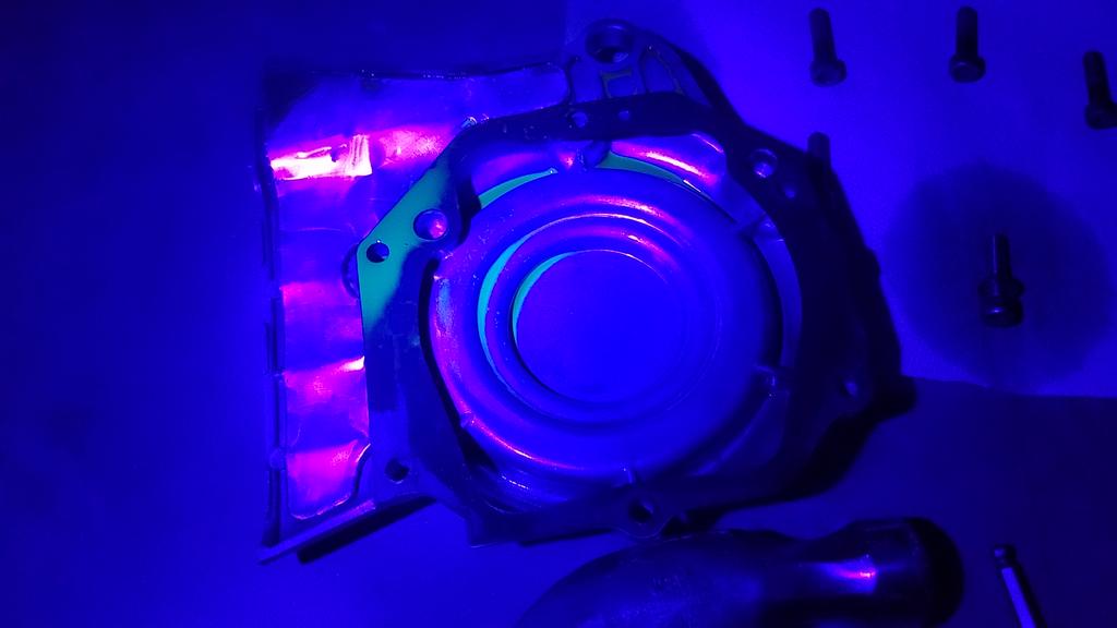

cimmer Posted March 1, 2018 Posted March 1, 2018 Quick question, when taking off the side cover #2 , was there a small brass washer on the bottom bolt? Reason I ask is that there is one there. The bottom bolt can be use to drain the oil out of the transmission and from the look of the Kickstand safety switch, there appears to be some oil on that. More so then anything else I see in the pictures. I dont see much evidence of any major oil leaks on this side of the bike. The stator wires look clean to me and I wouldnt expect them to be your leak and everything else look reasonably clean. Good luck with the search as I am interested in what you find as I need to check out my 89 also.. Rick F.
Marcarl Posted March 1, 2018 Posted March 1, 2018 Unless you did a lot of nice cleaning under those stator wires, they don't look to be an issue, below them though are the position sensor wires, looks like they are ok, but can't really tell from the pictures. Good job all around, carry on.
videoarizona Posted March 1, 2018 Author Posted March 1, 2018 Quick question, when taking off the side cover #2 , was there a small brass washer on the bottom bolt? Reason I ask is that there is one there. The bottom bolt can be use to drain the oil out of the transmission and from the look of the Kickstand safety switch, there appears to be some oil on that. More so then anything else I see in the pictures. I dont see much evidence of any major oil leaks on this side of the bike. The stator wires look clean to me and I wouldnt expect them to be your leak and everything else look reasonably clean. Good luck with the search as I am interested in what you find as I need to check out my 89 also.. Rick F. Yes, Rick...there was the small brass washer under the bottom bolt. I bought a new one and will replace it when she goes back together. What bothers me was the leak was small...but after trips back and forth to Phoenix at 75 mph (2.5 hours), the bottom of the bike on the left side as well as the left muffler would get oil on it. So the high speed was pushing oil out. I would clean area and go for a ride but when home...the whole area would be wet. On the ground after an hour there would be one drop about the size of a quarter. Weird cause I was expecting more on the ground. Regardless, I'm thinking the neutral switch was the leak. It may leak again as it's getting old and that plastic is probably ready to crack. I'll be looking for another switch here just in case... Thanks for the thoughts...
videoarizona Posted March 1, 2018 Author Posted March 1, 2018 (edited) Unless you did a lot of nice cleaning under those stator wires, they don't look to be an issue, below them though are the position sensor wires, looks like they are ok, but can't really tell from the pictures. Good job all around, carry on. Thanks Carl....once the garage warms up a bit I'll go back out and get back to work....32 degrees this morning. Nice! Edited March 1, 2018 by videoarizona add

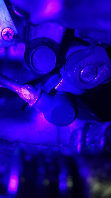

videoarizona Posted April 19, 2018 Author Posted April 19, 2018 UPDATE: OK..back home in GV. Went for a nice fast ride yesterday to stir up the dye in the oil... Took cover 2 off this morning to look for the pesky leak....nothing. No dye visible on the stator wires, the neutral switch assembly, the clutch slave assembly or the shift shaft. General view looking into the area....BTW, WalMart has the UV flashlight, $10 in the fishing department, it's a small Ray O Vac uses 3 AAA batts and is bright. It will go in my road tool kit for sure. Good for bugs and such as well. Shift shaft area is clean as well..... I turned off all the lights in the garage and looked all over the motor. From the valve covers down...including everything in between. The oil/water "twinkie" area between the cylinders is dry as well. One drop of oil was seen under the rubber cover that covers the U-Joint...but I think that came from oil running back. That area is to far back since my drip is right under the area where the slave/stator wires/neutral switch/shift shaft are. Even under the motor...the pan area...is clean. No green dye seen. So...where do I go looking now? I would appreciate any ideas....
cowpuc Posted April 19, 2018 Posted April 19, 2018 Nowhere!! If your light dont show no leaks your all done!!! Put the covers back on er and go find more gorgeous Kodak moments for us out on the open road ya lop eared varmint!! ,,, sneaking down from a seep at the starter:confused24:? Got any oil collecting in the air box that may be working down or a hole in a crankcase breather line?
videoarizona Posted April 19, 2018 Author Posted April 19, 2018 Nowhere!! If your light dont show no leaks your all done!!! Put the covers back on er and go find more gorgeous Kodak moments for us out on the open road ya lop eared varmint!! ,,, sneaking down from a seep at the starter:confused24:? Got any oil collecting in the air box that may be working down or a hole in a crankcase breather line? LOL! Nope didn't see any oil escaping from the starter area. Not overfull either...in fact I'm a tad low as I didn't finish the filling after the oil change a few weeks ago... Wish I was done with this leak...but I'll find it....or someone here will....Grins!
Flyinfool Posted April 19, 2018 Posted April 19, 2018 Just for grins. Point your UV flashlight at the oil sight glass and/or look into the oil fill hole to be sure that the dye is really mixed and doing its thing. Is it possible that you no longer have a leak but there is still oil that leaked before still finding its way out of the nooks and crannies? I agree with @cowpuc, more open road testing and picture taking is required. Jump on that thing and head somewhere.

Flyinfool Posted April 22, 2018 Posted April 22, 2018 You need to do the UV oil leak search while it is still hot from the ride. If you wait a day the oil can drain off the area of the leak enough that there will not be enough dye left at the leak to be visible under the UV light. Now you need to go out for ANOTHER ride and more pics...................
