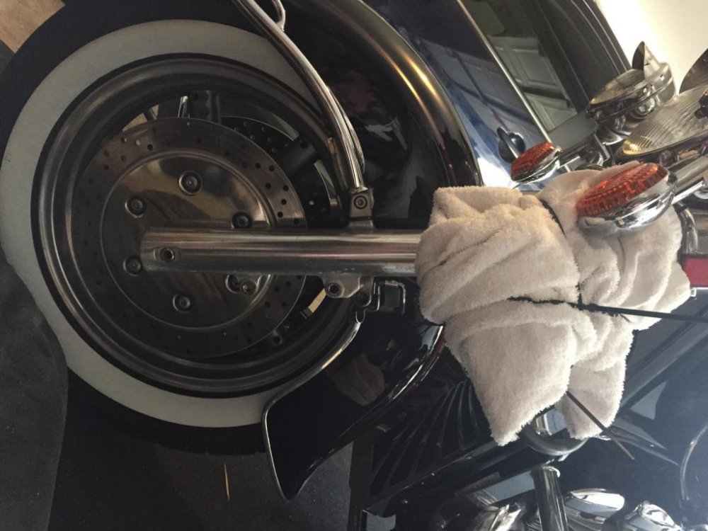

brummers Posted July 7, 2015 Posted July 7, 2015 I just confirmed I had a warped left front rotor on my newly purchased 1997 RS. I would describe the feeling as pulsing, not wobbling. First I inspected both rotors. The left side had a few marks and obvious shiny and dull spots. The right side looked uniform. I took off the left caliper and slid a speed square inbetween the pads. Zip tied it all inplace with a terry cloth towel for padding and hung it from my left passing light. Tested down the street and the pulsing was completely gone. So now to find a good used rotor. I think V-stars rotors will fit, too. My remaining issue is that I can bear down on the front brake (with just the right caliper) and just glide to a stop. I know the stopping power is half with just the right side, but I'm not even compressing the forks. The brake hand lever moves less than half way. It feels super firm and I really cant squeeze it any harder. So I'm thinking I should rebuild the calipers and maybe the master cylinder as well. Any thoughts? ErikB
brummers Posted July 8, 2015 Posted July 8, 2015 (edited) Replaced the left rotor and bled the front brakes and working quite well. Have new kevlar pads on the way. I found two different brands of pads on the right and left sides. The rotor had marring from a screwdriver. I figure this was a brake job gone bad and a screwdriver or similar tool was used in an attempt to push in the caliper cylinders. VStar front rotors are the same as the RS. I borrowed one off my 2001 650 Vstar Custom, but also checked a friends 1100 Vstar and a roadstar. All these front rotors are exactly the same. Roadstars also have the hub covers. Good to know for ebay hunters. Not sure about the rear rotors. Edited July 8, 2015 by brummers updated cause of problem
