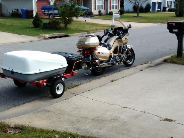

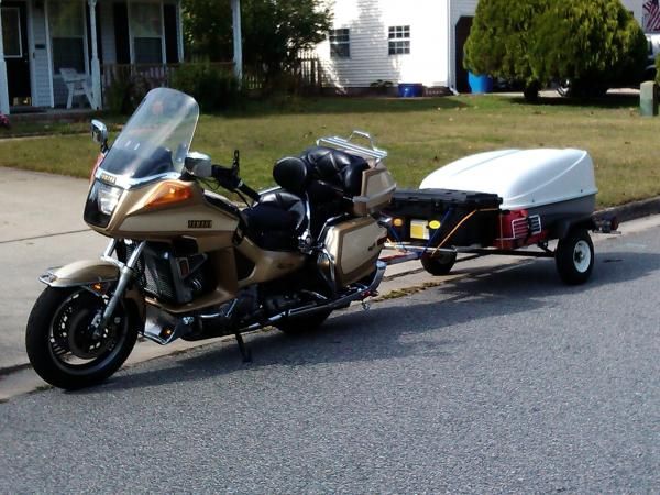

quick pix still working on her. Ok here are more pix. She handles fine a 45MPH and below I loaded it with 150lbs of sandbags & the tongue wt was 42lb. This is with the generator in the front box. the tires were at 20 psi. The swivel hitch makes a BIG difference. I have to keep checking to make sure the trailer was till there.

Did more work today on the HF Mini. I welded in a 1x1 box steel under the front of the cooler rack for stability & I also welded the back of the rail to the trailer. The generator fit real nice in the cooler rack box. I made a side carrier to be able to haul a 1 gallon gas can just in front of the driver side tire. To hold the box in & add extra rigidity, I used 2 lengths of 2x6 pressure treated wood. The biggest pain was I needed to replace the carriage bolts that mount the box to the trailer as they were 1" too short. I go to Home Depot but they don't have metric carriage bolts. What I did was buy 1/4" x 3 1/2 stainless carriage bolts & I use my tap & die set to re thread the original metric hold down knobs to 1/4" 20 course. Now I can attach my cargo net to them without having to add extra eyebolts. I also put in an edge trim on the carrier top as well as a new weather seal on the box. The old one was crumbling. My swivel hitch arrives tomorrow so I'll be able to take her for a test drive probably Thursday to see how she tracks. Then I'll weld the trailer up if it passes snuff. I did pull the extra springs off since I decided to just use this behind the bike. I'll take pix tomorrow since it got dark on me here & my hands are KILLING ME! It sucks getting old!
The 40" is from coupler center to front face of frame. I just remeasured. Right now the distance from the axle center to center coupler 65". That puts me a 1.625. Just barely above the 1.5 margin. Welding in a longer tongue would not be a problem if needed. I will have to load & test run it down the highway & check
Yeah, I repacked the bearings with high temp, IDK what they were using but it looked like Vaseline! As far as the tongue, I did get 13" extention by moving the center brace up towards the front. The tongue is now 40" long. I haven't tested it yet as my swivel hitch is in transit. I need the width since the cartop carrier is 38" wide. Worst case I will add another 6" or so. What about wheel balancing? Has anyone found they needed to be done?

After I posted, I gave it some more thought, and I came to the same conclusion. I did reposition the drawer bar, it is now 13.5" longer than stock. Overall length is 40" from the front edge of the trailer. I have already reduced the springpacks to remedy the bouncing. By reducing them, the weight capacity will be GREATLY diminished. So this trailer will NEVER haul my MK1 Brian, I'm 30 years past ignoring sound advice (lol) I've found that you guys have "been there, done that" . That is the main reason I bounce my projects here. Thanks for the heads up, Looks like I will revert to my original idea od getting a 16' dual axle trailer that will be able to haul both bikes when we move to Tenn.
Well I went & did it. I picked up the HF mini trailer yesterday. With coupons & sales it came to $143. I spent most of this afternoon putting it together & cursing Chinese manufacturing. In general the components are good. Some of the Bolts & nuts are not machined properly. I had to use my tap & die set waaayy too much today. Getting it squared was fun as well. Once everything was true I retightened eveything with my impact gun. (I will be stick welding it as well. Although it's sold as an 870lbs capacity trailer, it is rated at 1060 max load. My intention is to make this a multi use trailer (if needed). I can add a floor & sides to haul stuff, & I do have a 5/8 " steel U rail that can be placed on it to haul my VR in case of an emergency (get home short hop) since the VR is 911LBS. But for the most part it will be a tag along for me to pull behind my Gen1. Tomorrow I have fenders & wiring to do as well as add the 18cu ft rooftop cargo carrier. I aslo have the swivel hitch to mount on the VR. Here's where I stand so far. http://www.venturerider.org/forum/album.php?albumid=1121&pictureid=7122 Now I'M TIRED!!!! http://3.bp.blogspot.com/_dbnCgEZBVp0/SaOx9_Rie1I/AAAAAAAAAec/YPQWJ4aKBkw/s320/tired+smiley.bmp.jpg
