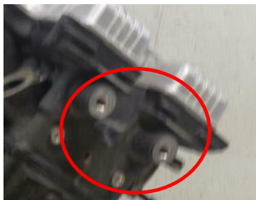

07 Venture ‘Drive Pully’?
M61A1MECH replied to craigatcsi's topic in Royal Star Venture Tech Talk ('99 - '13)
The two top bolts have had their heads drilled off, the one lower left has been sheared off, maybe during an attempt to remove it. The remaining bolt has the punch mark from where it was staked when assembled. I wonder where the top retainer plate is? Those bolt have loctite on them so naturally will be hard to remove. I have never seen this issue before, the will certainly need to carefully drill them out and maybe put a helicoil or timesert in there if they damage the threads. http://www.timesert.com/ -
