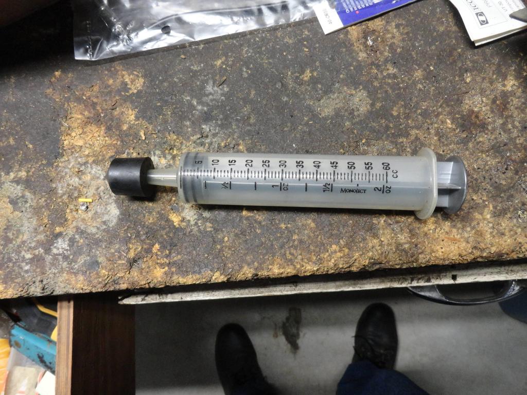

To fill the rear brake fluid reservoir, I use a turkey baster. They're available everywhere (Wally World etc) and I mark the bulb 'Brake Fluid' to keep it from getting used for something else. Cheap and it works great. When I was on the road and my brake warning segment of the display lit up, I picked up a small container of brake fluid and the small fluid applicator that I found next to the turkey basters at WallyWorld. -
