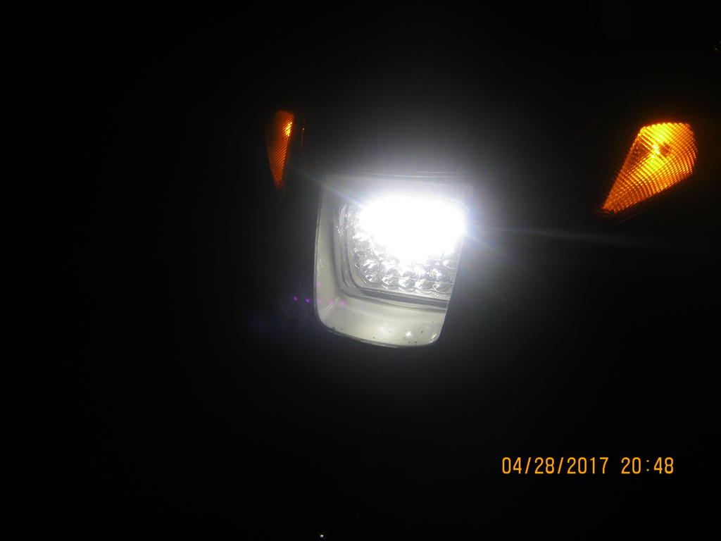

As I said a dark alley, well Tinker and me didn't care for it as it was wet, muddy and slick. So I rode out by my buddies house and pulled off the side of the road, here is a car passing best I could do for side by side comparison, keep in mind I have only one light. This is dim it has 6 leds lit up This on dim Did the best I could here but off to my left on the road is a car about lined up with me, I have my light aimed down a little more just so I don't blind someone coming at me. -

It will blind you when you look at the bike even in the daytime, But yes a heck of alot better then the stock did, Even with Led in mine it did better then stock it just would not aim right, Basically seemed I was just brightening the space I could already see. So was chatting with Bongo and Fool one night and fool said something along the lines of the light will probably not work right unless it was in housing made for LED So i got this light, interesting enuff I could not get it to seat all the way back just trying to figure out a way to maybe rig an actual pan in there for the light and still allow me to adjust it, as of right now I have it modified enuff to be able to adjust. But it was also supposedly a 5x7 light.. But to answer your question on a very dark road out in the country it does its best work even on low beams. I just used the plug off the RLU and cut it about an inch from the plug and twisted the wire together, sodered it and heat shrink tubed it. Plugged it in to the existing plug and had my jumper plus if I chose to I would just go back to stock.. If it isn't raining tonight and is dry I will go down the dark alley across the street and get a couple pictures. -

All I got to say it was a pain for me, But well worth it I can see just as good as I do with my Tahoe. If his lights will fit right in there I will be kicking myself because I did some modifying to get my headlight to fit. I still have the stock bulb with the LED in it but I wanted to try a headlight that was made for LED. -
