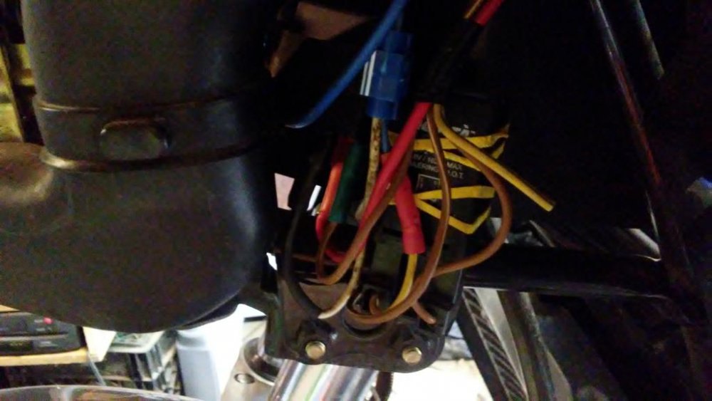

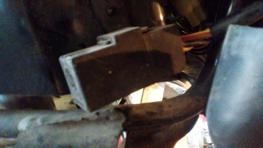

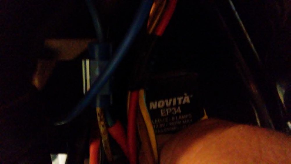

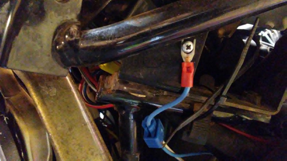

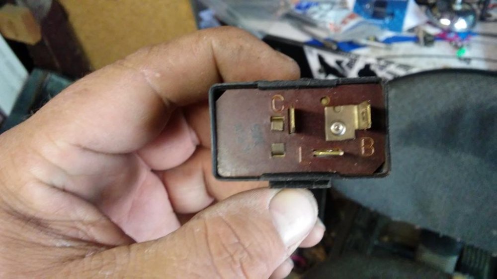

MattK I will apologize first off by giving you the wrong part number for the flasher unit, I will also state when you use this flasher you should not need any resistors. I sound aggravated in the video is because I had to make the silly thing 4 times before my camera would aim right... and focus like I wanted it to. This is the wire ground I have running I have no Resistors The Wire that originally ran over to the cancelling unit from the OEM Flasher is Yellow with a green stripe. The B is for battery and the L is for Lights and the C is for Cancelling unit . This is how the EP34 Flasher, This is My ground Wire I have running for both flashers, I think i should loctite this guys because it has came loose twice on me. Cancelling unit Location I did nothing here just showing where it is It is located behind the Right hand Fairing on the inner plastic piece that runs around the Neck. -
