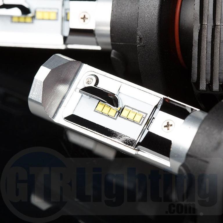

Also, what turns me off is there is no provision for blocking off the low beam....so the LED is relying on the lens to do that and that probably won't work. If you look at quality LED bulbs for auto use, the low bean LEDs have a piece of metal blocking off the light so it throws a flat pattern out to the horizon. The Broviews a number of us bought has that as well as the recent post that showed a picture of the bulb cutoff. I've included a picture of the cut off plate. DO NOT BUY these as they are not for us.... Hope this helps

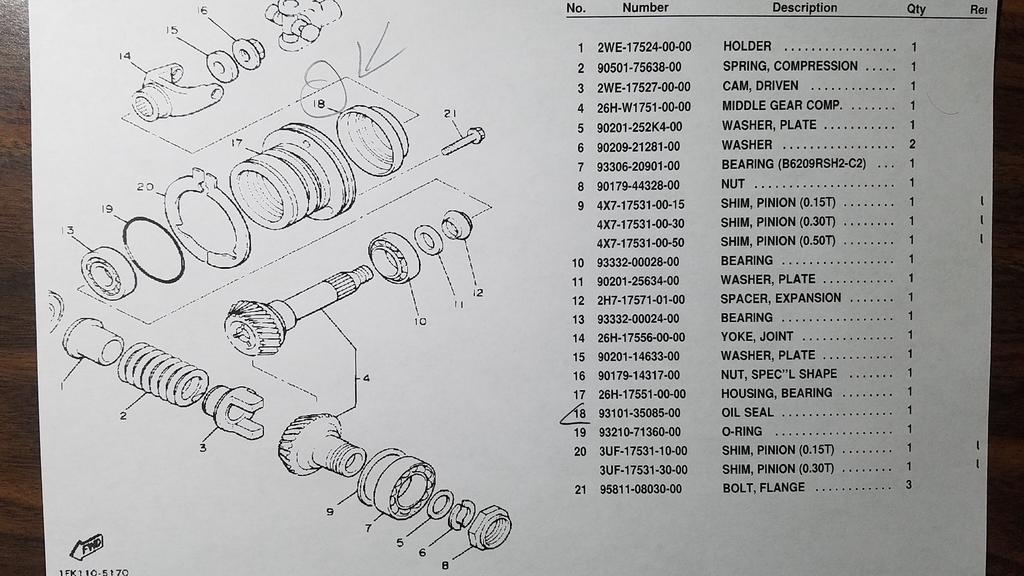

Well spent more time under the scoot looking with the blacklight. Nothing in the normal areas. Another drop seen on the bottom of the rubber dust cover over the u-joint. Looking more carefully, it "could" be the oil seal just before the u-joint. Part #18 (93101-35085-00) on parts page D1 (37 or 112) Follow my thinking...if the oil drips out of that seal, it will run out the dust cover and drip onto the frame rail. It will flow back to the left exhaust pipe and onto the left saddlebag...which does get oil on it during a run. At rest, it will run down the left side rail to the lowest point...which is forward... under the area where the neutral switch/stator wires/shift shaft are. My only problem with this argument, is you would also think the oil would run out the back of the dust cover and to the rear... along the swing arm that encloses the drive shaft. But it's dry as a bone! So more confusion...I don't see how it could leak without blowing oil back along the swing arm/drive shaft side. The area of normal contention, neutral switch/stator wires is dry except for one engine bolt that faces into the block from left to right. It has a drop of oil on the bottom of the head. It's tight so I can't think of why that would leak. Don't want to crank down on it since I can't find it on the parts pdf... No cracks. No obvious issues other than the leak...which is slightly worse now than 2 weeks ago. 3 drops instead of 1 small one. Guess I'll just keep on riding and watch the oil level. Something is bound to show up at some point that makes sense....
