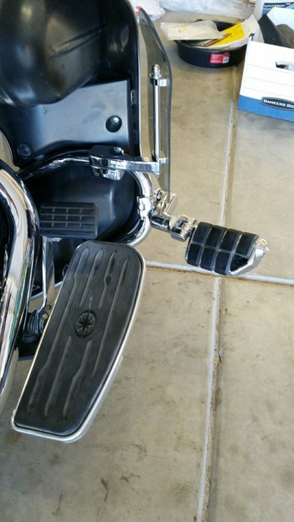

	  New RSV Rider - Saddle problemsvideoarizona replied to Hoytcanon's topic in Royal Star Venture Tech Talk ('99 - '13) Don't know about Rick, but a message to him through this forum would be appropriate. He did my VStar seat and did a great job! As far as seats, the normal pillow seat would be the best bet for you. All the others, push you forward...includes Mustang, Corbin, etc.. It's also quite comfortable. I'm 225 and 5'10" and can go all day on it. Your pegs could use some extensions....as you can see on my RSV, I have mine adjusted rearward. By just moving the mount 180 degrees I could gain about 4 more inches. Hope this helps....

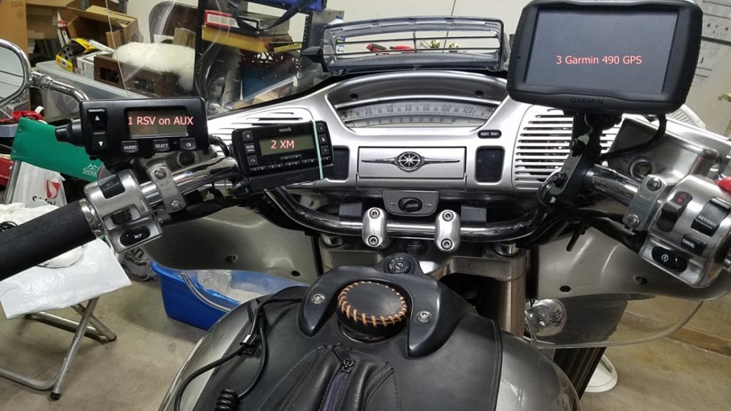

	I too went with a wire. BUT, I added a "Y" connector under the front fairing that splits the Aux input into 2 sources. I then added XM radio and Garmin gps. The gps had an sd card slot. I loaded that with a couple of thousand oldies from my collection. So now I have radio, tape deck, XM and the gps all available to listen to.
