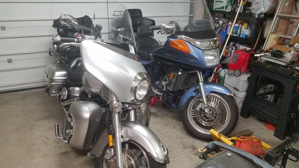

	Love my Clearviews on both Ventures! Far better than stock. Regarding lights. Can't help with the Daymaker kits. Looked like to much work for me. I installed led bulbs. Made sure they had the low beam cut off. Works fine. Got 2 bulbs and put one each scoot. I understand now the bulbs are built to mimic a regular bulb so beam pattern is better. 2 pics below... I think the beam pattern on mine is fine. My bulbs are no longer made(2years ago). But if you go with a reputable dealer, you will be fine.
