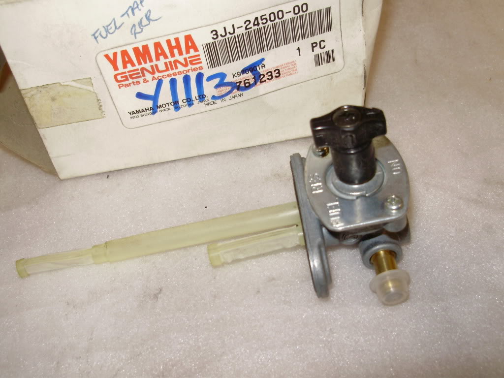

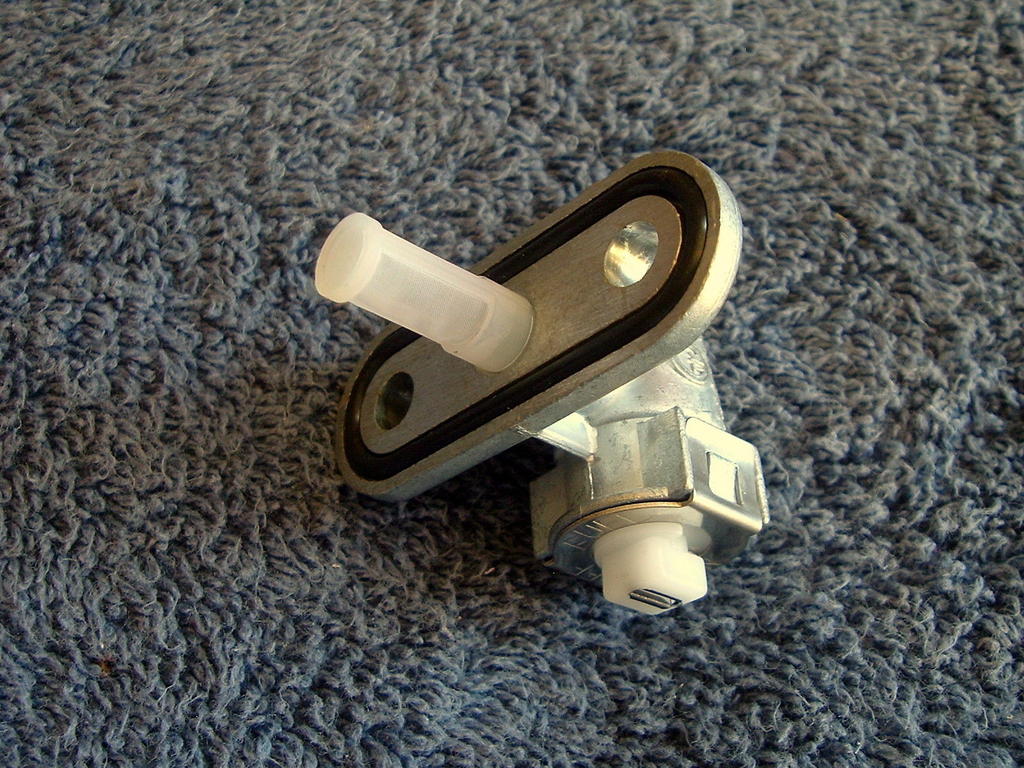

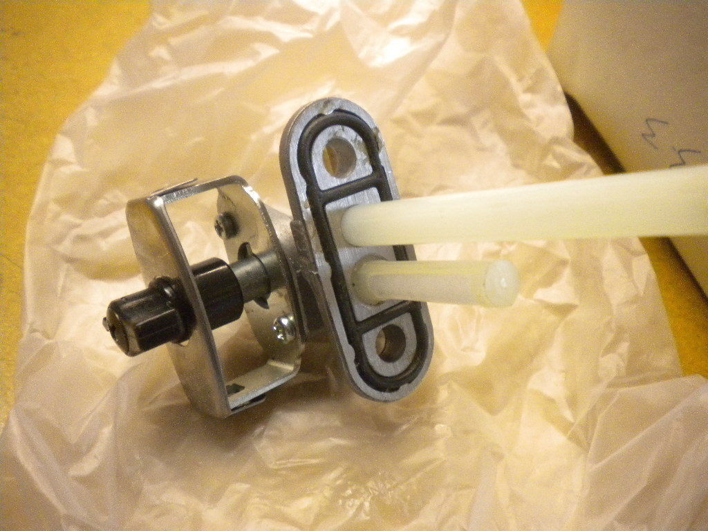

26H petcock 1b.jpg1983 had no reserve and a tool (screwdriver or wrench) was required to turn the petcock on or off.
41R petcock.JPGStarting with the 1984, a reserve and a hand turnable knob was incorporated.
3JJ fuel petcock.jpgThe 1990 and newer petcock was changed to have the fuel outlet on the left side of the valve. (I have no idea why the change).
All three petcocks will bolt onto any year fuel tank, though fuel hose and routing may need to be changed. Also, if a 1984 or later petcock is used on a 1983, the right side cover will require a notch to clear the knob.

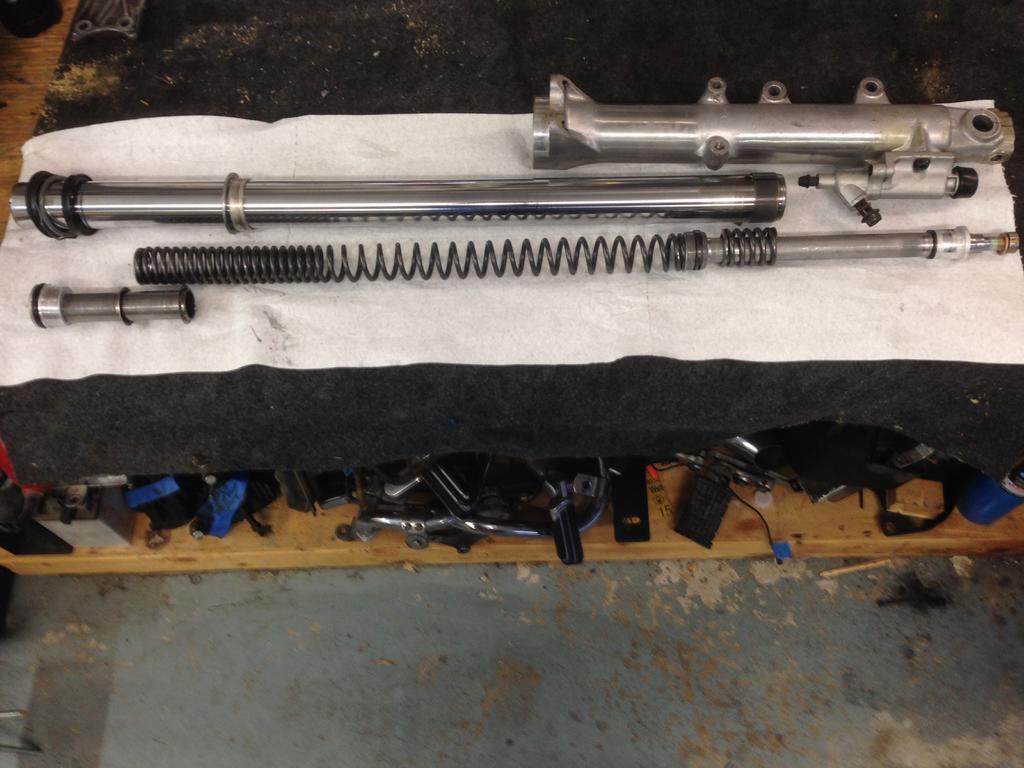

Update! Currently rebuilding forks. I really wanted to get this bike ready to ride this summer but , not going to happen. I have another vacation scheduled in a week and have been watching hrs and hrs of Wimbledon too. Not to worry, take my time and enjoy the experience.
more pics on the way.
