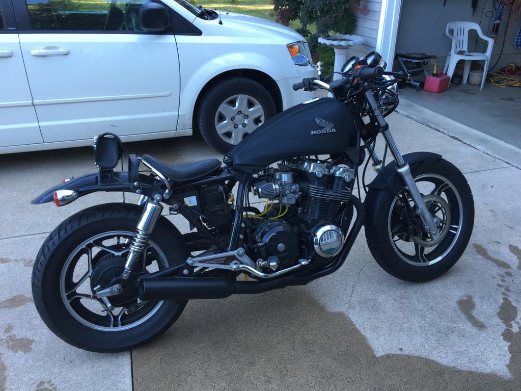

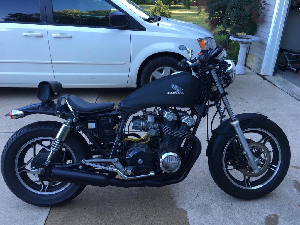

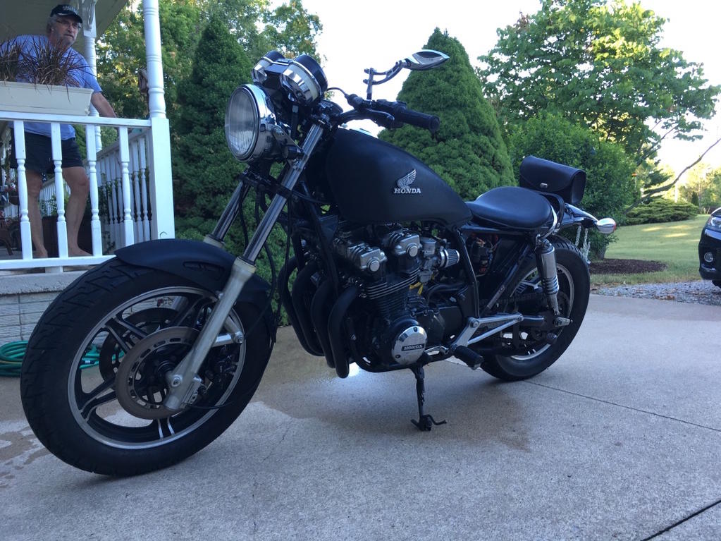

So yesterday Dylan and I started making his bike "his" bike. Still a lot to do but we made some progress. He decided that he wanted it done in flat black. I hate trying to paint flat black because I always have trouble getting it right. From a distance though, it turned out ok. I'm not 100% happy though so may wet sand and try it again. He also sprayed the gold tank emblems and then sanded the raised area so that they are silver. I think he did a good job with that. I still have to fabricate some type of side covers. It's an old bike but it is the look that he wants and I think it will turn out ok.
Looks to be about an '82, don't know whether it's a 650 or 750. I had a bunch of the 650SC and 700S models over the years and found them to be as reliable as a 1st gen VR. Be very careful, you may ride it some and begin to like it.........a lot.......
I'm not happy with the paint. We prepped it very well. Down to bare metal then multiple standings and a final wet sanding. Very smooth. Then three coats of primer and another wet sanding before doing the flat black. The texture is rough. After the wet sanding, the primed surface was smooth as glass. Four coats of the flat black and now it is almost like a 400 grit sandpaper. Will be easy to mar and scratch much less trying to keep clean. I'm thinking that we should have gone with a regular black and then used a matt clear to achieve the flat look.
How about it those of you with some painting experience. What is the best way to get the look that he is after? Flat black but a smoother finish in my opinion would be better.
In the pics it looks pretty cool!! Neat lookin little Bobber! I am no paint and body man, but I wonder if a couple coats of matt clear and then wetsand would smooth it out?

The auto custom paint guy I got my paint from warned me not to make the surface to smooth as the auto type paint doesn't stick very well to a really smooth surface. Suggested I sand to no more than 800 grit. (I had used 1500 for final).
Though if your primer looked smooth, your finish coat should have been as well. Humidity get in the way??

I don't think there was a problem with humidity or temperatures. Nothing like that. I think that flat black just behaves this way but I could be wrong. I may wet sand it all back down and then spray it with perhaps a matt black instead of flat. Or even a glossing black and then a matt clear. Still researching it.

That would probably be the best thing to do. He called a small local body shop here and asked what they would charge to paint just the tank and front fender. They quoted him $250.00. YIKES!!! I thought that was a bit steep so we decided to try it ourselves. From what little I've researched on the web and YouTube though, I'm not the only one who has a problem with flat black.
Not a paint guy wither. But my experience (although on race cars) is any of the flats need a "sealer" coat. I think the matte coat is probably the way to go. As mentioned if gas gets on the flat its going to leave a stain.
