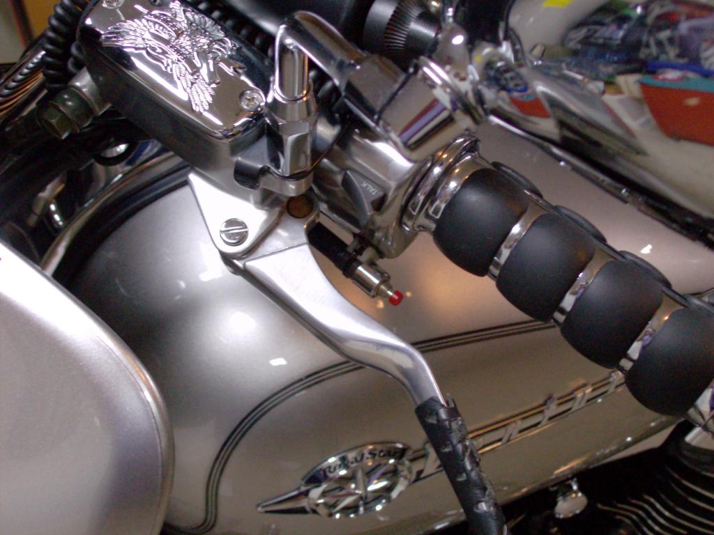

Eck Posted May 17, 2016 Posted May 17, 2016 I took the chrome top / cap off an ink pen. Drilled the hole a little larger to match the diameter if a mini push button switch. I then wired up the mini switch and slid it into the ink pen chrome top piece. The wires were about 2ft long. I then filled the chrome top piece with black RTV to make it water proof. The mini switch was then mounted on the left handle bar just in front of clutch lever (see attached Pic- Ref: RED button switch) I took a mini garage door opener and snapped it apart and soldered the 2 wires from my mini switch to the circuit board with the 2 wires that go to the garage door opener switch. I used the hot soldering iron and melted a very small hole in the garage door opener providing access for the 2 wires and the plastic case could snap back together. I used black RTV inside and on th eoutside fo the garage door opener around the two wires making it water proof. Using Velcro, I mounted the garage door opened on the inside of the fairing on the left side just above the 12 volt accessory supply. Even in the rain or washing the bike I never had an issue with it. See attached pic of mini switch made from chrome ink pen cap.
videoarizona Posted May 18, 2016 Posted May 18, 2016 Naturally...I have a gazillion pens and not one has a chrome top like Eck's that I can rob to use for my opener. Grr... Well..on the shopping list. Great idea, Eck!
