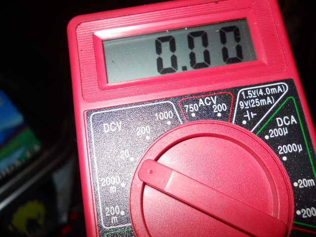

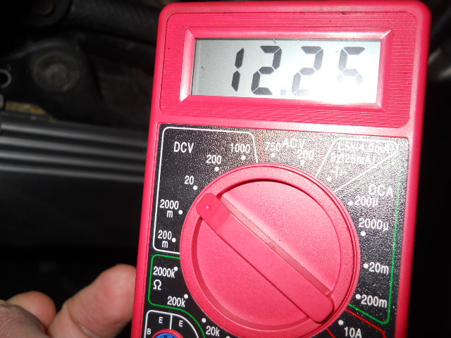

cowpuc Posted December 23, 2015 Posted December 23, 2015 (edited) Thanks Puc. Sure send me the info. I will have to buy one and then figure what to touch with it. Haha. oops not that I guess Here ya go Dave, this is the one I pack. Pretty simple to use really. In the link = Move the enlargement slide under the pic over so you get a good view. Move the pic around so you can see the bottom right of the meter. See where it shows the plug ins for meter leads? You put the black one in the "Com" hole and the red lead into the "V - ohm (represented by an upside down horseshoe) - mA" hole right above it. Rotate the dial around to "20" on the scale in the DCV category. Move the "Off - On" switch over to the On position and the digital readout on the meter should show a 0 (going by memory here). Now touch the red (+) lead on a battery's positive (+) post and the black (-) on a batterys negative (-) post and what ever voltage the battery contains will appear on the meter. For kicks you could play with a small flashlight battery, look at the side of it, probably read 1.5 volts on the battery, locate the + and the - ends of the battery, touch the leads accordingly and it should read read 1.5. Using your bike battery should show around 12 volts. Thing to remember is this does not necessarily show battery condition because what you are reading is voltage, not amperage (your not putting much of a load, if any, on the battery with this little meter) - BUT it is displaying what voltage is available and that is what your looking for. After ya get done playing with the meter and you wanna get down to work ya gotta figure out a way to connect the leads to the battery on the bike or your gonna need an extra set of hands cause your gonna want to raise the rpm (rev it a little) on the scoot so you can watch the meter rise as the r's come up. You should be able to wedge the pointers of the leads under the connectors on the + and - posts on the battery - I usually am able to do this. Use to be Radio Shack carried cheapy little alligator clamps that slid on the end of the meter probes but Radio Shack went under a couple years ago:8: and not sure where you will find them now - maybe an auto parts store - those work good to if you cant find a way to wedge the probes in. Dont have to worry much about getting the probes chris-crossed - if that happens you will just get a negative reading on the meter - the biggest thing is to remember to operate the meter in the range (the 20 volt marking is good for up to 20 volts) and choose AC or DC current properly (if your gonna play with house current or current directly from the stator on your bike you will need AC). Remember if your fooling with house current (120 Volt AC) it WILL poke ya pretty good if ya get ahold of it). Playing with 12 volts DC on the bikes is very safe as long as ya dont short out the wiring on the scoot and start a fire or something:doh: So ya start the bike with the meter attached or start it with a friend standing there to turn the throttle a little for you, idling you touch the leads to the prospective posts on the battery and say you have 11.8 volts on the meter, a touch of the throttle and it should rise to like 13.8 or 14.5.. This is good!! If it doesnt rise you got problem in the charging system somewhere. Dont throw the little meter away even if you get good readings:D, you will find it handy for diagnosing all kinds of fun stuff:178: - can be used for ohming out the stator or even checking switches and finding bad wires if you should be inclined to run into one:no-no-no:. Besides, having your own meter is a lot like having your own jack knife:happy34: and guess what - border patrol people dont look at meters like its a weapon like they do jack knives = you get to show off your :Cartoon_397:ness and can come visit us for Hot Dogs without worry about bad boys like @ragtop69gs or some of our other buddies when crossing that :usa:/:canada:border !! Here is a link to the meter I carry on my scoot,, looky looky its only 4 dollars online. Just got my latest Harbor flyer and they are 5.99 in there (same meter). Not sure what thats all about - :confused24:if Harbor would sell in store for online prices.. http://www.harborfreight.com/7-function-digital-multimeter-69096.html ****On a side note, usually I can tell whether or not my scoot is charging properly just by watching the headlight (easiest at night), let the bike idle - watch the light beam as I rev it a little - it will brighten slightly as I rev the motor and will stay brighter if I hold it at the higher R's. Reason for that is that most 12 volts batteries put out around 12 volts if they are any good. Like I said in my thesis, the system will usually show 13.8 volts or slightly higher when spinning up - that voltage difference will also show up in your lights being slightly brighter - make sense? not hooked to battery Hooked to battery.. Edited December 23, 2015 by cowpuc
cowpuc Posted December 23, 2015 Posted December 23, 2015 PMJI, http://www.harborfreight.com/7-function-digital-multimeter-90899.html I think this is what the Pucster was referring to.... Here ya go Dave, this is the one I pack. Pretty simple to use really. In the link = Move the enlargement slide under the pic over so you get a good view. Move the pic around so you can see the bottom right of the meter. See where it shows the plug ins for meter leads? You put the black one in the "Com" hole and the red lead into the "V - ohm (represented by an upside down horseshoe) - mA" hole right above it. Rotate the dial around to "20" on the scale in the DCV category. Move the "Off - On" switch over to the On position and the digital readout on the meter should show a 0 (going by memory here). Now touch the red (+) lead on a battery's positive (+) post and the black (-) on a batterys negative (-) post and what ever voltage the battery contains will appear on the meter. For kicks you could play with a small flashlight battery, look at the side of it, probably read 1.5 volts on the battery, locate the + and the - ends of the battery, touch the leads accordingly and it should read read 1.5. Using your bike battery should show around 12 volts. Thing to remember is this does not necessarily show battery condition because what you are reading is voltage, not amperage (your not putting much of a load, if any, on the battery with this little meter) - BUT it is displaying what voltage is available and that is what your looking for. After ya get done playing with the meter and you wanna get down to work ya gotta figure out a way to connect the leads to the battery on the bike or your gonna need an extra set of hands cause your gonna want to raise the rpm (rev it a little) on the scoot so you can watch the meter rise as the r's come up. You should be able to wedge the pointers of the leads under the connectors on the + and - posts on the battery - I usually am able to do this. Use to be Radio Shack carried cheapy little alligator clamps that slid on the end of the meter probes but Radio Shack went under a couple years ago:8: and not sure where you will find them now - maybe an auto parts store - those work good to if you cant find a way to wedge the probes in. Dont have to worry much about getting the probes chris-crossed - if that happens you will just get a negative reading on the meter - the biggest thing is to remember to operate the meter in the range (the 20 volt marking is good for up to 20 volts) and choose AC or DC current properly (if your gonna play with house current or current directly from the stator on your bike you will need AC). Remember if your fooling with house current (120 Volt AC) it WILL poke ya pretty good if ya get ahold of it). Playing with 12 volts DC on the bikes is very safe as long as ya dont short out the wiring on the scoot and start a fire or something:doh: So ya start the bike with the meter attached or start it with a friend standing there to turn the throttle a little for you, idling you touch the leads to the prospective posts on the battery and say you have 11.8 volts on the meter, a touch of the throttle and it should rise to like 13.8 or 14.5.. This is good!! If it doesnt rise you got problem in the charging system somewhere. Dont throw the little meter away even if you get good readings:D, you will find it handy for diagnosing all kinds of fun stuff:178: - can be used for ohming out the stator or even checking switches and finding bad wires if you should be inclined to run into one:no-no-no:. Besides, having your own meter is a lot like having your own jack knife:happy34: and guess what - border patrol people dont look at meters like its a weapon like they do jack knives = you get to show off your :Cartoon_397:ness and can come visit us for Hot Dogs without worry about bad boys like @ragtop69gs or some of our other buddies when crossing that :usa:/:canada:border !! Here is a link to the meter I carry on my scoot,, looky looky its only 4 dollars online. Just got my latest Harbor flyer and they are 5.99 in there (same meter). Not sure what thats all about - :confused24:if Harbor would sell in store for online prices.. http://www.harborfreight.com/7-function-digital-multimeter-69096.html ****On a side note, usually I can tell whether or not my scoot is charging properly just by watching the headlight (easiest at night), let the bike idle - watch the light beam as I rev it a little - it will brighten slightly as I rev the motor and will stay brighter if I hold it at the higher R's. Reason for that is that most 12 volts batteries put out around 12 volts if they are any good. Like I said in my thesis, the system will usually show 13.8 volts or slightly higher when spinning up - that voltage difference will also show up in your lights being slightly brighter - make sense? not hooked to battery Hooked to battery.. @dogman, notice the post time differences between VideoAZ and the ol Pucster,,,, :think:sometimes I might talk/type to much,, funny cause most of my teachers made that observation and made that same comment,, :scratchchin:even in College
