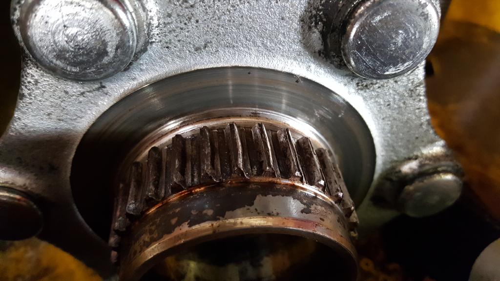

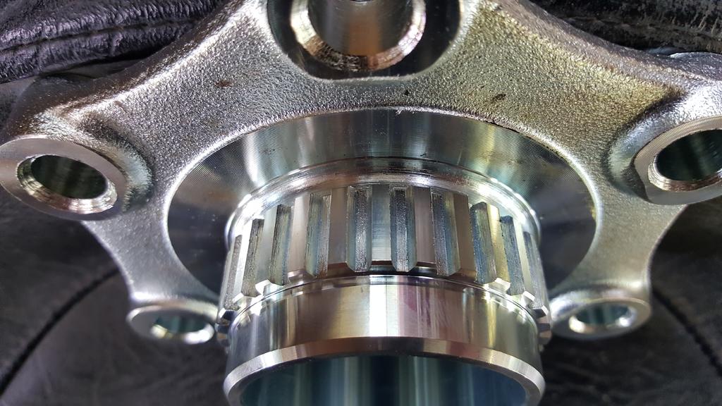

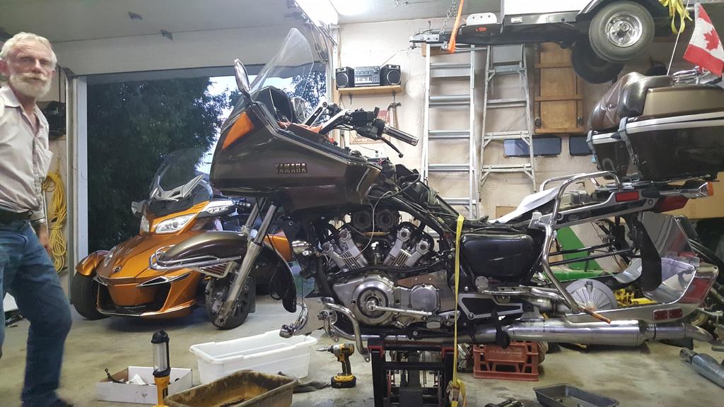

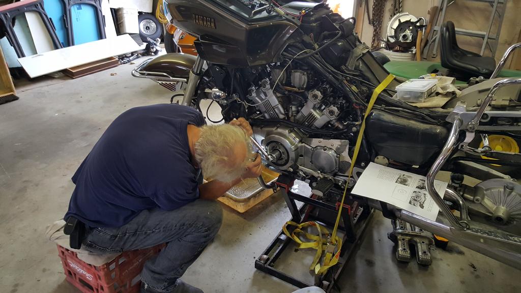

Midicat Posted September 12, 2016 Posted September 12, 2016 (edited) Well, after a 45 min ride in a storm that threw cats and dogs at me and pelted the tops of my cheeks until they were red, I arrived at Carl's thinkin "so we'll change the brake fluid, go get new tires, replace the valve cover gaskets, and lube the pumpkin up good and i'll be on my way." Nothing could have been further from the truth. Not 10 min after my arrival, Carl says to me "how you getting home? Your not expecting to drive this home today are you?" It didn't take long for me to get a really good understanding of where those questions came from. Pulled the tires, splines on the back tire were finished. This is what they should look like. Then Ben shows up and takes off the valve covers to address the gaskets. Well, of course we need to check the gaps and shim any valves that require attention. Valve cover gaskets, and new bolt washers have been ordered. New diaphragms as well. Now, let's talk about the brakes. You know, it makes no sense to change the brake fluid if you aren't sure that the calipers are working properly. So off they come. Three calipers, six stubborn pistons later, they are off and cleaned. New seals have been ordered. At this point it makes perfect sense to decide if you want to delink the brakes, and if your going to do that, you might as well order stainless steel lines because those 31 yr old lines are robbing you of braking power. We are delinking and custom stainless lines will be ordered. When I pulled up at 9:30am, I thought I was going to be out by 4:00pm. Ha! Here's what she looked like when I pulled up at 9:30am. And here's how she looked when I left her at 9:30pm. Am I worried? Not in the least! The two fellas in the photos are the most knowledgeable and trustworthy individuals one could ever have the pleasure to know. I grimaced a few times as the price kept climbing but I came to the realization that a 31 yr old scoot needs attention. So I don't mind spending it if it means I get another decade of pleasure out of this beautiful ride. Besides, I know she's in really good, confident hands. A HUGE thank you to Ben (Saddlebum) and Carl (Marcarl) for the loving attention given to my needy Venture! Edited September 12, 2016 by Midicat
stickhandle2 Posted September 13, 2016 Posted September 13, 2016 Thomas, Your scoot is in very good hands, I don't think there is any thing that Ben and Carl have not done to the Ventures. Two great guys to have in your corner. Thumbs up Carl and Ben. Mike
