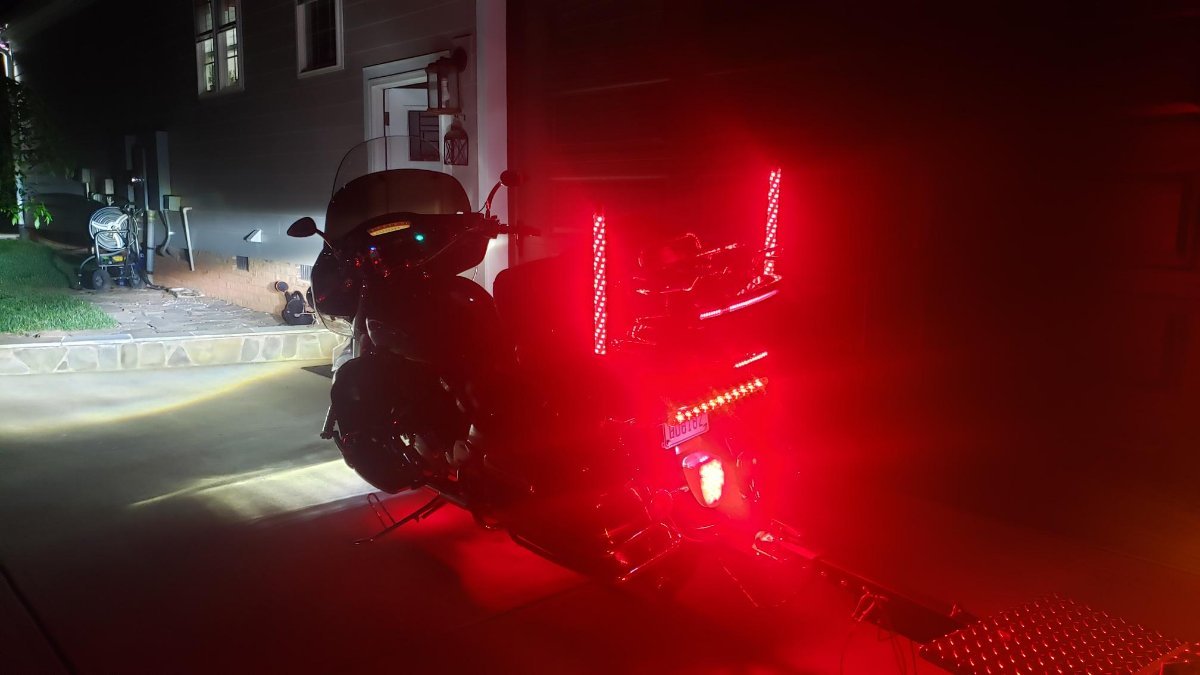

2012 RSV. I definitely get seen when night riding, even wired my undercarriage lighting to go all red when I hit the brakes!
