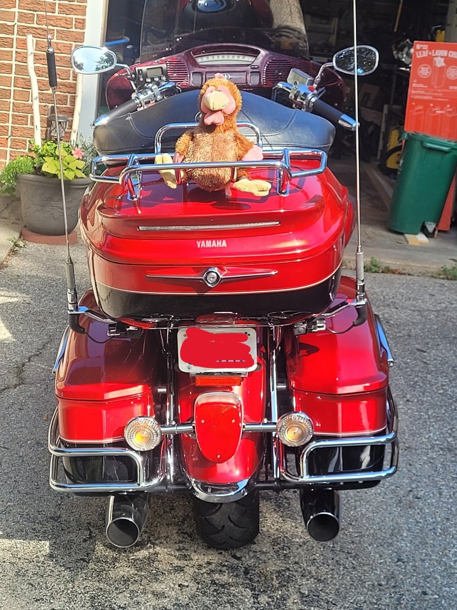

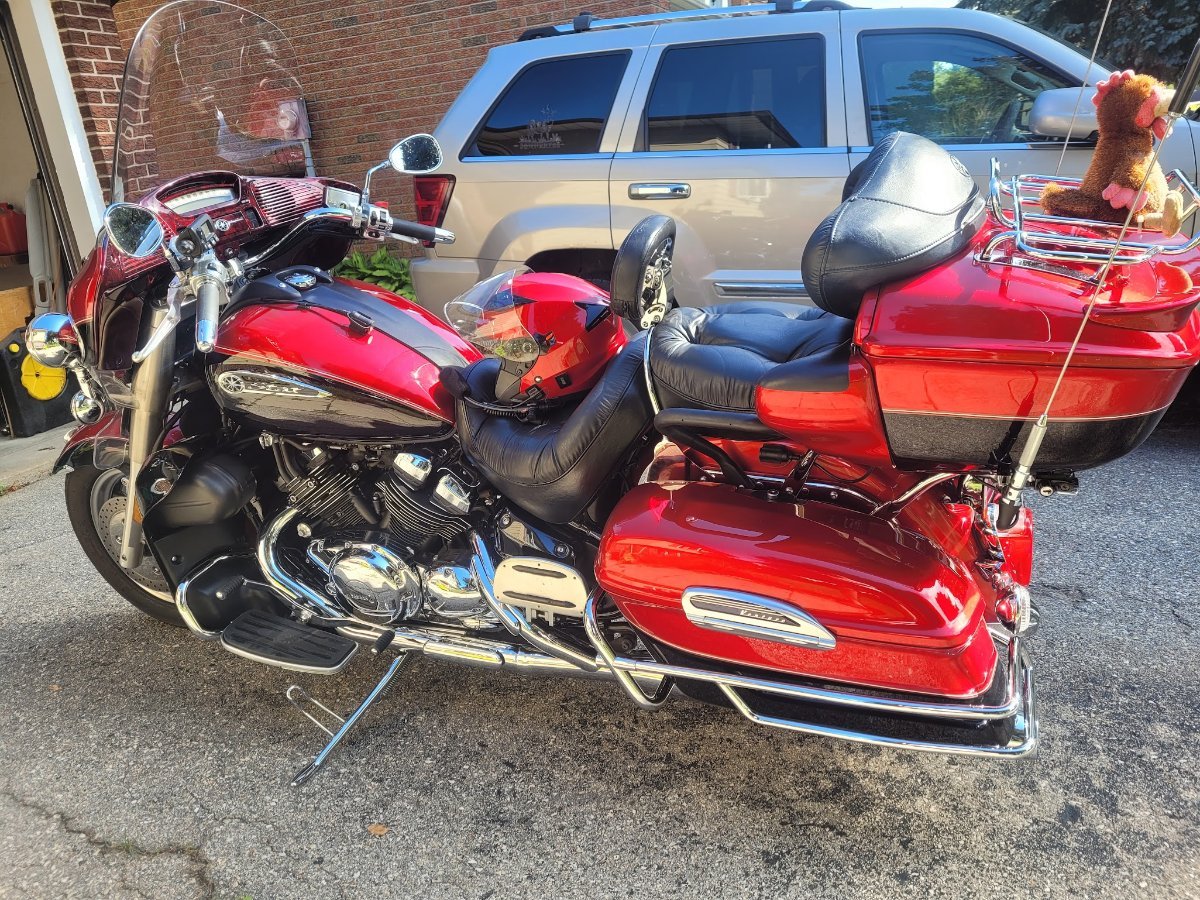

Selling my beautiful 2009 RSV. Low mileage, lots of extras. Garmin Zumo GPS, highway pegs, aftermarket seat, backrest, trunk spoiler with light, second aftermarket brake below the truck, chrome crash protection bars for the bags, LED headlight bulb included but no yet installed. New battery this year. Asking $9,000.00 Canadian safetied. Would be interested in a trade for an 1800 Goldwing.
