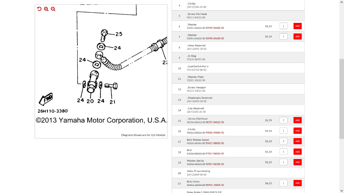

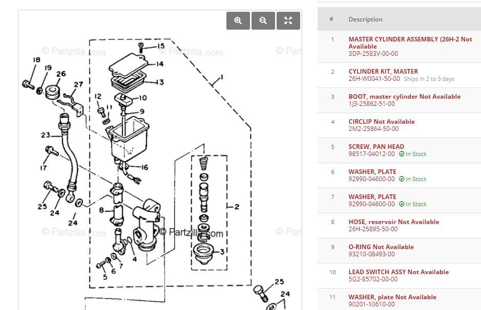

Squidley Posted August 5, 2021 Share #4 Posted August 5, 2021 Paul, It can be cleaned, the master cylinder is at the bottom of the page you have posted. It's where the #2 assembly, a seal rebuild kit goes into. The #4 oring that goes on to the unnumbered elbow is where you want to look at. You'll see a tiny hole inside the body of the master cylinder and that's your return orifice hole. I usually clean them with a single wire on a wire brush. I would suggest that you purchase the seal kit, #2 in the picture and rebuild it while you have it apart. If you have any questions my number is (936) 232-9299. 2 Link to comment Share on other sites More sharing options...
saddlebum Posted August 5, 2021 Share #5 Posted August 5, 2021 (edited) I agree with Squidly =, If your pulling it apart you may as well get the rebuild kit #2 but before you do make sure the master cylinder bore is free of any imperfections, even the slightest imperfection can compromise the brake system. Also check the proportioning valve which attaches to the rear master and divides the brake fluid between the rear and left front caliper. They are notorious for building up crud inside and cleaning up the master as per Squids instructions could be a wasted effort if you do not address this part as well because that crud will just plug the orifice again.That's Item 20 in the picture it is the piece the two brake lines attach to and is mounted on the master. Edited August 5, 2021 by saddlebum 2 Link to comment Share on other sites More sharing options...

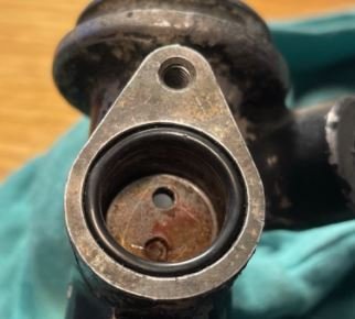

SpencerPJ Posted August 5, 2021 Author Share #7 Posted August 5, 2021 Got disassembled, things pretty dirty. I did not find a ‘culprit’, rather how was this even working this long. I just ordered a #2 rebuild kit from a local shop, 3-4 days and no shipping, partly because when I took the snap ring clip off master cylinder, like a rocket sailed into oblivion into the yard, lol. There were little black rubber marbles inside the bore, so I'm not upset, and rebuild kit comes with new clip. Bore cleaned up nice so feel good about it. I feel like I’ve got the mess cleaned up, I feel I should give the rear caliber a good cleaning considering the junk I found in the reservoir. While it’s apart, anything else I should throw money at? Link to comment Share on other sites More sharing options...

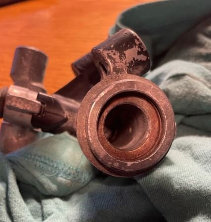

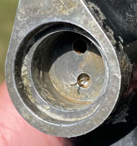

Squidley Posted August 6, 2021 Share #8 Posted August 6, 2021 The 2nd pic is your culprit, that tiny hole encrusted with crap is the return orifice. Clean all that really good and you'll be in good shape. 2 Link to comment Share on other sites More sharing options...

Marcarl Posted August 6, 2021 Share #10 Posted August 6, 2021 46 minutes ago, Squidley said: The 2nd pic is your culprit, that tiny hole encrusted with crap is the return orifice. Clean all that really good and you'll be in good shape. Hey!! I was going to say that! 1 Link to comment Share on other sites More sharing options...
SpencerPJ Posted August 6, 2021 Author Share #11 Posted August 6, 2021 10 hours ago, Squidley said: The 2nd pic is your culprit, that tiny hole encrusted with crap is the return orifice. Clean all that really good and you'll be in good shape. I thought that as well. I took the elbow off while on bike, saw that, was certain I was just going to need to take apart and clean. Then the stupid snap ring clip loss made me need to order the rebuild kit. Anyways, look at the two pics. That hole we all think is plugged, well it does not go through to the inside of the bore. Only the obvious one goes through. Maybe this is the design of an 83? Link to comment Share on other sites More sharing options...
Marcarl Posted August 6, 2021 Share #12 Posted August 6, 2021 There be a hole there,,, keep cleaning!! It's not near clean enough yet. 2 1 Link to comment Share on other sites More sharing options...
SpencerPJ Posted August 6, 2021 Author Share #13 Posted August 6, 2021 Thanks for the persistence Marcarl So the hole will not even allow me to push a stick pin through it, only a couple fine wires. Does that seem correct? Also, any ideas on what will get some of the gunk off, I hate to sand and brake cleaner not effective enough. I did sand bore slightly with 1500 wet/dry sandpaper, wrapped around a dowel rod. Thanks Link to comment Share on other sites More sharing options...

Pasta Burner Posted August 6, 2021 Share #15 Posted August 6, 2021 That’s the hole, it’s not as large as the area that is bored out. I want to say it’s the size of a high E guitar string. This thread may help you. It helped me a while back, 1 Link to comment Share on other sites More sharing options...
SpencerPJ Posted August 6, 2021 Author Share #16 Posted August 6, 2021 @Pasta Burner Thanks for that link and confirmation. 1 Link to comment Share on other sites More sharing options...
Squidley Posted August 6, 2021 Share #17 Posted August 6, 2021 That's all the big that return orifice hole is, very tiny, but makes big problems when it's clogged. 2 Link to comment Share on other sites More sharing options...

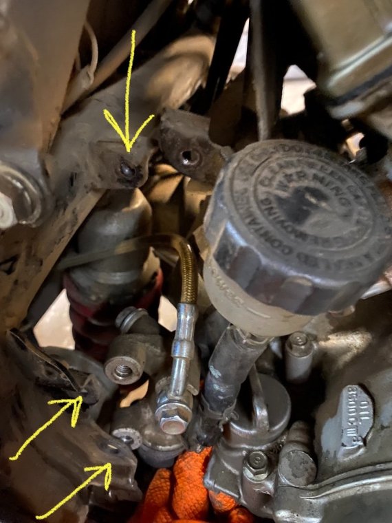

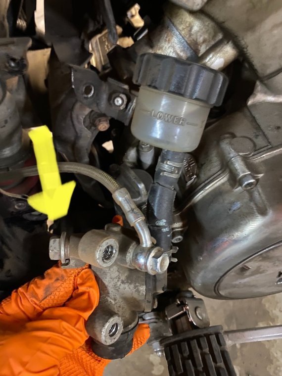

videoarizona Posted January 31 Share #24 Posted January 31 On 1/9/2022 at 3:15 PM, MoonShine said: Great job on the repair and all the info! I did the same repair with the help of the good folks on this forum. I later switched to a 2000’s Royal Star Venture MC and reservoir for convenience. It pretty much bolted right in without too much trouble… Well, Moonshine...that is pretty neat! Thanks! Question....you said it bolted in without to much trouble. Care to elaborate? I'm fighting a new to me issue with my rear master cylinder...and if I'm going to go in and rip it apart, I might as well add your modification as well... Thanks, david Link to comment Share on other sites More sharing options...
MoonShine Posted February 4 Share #25 Posted February 4 Ok. I have been going through my records and cannot find the make model of what bike this part came off of…. I’ve attached a few pictures after unbolting that might help. There are 2 bolts mounting the MC and 1 for the reservoir. There is also another outlet that I capped off as my front and rear brakes are separated now. By bolting up fairly easily, I mean that the brackets on the frame lined up pretty well with the new set up. I may have had to drill a hole? I believe I only had to adjust the slack after bolting in. Apologies for any confusion. I will keep researching to find the bike model and year for you. Link to comment Share on other sites More sharing options...
