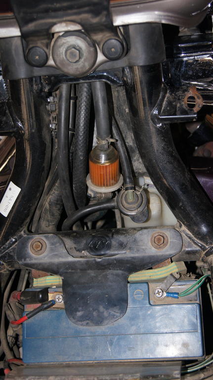

  8. i took one look at where the fuel filter was and decided to move it with a bit of extra fuel hose it fits nicely under the seat easy to see and replace

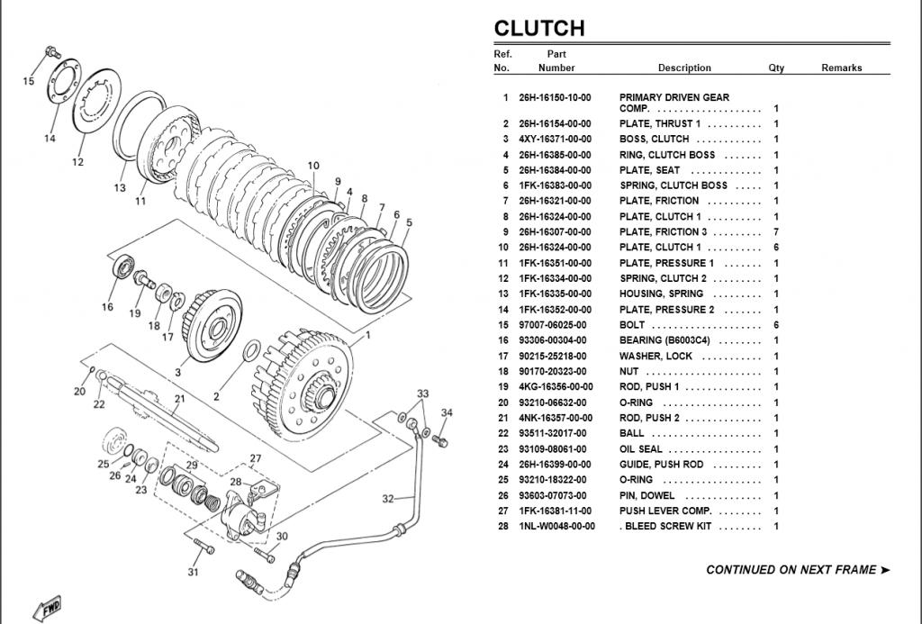

  23. a short while ago a discussion on the back pressure hole in the master cylinder by any chance could this be your problem [just thinking out loud ] of anything that can go wrong with the clutch . i had this happen on my bike and thought the clutch was slipping was a small piece of what looked like a grain of sand i got it out with a small bit of wire and all is good now. http://www.venturerider.org/forum/showthread.php?117486-Crazy-scary
  24. just a thought when you dismantled the clutch did you take the pushrod out if you did you may have left the small ball out [they have a habit of rolling away if you don't keep an eye on them] this would let the slave go fully out and get hard. part #22
