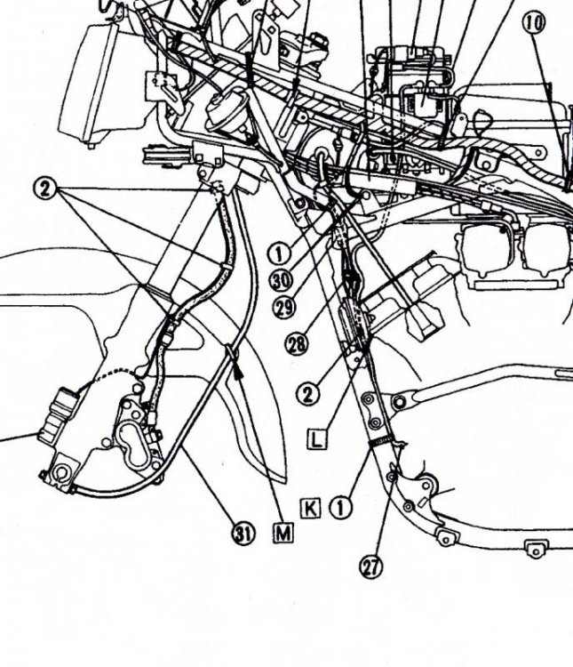

  8. I believe the ground point you are seeking is Key#30 on attached diagram. Here is a pic of the "earth" or ground point. Access is going to be very difficult, if not impossible, with the fairing, radio, inner fairing in place.
